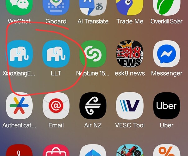

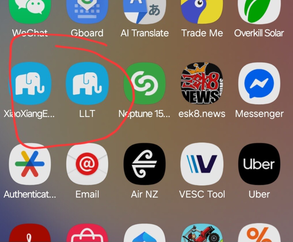

not 100% sure the relationship between JBD and LLT but I’m pretty sure now all these BMS come from JBD so i updated the title.
Not sure for certain what the relationship is there, but JBD is the manufacturer, LLT is a reseller.
I think that when those bms first became prevalent in our scene, most people were buying from LLT and hence why we associate the JBD bms with LLT.
Can’t beat the prices buying direct from JBD on aliexpress tho… unless probably on taobao

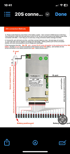

I’ve got a JBD bms with 22 wires I’m connecting it to a 20s battery. I connected 20 wires going from black. What do I do with the last wire which is red?
A-damW
December 16, 2025, 2:48am
53
My bad response, I mis-read.
Mathematically, you missed a connection.
Black would go to negative pole.
Red to positive pole.
White on all groups in-between.
Make sure black actually goes to negative marked on the BMS.
@hummieee
I mis-read your specs.
Sorry for not reading closer.
Does your model number start with APxx or SPxx?
If you can get the model #, I can help you find the right diagram.
They are different per model. thus @A-damW ’s questions.
Iv’e seen ones where the last wires just get ganged together.
and others where intermediate pins are expected to be ganged together.

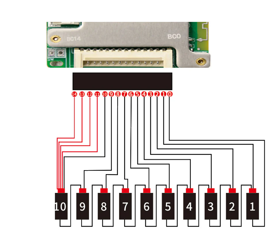

sorry I changed what I’d written above and had made a mistake in my description and there’s another wire. I found a good diagram
I intend to use the little JBD 14S BMS for a 10S pack.
What is the practical way to jumper the 9th p group
I do it exactly as it’s drawn on the diagram, join them all together just after they exit the bms and then just continue one length out to the battery
A-damW
March 3, 2026, 4:26am
59

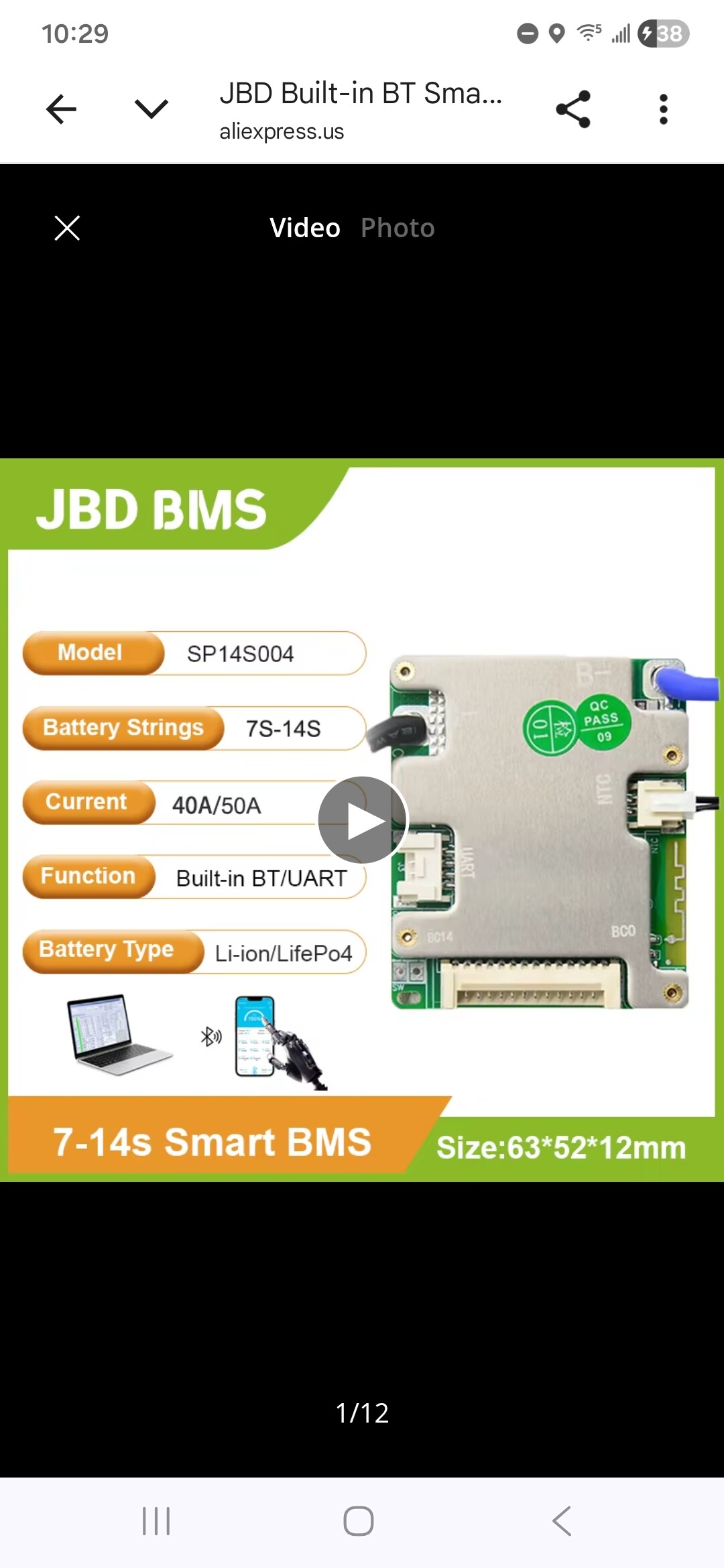

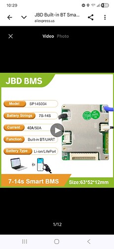

Are you using the SP14S004?
Different cell count bms’s use different analog front ends, with different termination schemes.
If you are using the SP14S004, here is the correct termination for 10s use:
Source:
JBD-SP14S004 is a software protection board solution specifically designed for 7-14 series lithium battery packs. SP14S004 supports automatic identify 7s-14s LFP NMC battery pack, and with 20A-50A continuous current for choose. BTW, it has build-in...
I have to double check the model. All I know is it is tiny…
Looks like it.
Thanks for the save @A-damW

To illustrate, here is 10s for the SP17S005 (SP14S004’s slightly bigger 17s brother)
Quite a bit different.

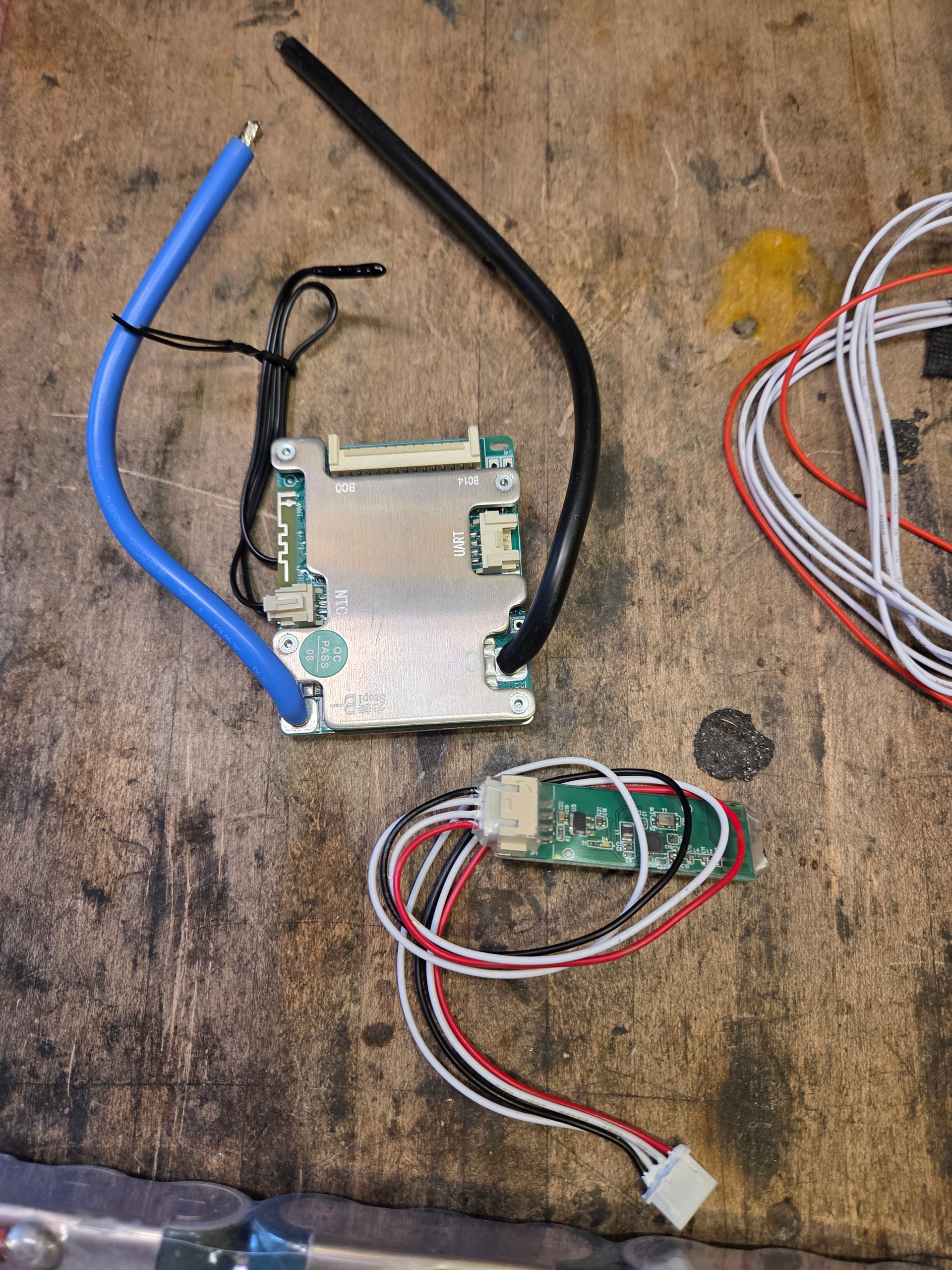

So these little guys don’t need the external Bluetooth dongle?
