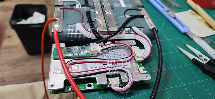

While we’re on that topic, could anyone help diagnose a weird issue with a LLT 10s BMS i’m hooking up?
I got a first one, and wired everything up properly, connects to the app, showing the correct voltage of 35v for a 10s pack, but when measuring on the charge port, there is little to no voltage, whereas normally it will also show 35v for other BMSs like a Daly.
I thought this could have been a faulty BMS so i bought a new one, hooked it up again and same thing. I have yet to plug it into a charger to charge because well, it seems sus.
nope.
is the charging turned off for any reason by chance? the app should show this.
Maybe the charge port has a diode so you can’t measure the voltage because of that, if it charges normally I wouldn’t worry.
I’m able to pull current out through the charge port. (it shows up as discharge in the app) so I don’t think there’s a diode. and think P- and C- are connected on the board.
Charging is turned on, yea
