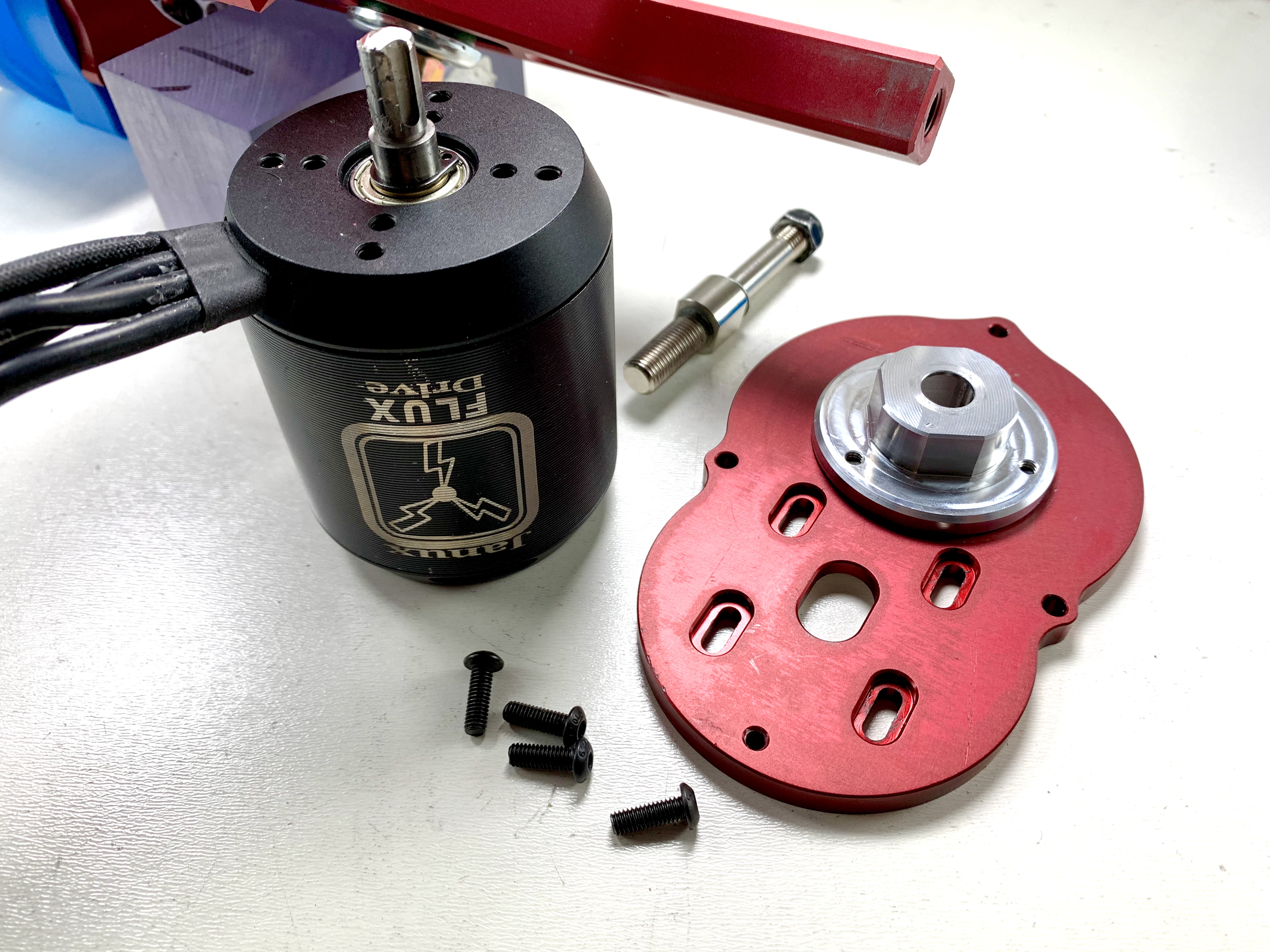

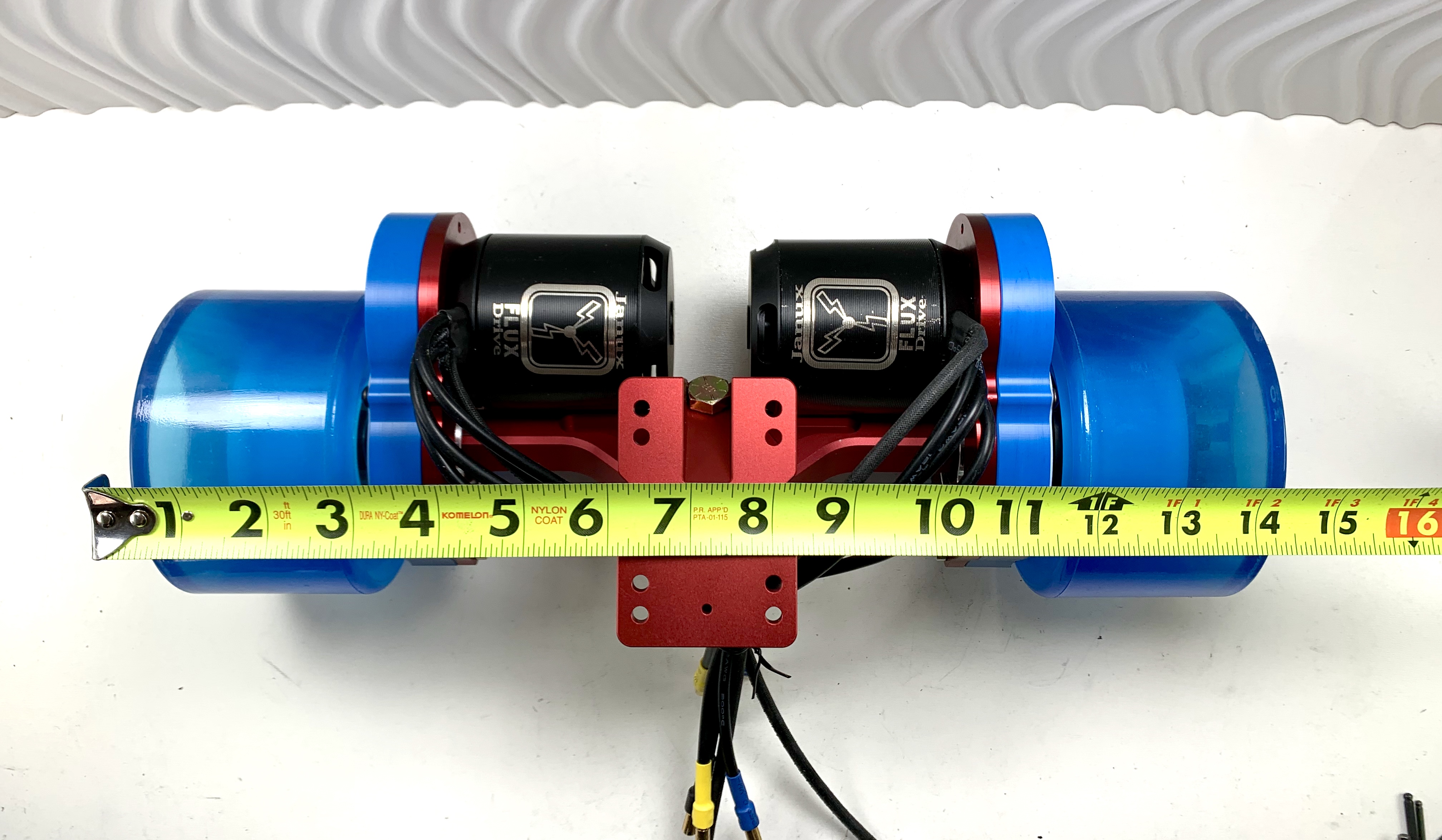

Finally…, gear drive on TB cnc trucks :point_down:
Specs:
  • TB cnc precision trucks
  • Dual 6374 motors
  • Possible 20 gear ratios, motor gear (15, 16, 17, and 18t), wheel gear (42, 43, 44, 45, 46t)
  • Anodized T6 aluminum motor plate
  • Acetal Delrin (POM) housing
  • Kit price, $345 (trucks, wheels, and motors not included)
Installation how-to:
Remove the truck’s axle from the hanger
Locate truck adapter and motor plate
Determine best angle for your mount then affix motor plate to adapter with loctite
Remove motor plate/adapter, loosely install your motors
Slip the assembly back onto the hanger
Re-install the truck’s axle with loctite

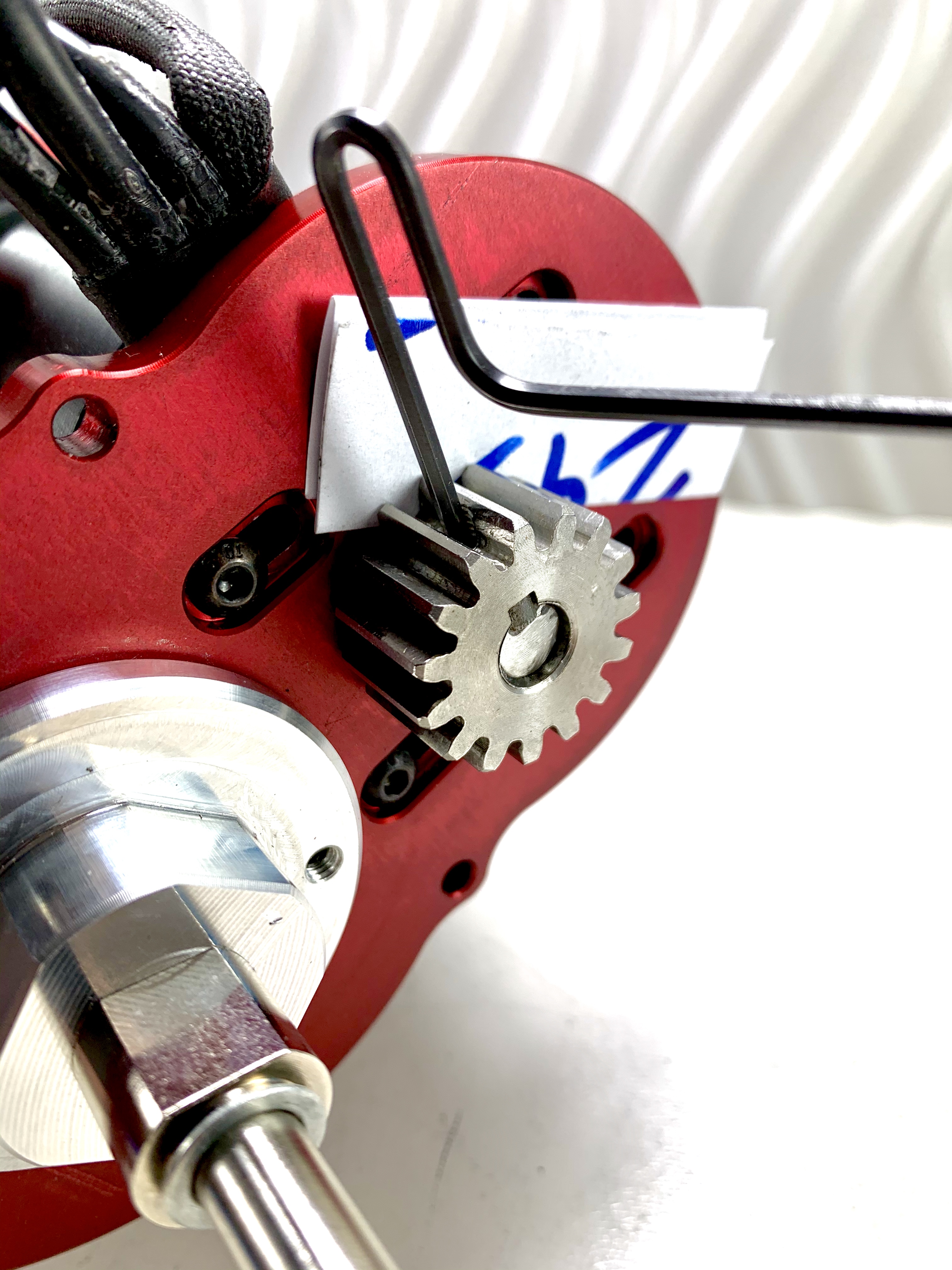

Locate motor pulley and 3mm key
Prepare a shim, about 0.5 to 1mm thick
Place shim between the motor plate and motor pulley, don’t forget to insert 3mm key
Torque down the setscrew with loctite
Locate wheel spur gear, bolt on plate, and 608 alignment bearing
Slip bolt on plate to hub
Loosely install gear to wheel
Insert the temporary 608 bearing into the gear
Slip the assembly onto the axle
Lock down the axle nut and 5 bolts. This step is done to axially align the wheel gear to the axle.
Remove the wheel/gear assembly and the temporary 608 bearing from the gear
Locate and install the 688 bearing onto the axle
Re-install the wheel/gear assembly onto the axle

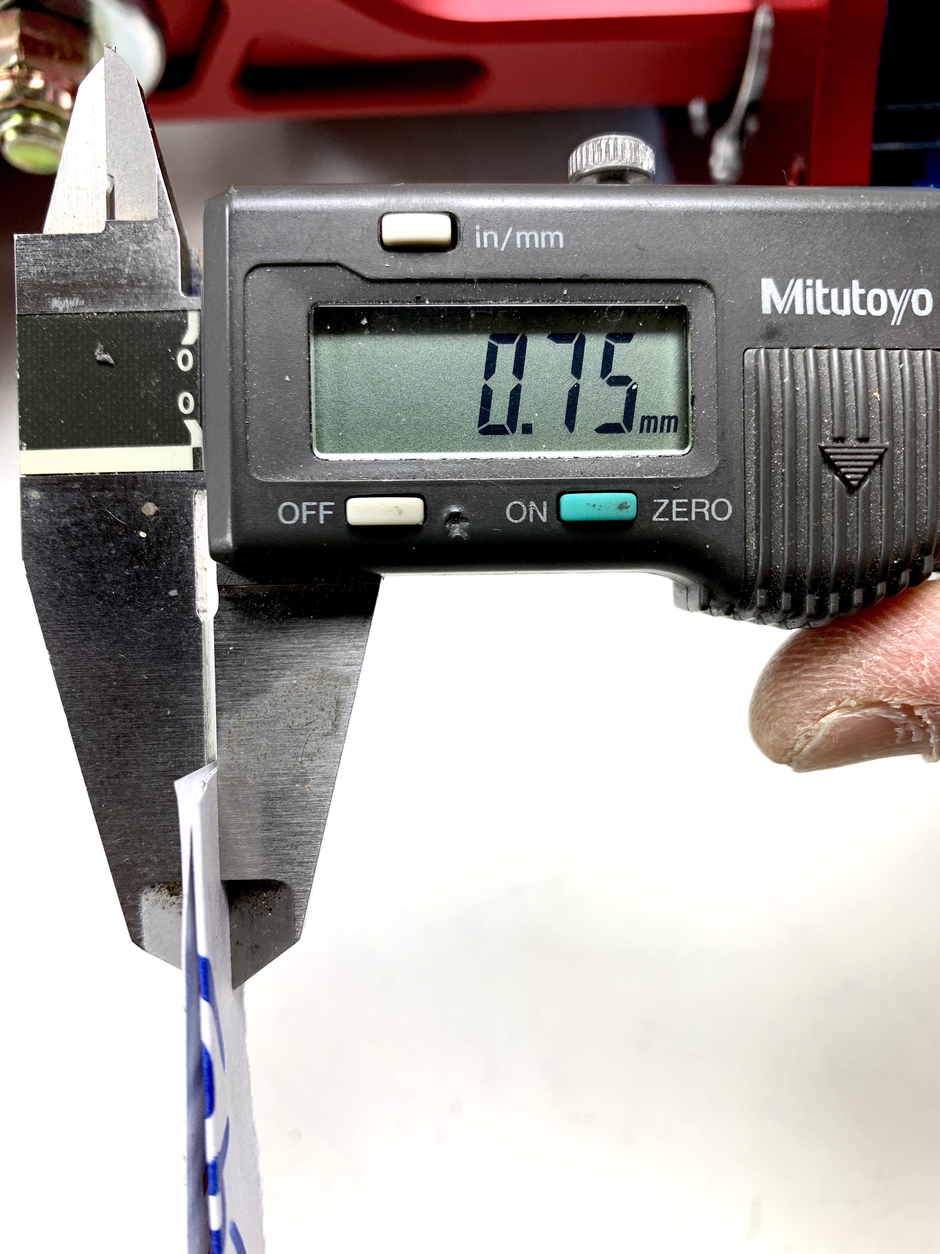

Adjusting the gear backlash by inserting a 1 ply piece of paper, squeezing the wheel and motor spur together
While squeezing the 2 gears, loctite and torque down the outer bolts
Remove the wheel/gear assembly, loctite and torque down the inner motor bolts
