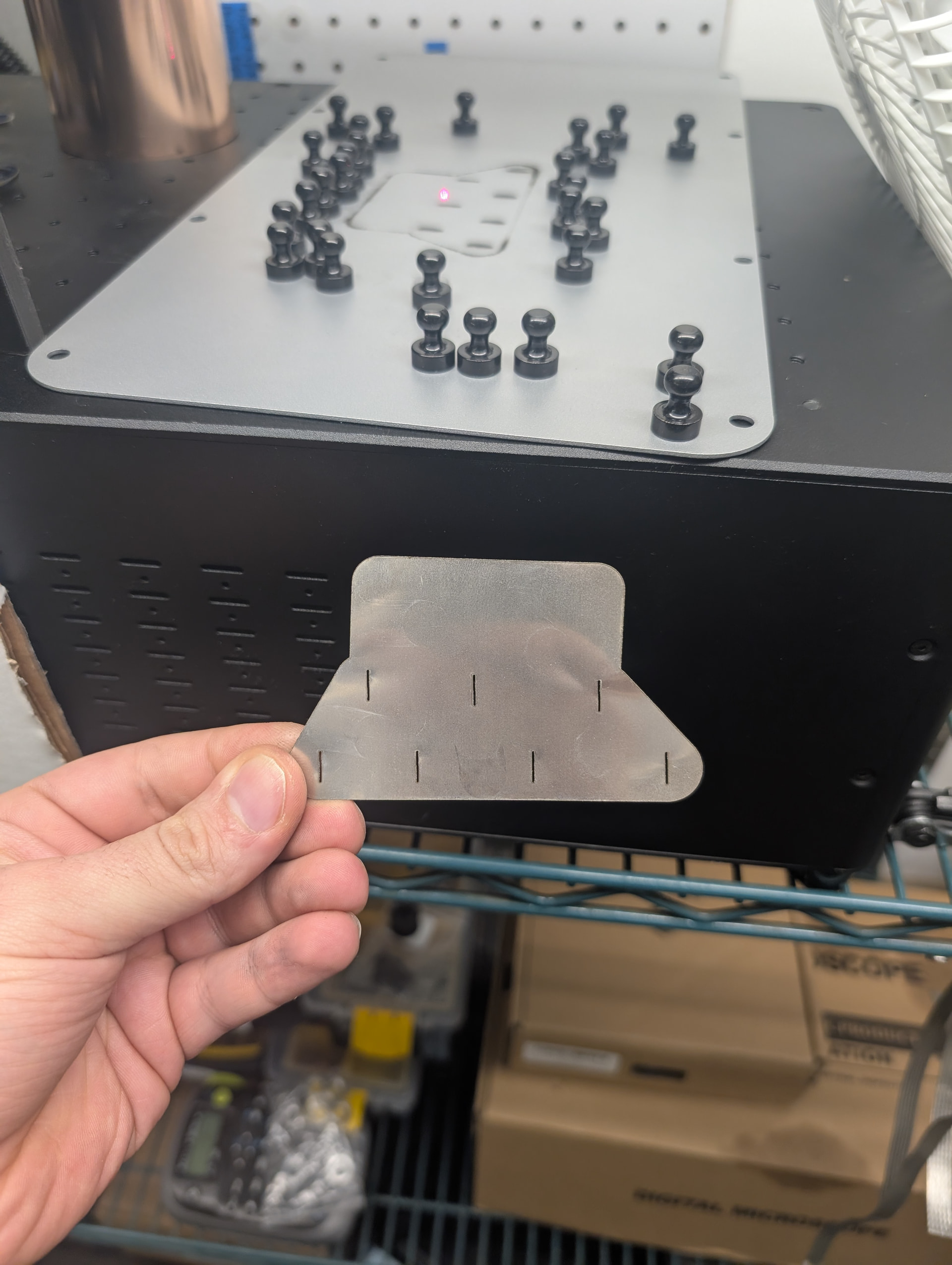

I’ve gotten my fiber laser setup properly to cut up to 0.2mm nickel and 0.15mm thick copper. I’m super new to this so my pricing will begin lower and individually negotiated for now.
Do not expect me to beat/match/come close to the prices from places like mboards. Expect me to make small quantities of custom precision cut conductors in shapes you cannot buy off the shelf.

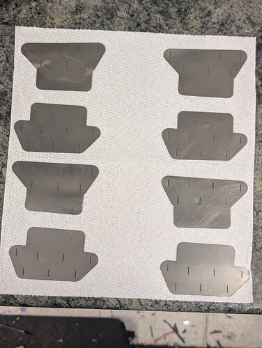

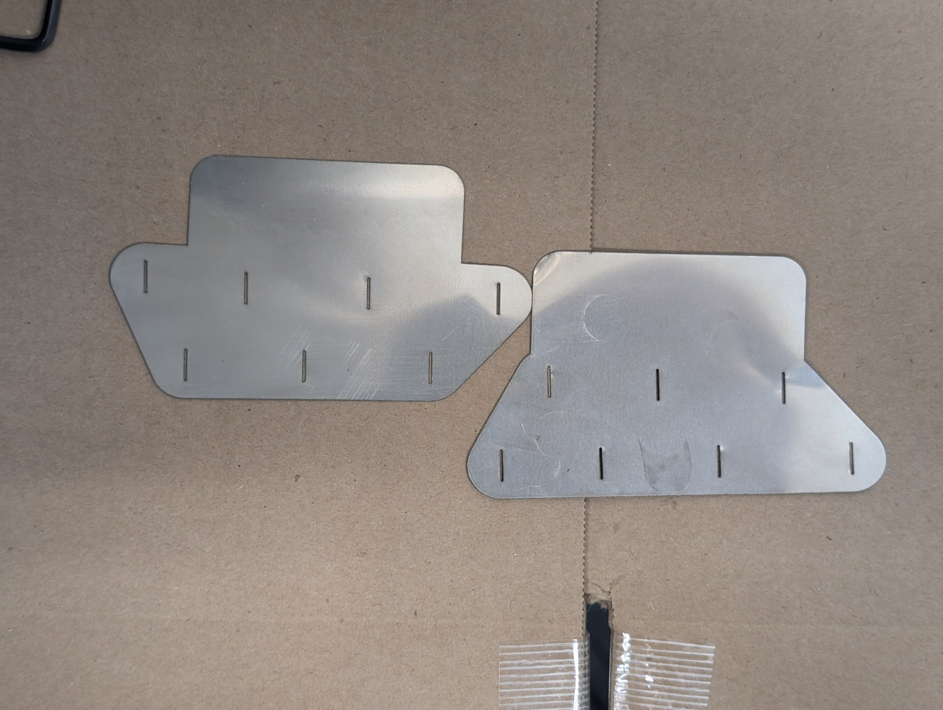

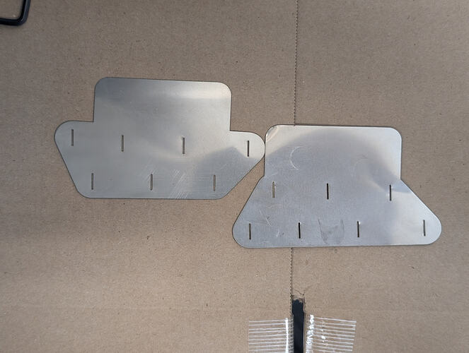

Just so folks understand what they’re looking at… these 7p tabs are intentionally asymmetrical. They’re designed for a specific application: a curved spread-staggered arrangement – to minimize pack height inside a Lacroix Barrel enclosure. Matching the deck concave and using every bit of enclosure width. That’s the reason the cell arrangement and nickel shapes look warped or skewed.

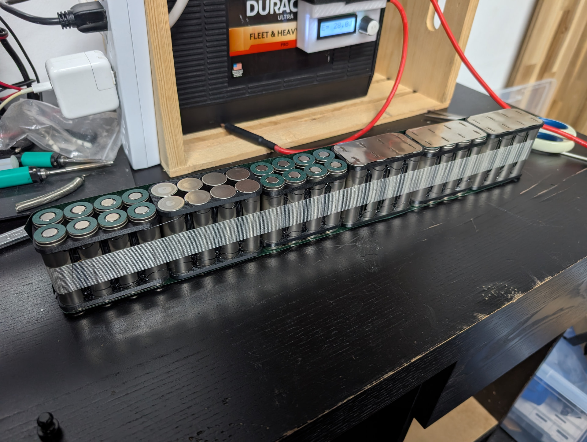

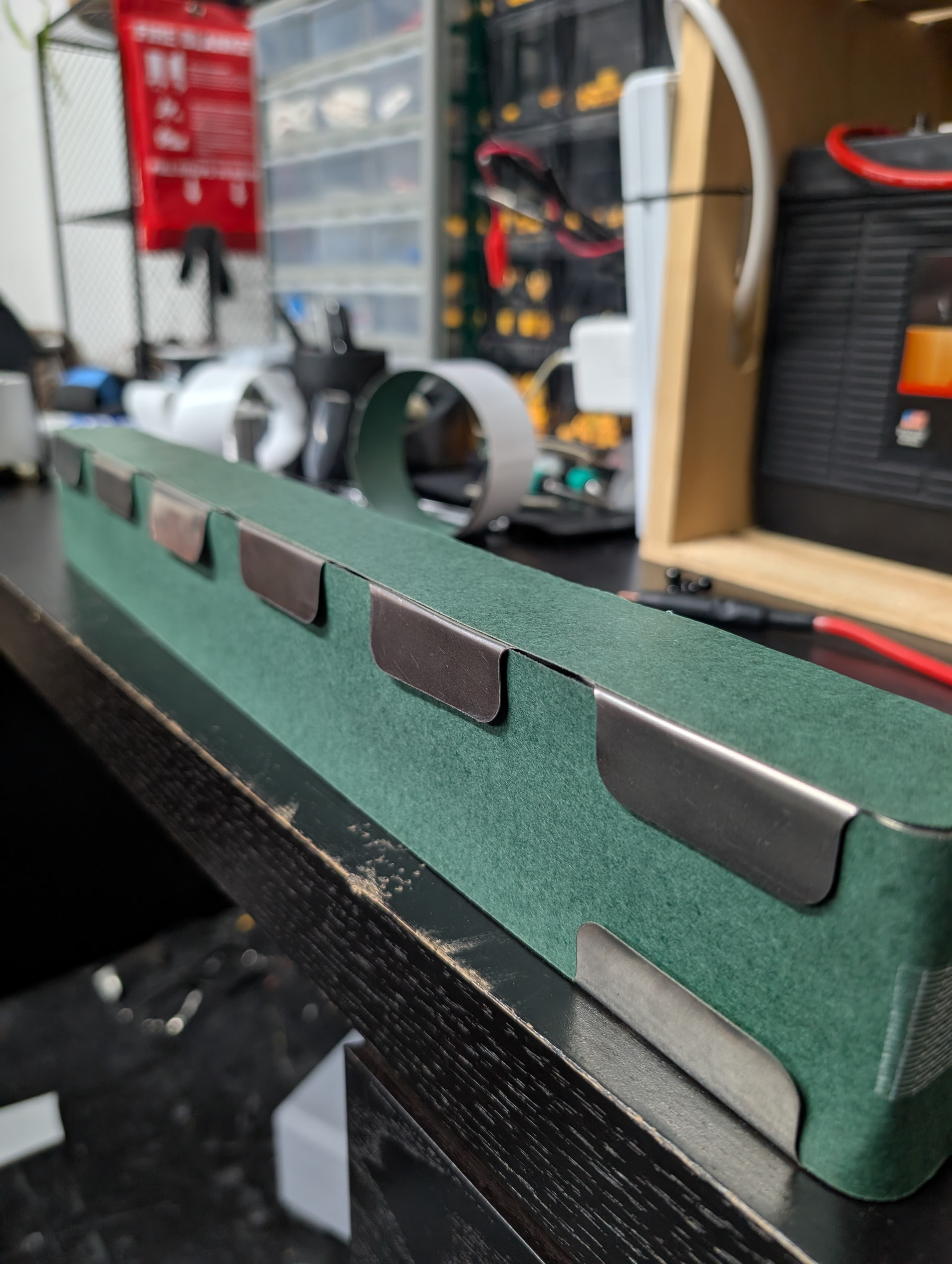

So excited for these! These laser-cut pieces will be soooo much cleaner and more accurate than the hand-cut hack job I was headed toward!! Pack-building procrastination worked to my benefit this time.
Hey @nclayton yours are shipped!
