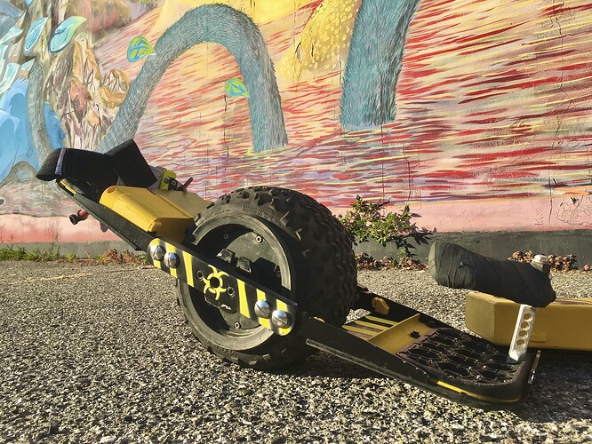

For this build I wanted to stick with the XR axle because many of the motors and motor accessories I want to use are based on the XR. I have my eye on the new Kiil Guard suspension system in particular.
I went with an 8 degree angle for the front and rear rails. I think this is a bit more angle than the TFL steep and deep rails. The footpads add another 3-4 degrees. I would say 8 degrees is probably the highest you want to go.
Board length is 28.5" from end of footpad to end of footpad. This is a bit shorter than my original WTF growler rails. The rear rail and footpad is 1/2" shorter than the front rail to accommodate my ride stance. The tire gap is 11" from bumper to bumper.
This board feels extremely stiff due to the simplified design. The stack of items bolted together is only the bumper rail and foot plate, making it very secure. The bends in the foot plates add to the rigidity. The stiffness feels extremely responsive but also bumps in the terrain are more readily transmitted to the rider. I had to reduce high current haptic buzz (foc play tone) from 10V, 180Hz to 5V because it was shaking me out of my shoes. I also had to implement some new code to handle feedback vibration that occurred because of the tighter coupling between the IMU and the motor.
The board weight and balance feels great, like I expected. Doing 180’s feels really balanced and agile. Less board weight in the air is noticeable. Tail clearance for drops is amazing.
There is minimal space on the front footpad due to the width of the controller. Right now it feels like there is just enough room, but my foot is 100% locked in like a snowboard. The front foot binding release interferes a bit with the control enclosure and just barely fits in the space created by the arch of my foot. Future improvements would focus on improving this layout.
I need to improve the heat sink because it is hitting high temp a little too easily. My old board had the foot plate in contact with the heat sink so it had more mass. In this case I will probably just increase the thickness of the heat sink from .09 to .18. I could add extruded fins to it but I think that is overkill. I have also found that since the heat sink is exposed I can smear a bit of water on it from my water bottle and it cools down like 10 degrees per minute. I bit of a gambit but I trust my enclosure design to keep water out.

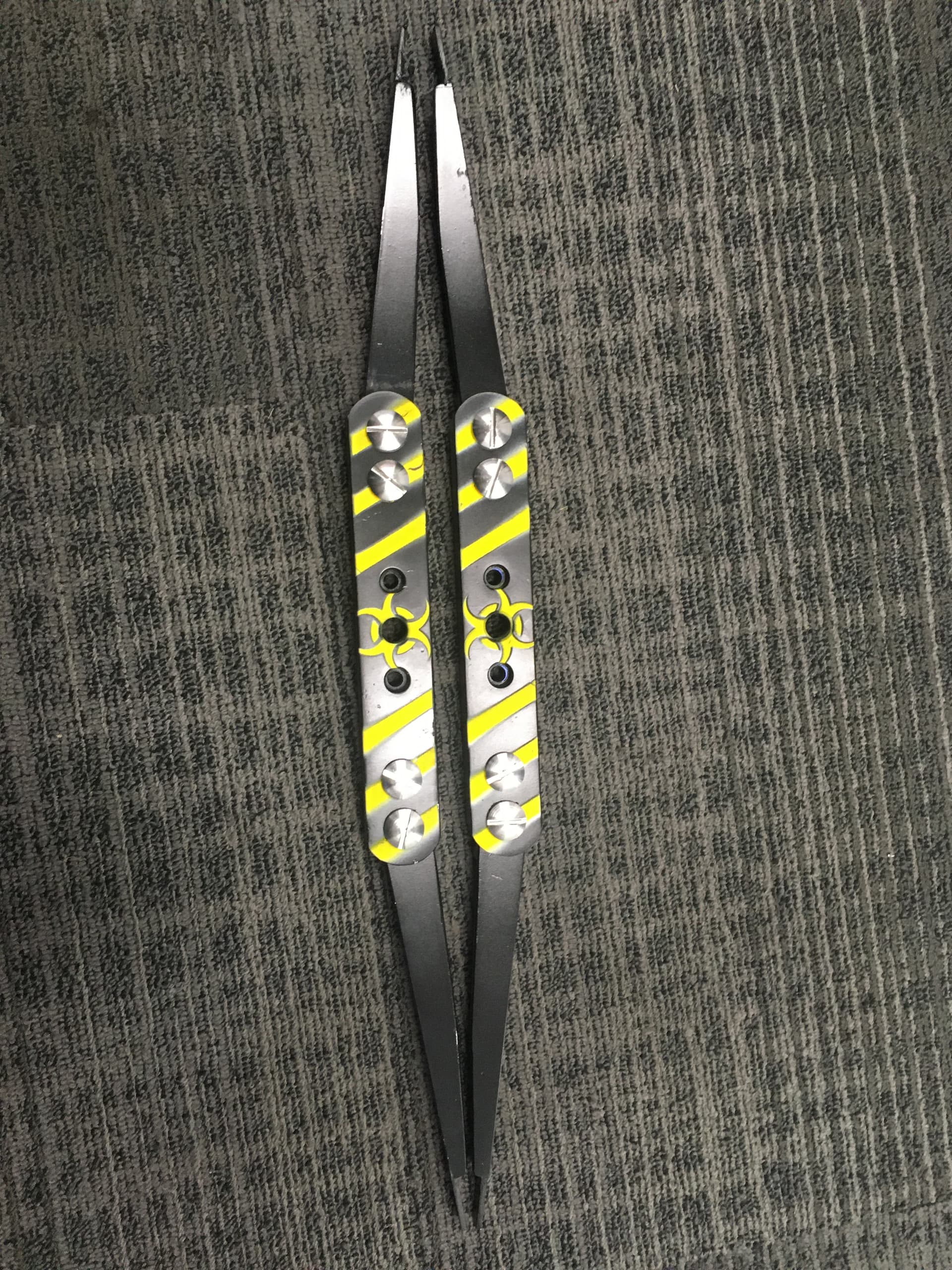

My first set of rails failed because of a design oversight.
It was a pretty classic tensile stress failure
First failed rails
To solve this I added more material to the area that failed.

I used 3D printed templates to help make my rails.
