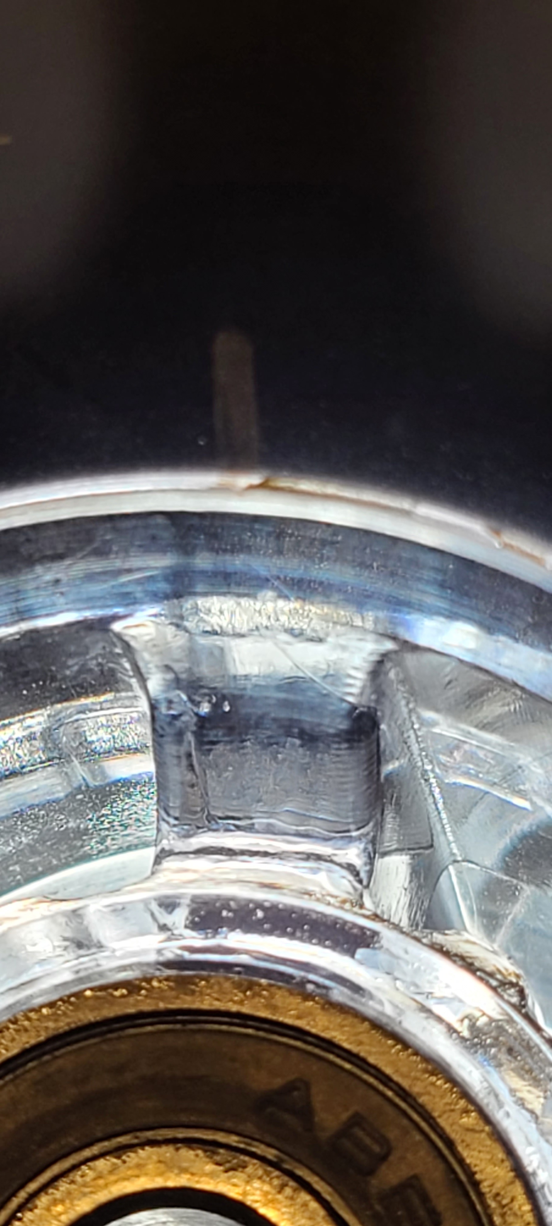

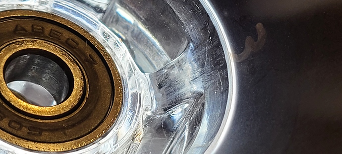

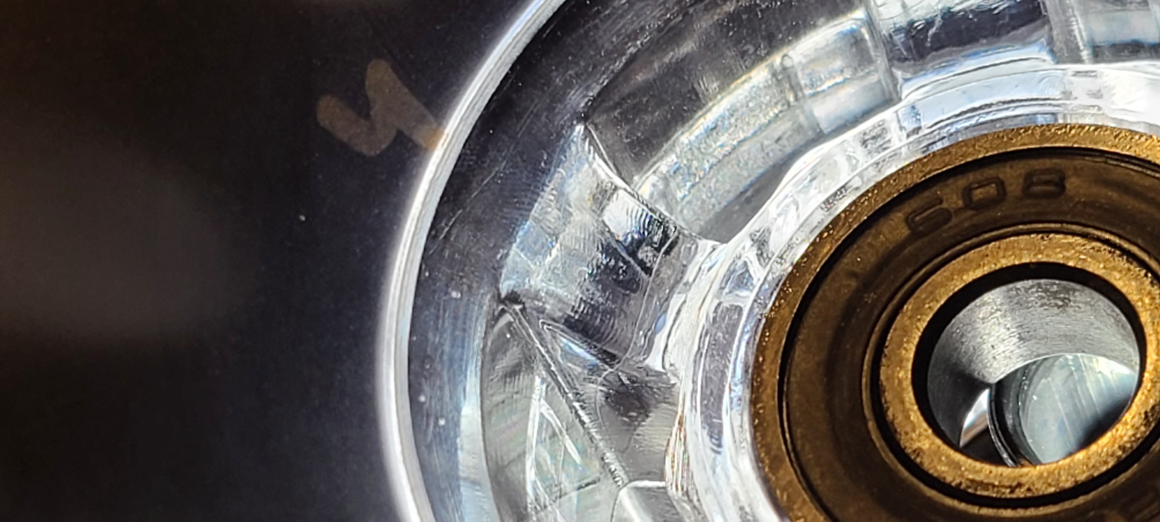

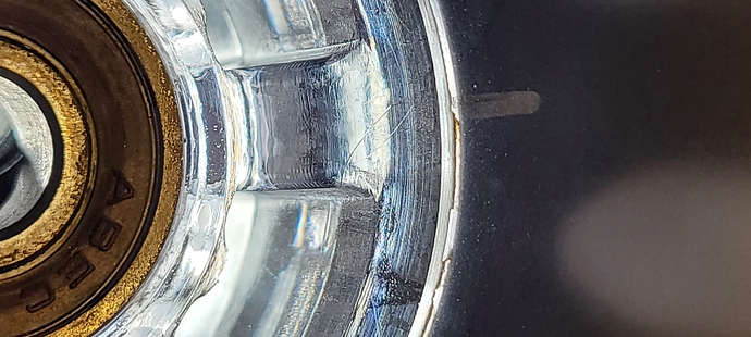

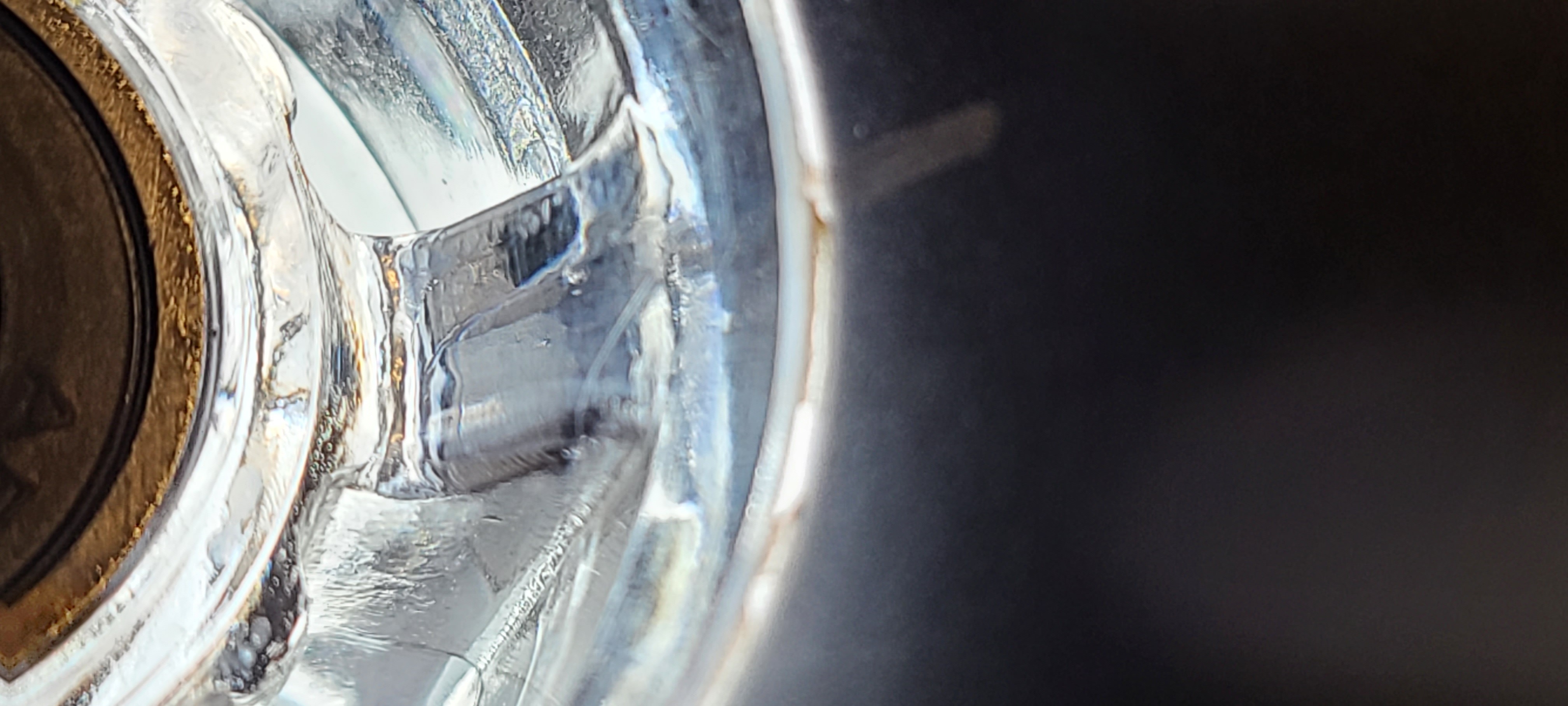

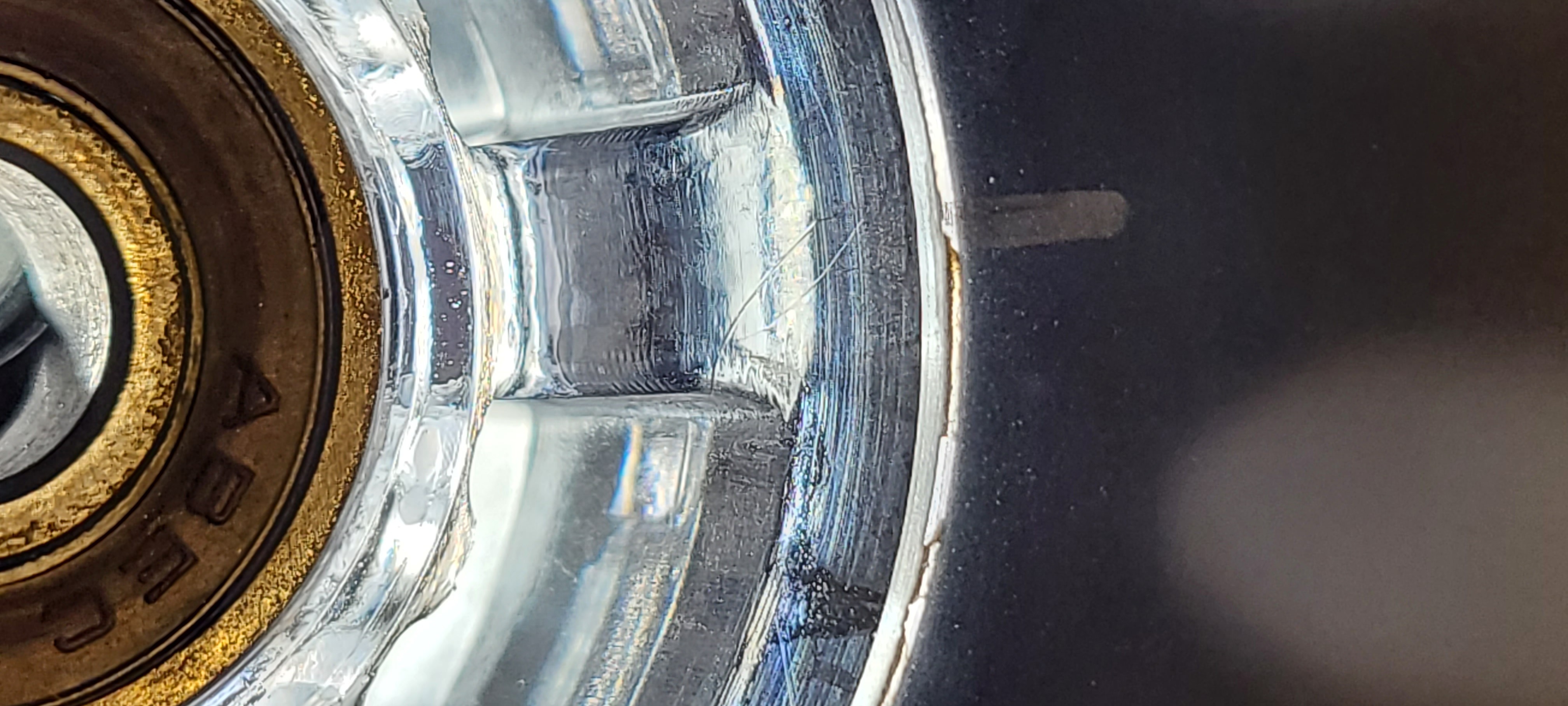

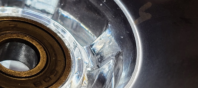

I took the images below of the two front wheels using the zoom on my Samsung S20.
What do you guys think?
Photo set 1-4

Thanks for posting these. I presume those “lines” are artifacts from manufacturing. It’s great to have detailed photos we can reference while the miles stack up
Well… that is my concern. I am not sure if they are artifacts or actual cracks…
are you able to tell from the core image you posted here? iWonder Discovery 120D Cloudwheel discussion
I cannot tell from the image, maybe the size was shrunk when uploading and your original copy have more detail?

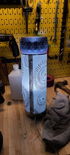

Put a flashlight through the core and it should be obvious… artifacts would only show on the surface, cracks will reflect light from the inside for as deep as the crack goes

You could make some scratches to compare how they look.

Most look like scratches or shallow cuts…

Is there anything like a temporary dye which could help differentiate between a crack starting and just scratches etc? Thinking aloud
Also a strong backlight may help show a fissure as the light bends

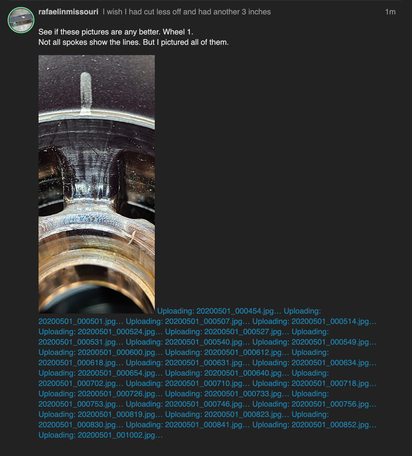

I did another 16 miles today.
There is a sweet trail with a huge switch back I recently discovered that gets me to a neighborhood I never used to hit. Some of the roads are this half ass pave the city does.
The clouds are perfect for it…

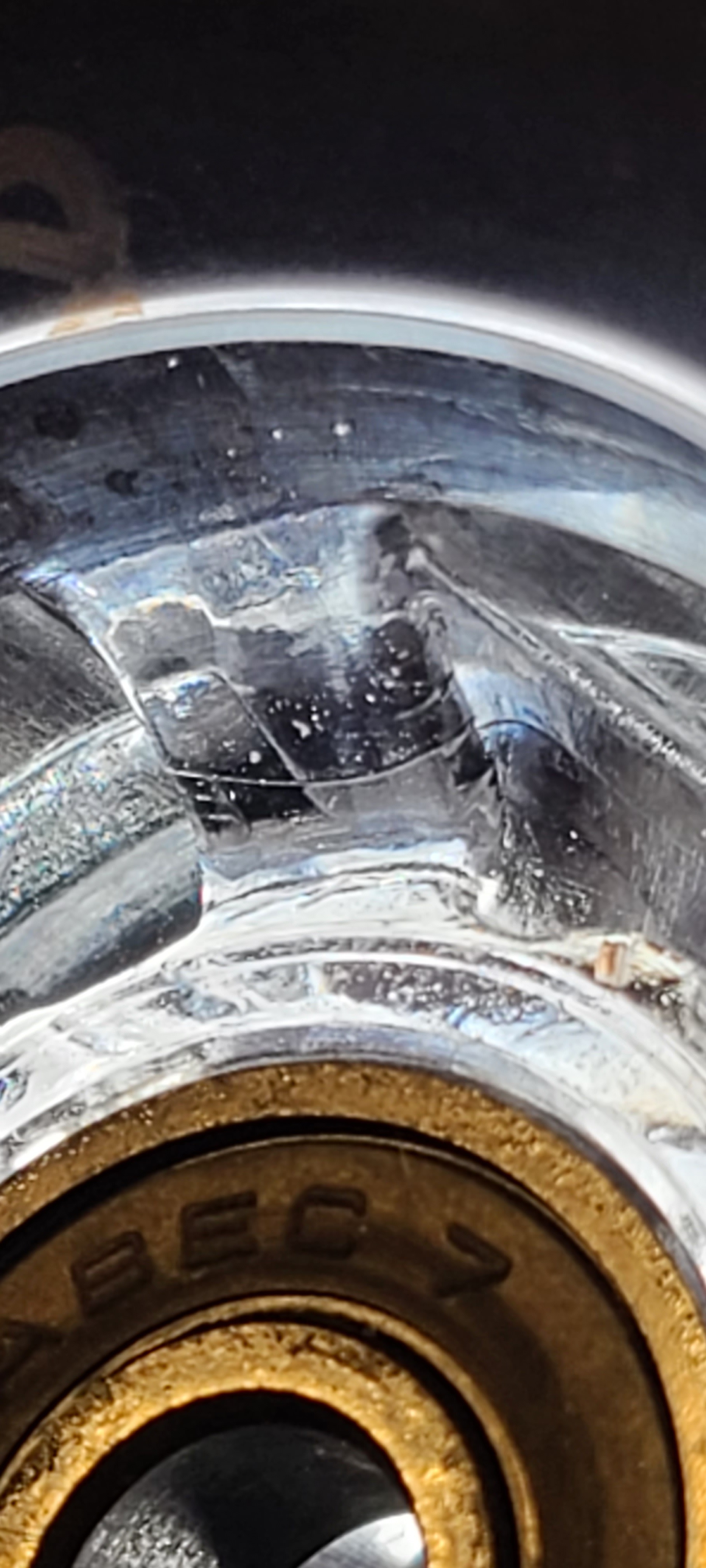

I don’t think I see any new lines or changes from yesterday.
But here are more pics anyways from my “enhanced inspection station”
