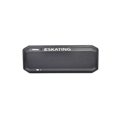

i have no clue if the enclosure is going to fit
as for the measurements i think it wil work without a doubt
but i dont know how its going to be for the concave and flexebilaty of the enclosure

Make sure your enclosure is a fit, that can kill a build if it’s off.

enclosure im thinking about to order
