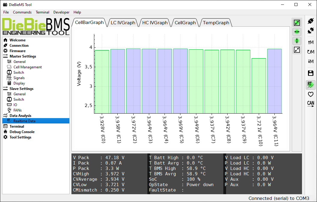

Is my battery ok?

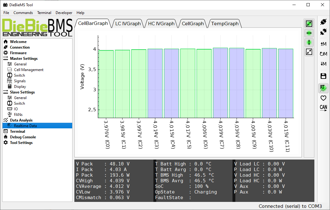

trying it now with the 12S charger with DieBieMS

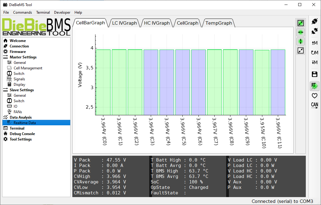

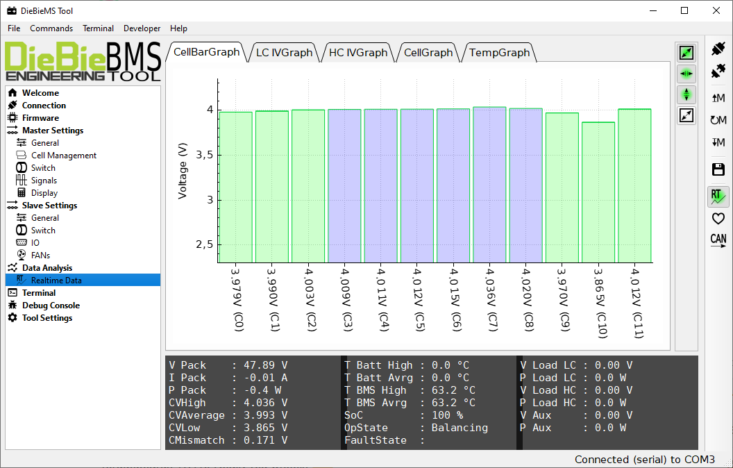

interestingly, when i plugged it in it showed this
replugged and now it’s back to before
How about you ping @JTAG on the other forum? He’s the creator of it and very responsive. @directC
@directC :arrow_up::arrow_up::arrow_up::arrow_up::arrow_up:
(pointed @JTAG here)
So in the second pic (re-plugged), the opstate was “Power Down”
I shut it down and on again and now it’s back like on pic 1

Check your individual group voltages. If they correspond with Diebiems, proceed with charge.

looks good -> like diebiems
‎ Proceed
balancing now
hope it’s good until tomorrow
3.86 is much better. There’s a good chance it could balance out.

Is this a CC/CV charger? I know thats a requirement for DieBieMS. Is your DBMS tool version updated?
looks good so far
will take it on a ride now
