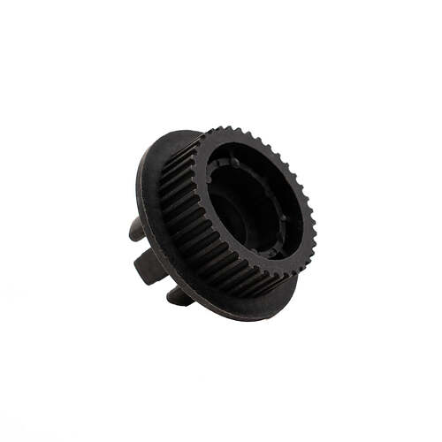

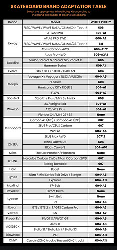

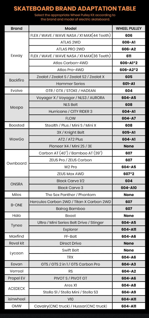

I’d like to go on a similar route, but I’m stuck a bit on choosing the right wheel pulley hardware.
Looking at this truck/motor kit:
RKP Truck Complete Mechanical Kit – Propulsion Boards
And the same wheels you are using:
CLOUDWHEEL ROVERS 110R Urban All Terrain Off Road Electric Skateboard
Question is, are the pulleys that come with the truck kit going to fit the wheels, or I need to select a set of pulleys when ordering the wheels? If it’s the latter, which pulleys do I choose with the wheels to work with this combo?
Thanks!
Thanks man! The wheel pulley they have on the propulsion board kit are kegal pulleys. You’ll need abec pulleys for the cloudwheel rovers. @PropulsionBoards should have abec version. You can email them and ask for the abec pulleys. If not, i got my pulleys from mboards. Here’s the link
Thanks! I emailed them. If they don’t have the compatible abec versions, would one of these options from Cloudwheels work or none of these are compatible with PropulsionBoards trucks/mounts?
I couldnt tell ya man. But i know the mboards ones work
