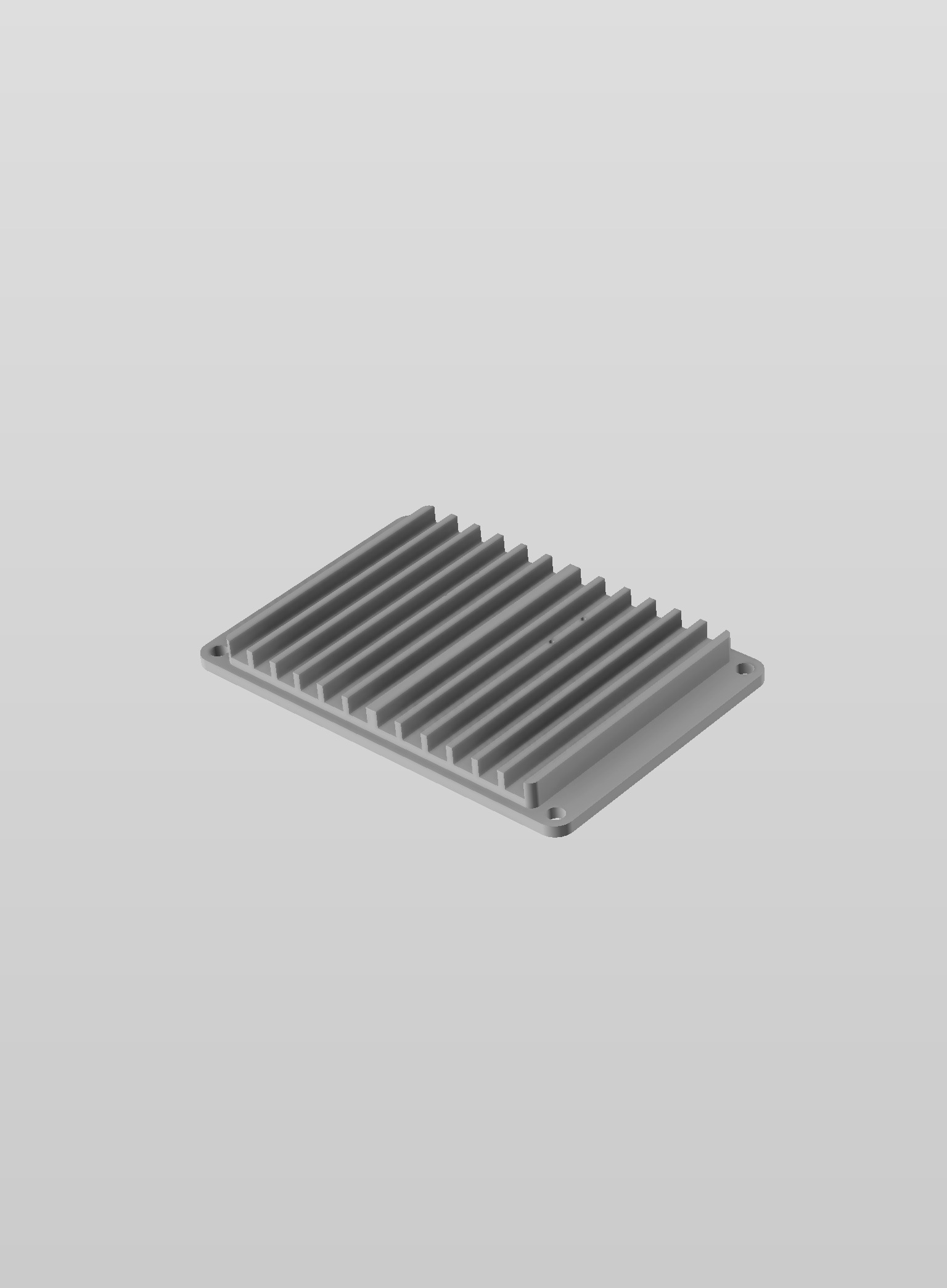

InfinitySink Development Thread - 2020 Community Influenced Universal Heatsink
Yeah I run mine on the side now, but only a small 40x40mm heatsink is exposed, which is better than nothing and It does catch airflow being on the side which is good. I think since I installed the heatsink it runs 3-4 degrees celsius cooler.
Before I ran my vescs on the back of a 3dprinted enclosure. While in that orientation the airflow wasnt great it did still do a good job to keep the vescs cool. I remember when I switched to the fully closed enclosure and noticed higher temps.
Marcel has them fully exposed by having a slit which lets air in which must help a lot better with cooling for sure.
As air flowing over the top and side of the box It creates a low pressure zone behind it which creates eddies. I imagine the swirling air pattern would still be effective at removing heat from the plate

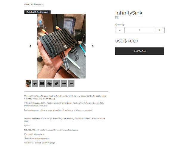

yo your site needs the heatsink holes and dimensions
use this for now:
danky
What for specifically? The cut template is on there with mounting holes.
I am happy to put the drawing up there or something, but just curious what you needed.
Thanks man :call_me_hand:t4:
make this easier to find, and put one in the product photos
see it?
oh downloads page I found what you mean I guess

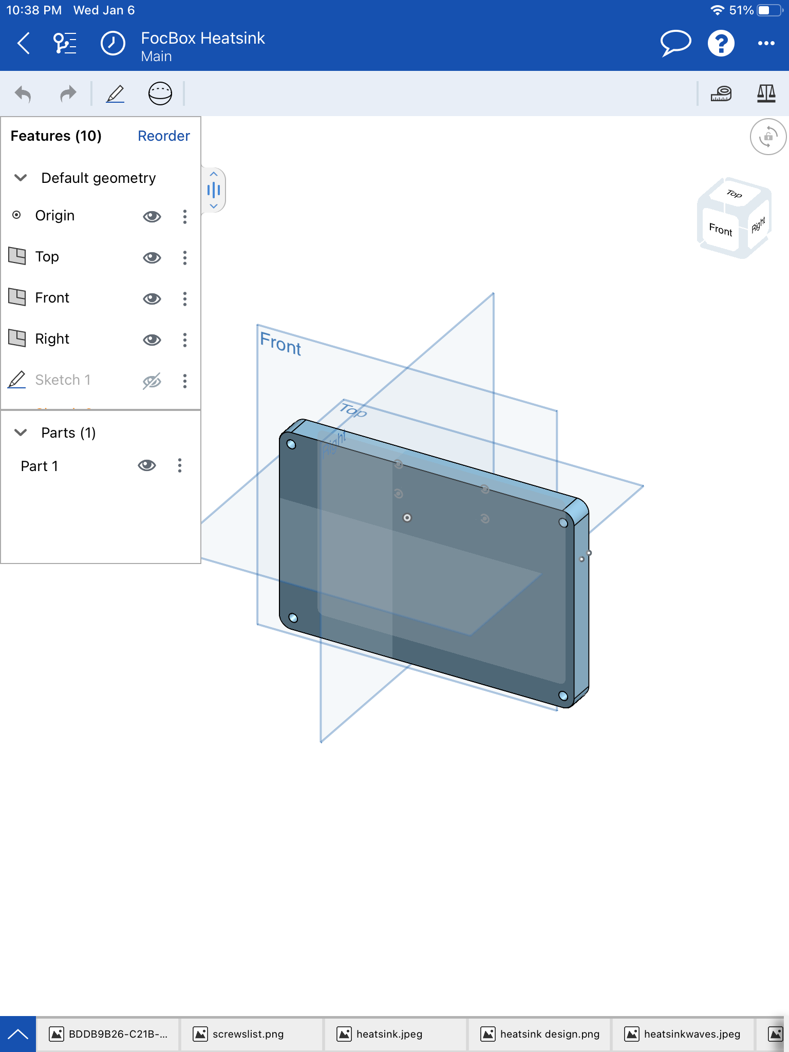

Asking as nicely as I can, is it possible to get the cam file? Working on my first board please…?? I have access to CNC machine and software don’t have money but I have access to cool toys.
First… definitely not, sorry.
Second…with access to that kind of technology you should be able to make a good chunk of change making simple parts for people.
Also…you can just design a heatsink yourself, this is a fairly simple part. The infinitysink is definitely more complicated due to the counterbores and multi esc support. You can literally just make a round rect, extrude, and then make fins. Just ditch the infinity aspect, and I guarantee you can have a decent enough design in an hour or two.
strong text
Slowly working on it…
There ya go. Definitely will be easier on a computer, but ipad onshape whips too, great for simple stuff. Made a ton of spacers for frc last year on the iPad lol
PC Fusion 360, use the iPad app for observation, many thanks, been inspired by your work.
Awesome. Looks great.
