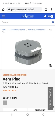

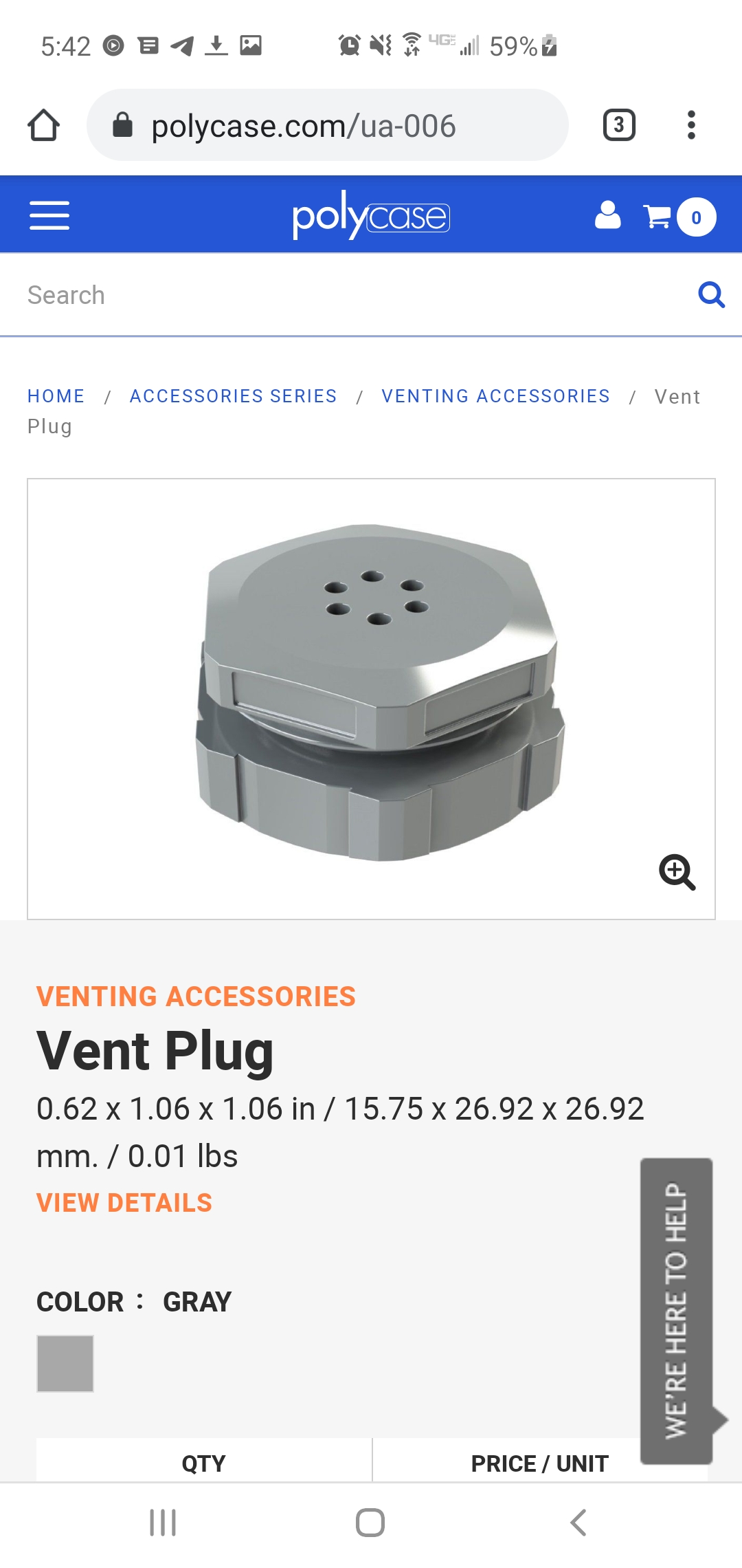

How do you think a waterproof vent plug like this would fare in equalizing with ambient temperature of an enclosure?
I imagine heat building up inside with the batteries and enclosure and leaking out but it could be minimal cooling.
