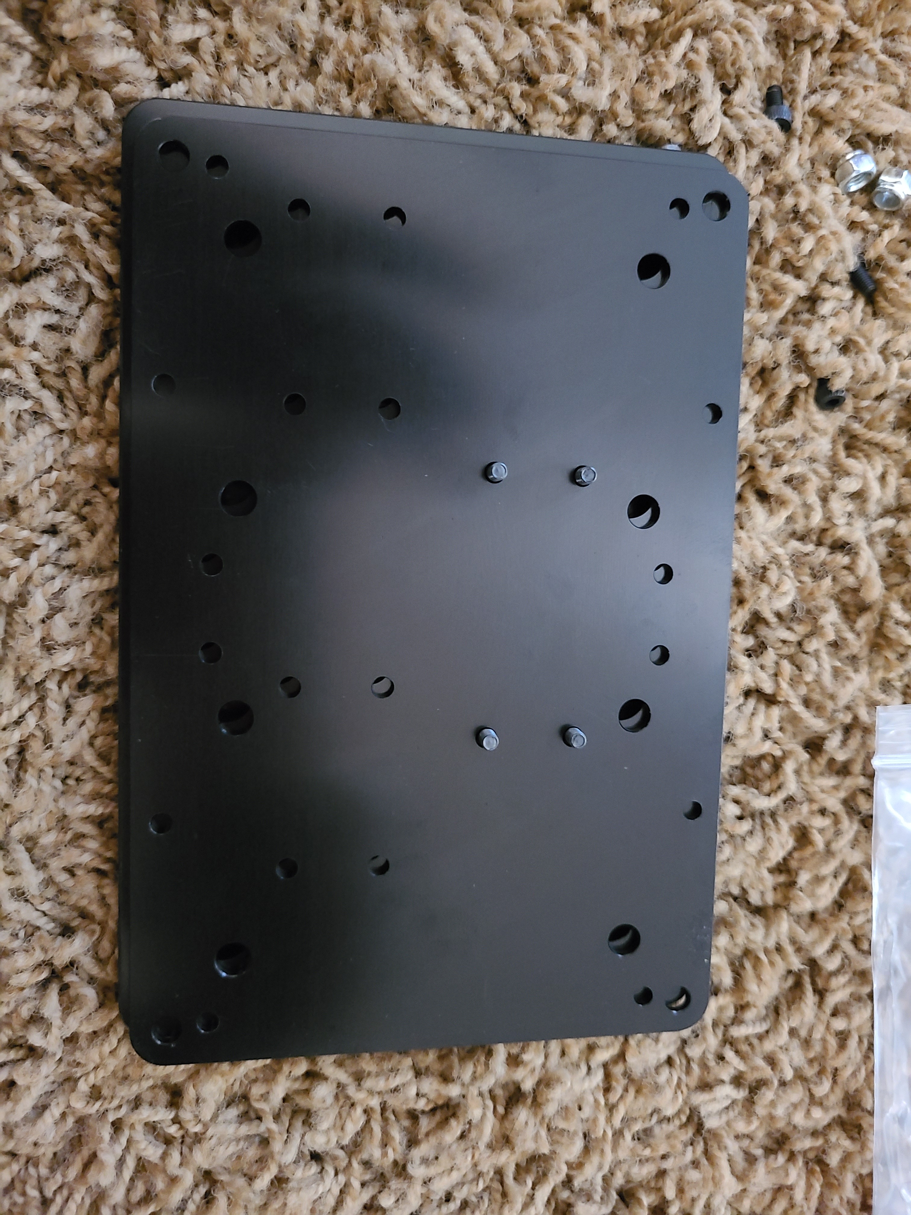

the plates do not line up for unity and storm core dual. They made the wrong plate. The holes are off by just a bit as shown in the pic
all of the other ESCs fit without issue. Your TB6 escs will fit no problem

Anyone know if this will work with the Maker-X Mini Foc Plus?
it won’t i guess, the hole pattern seems to be in weird places (for the heatsink)
Got this mounted and @surfnacho pointed out the other mounting holes :slight_smile:
So the plate attaches to the heatsink with these (4 x M3)
