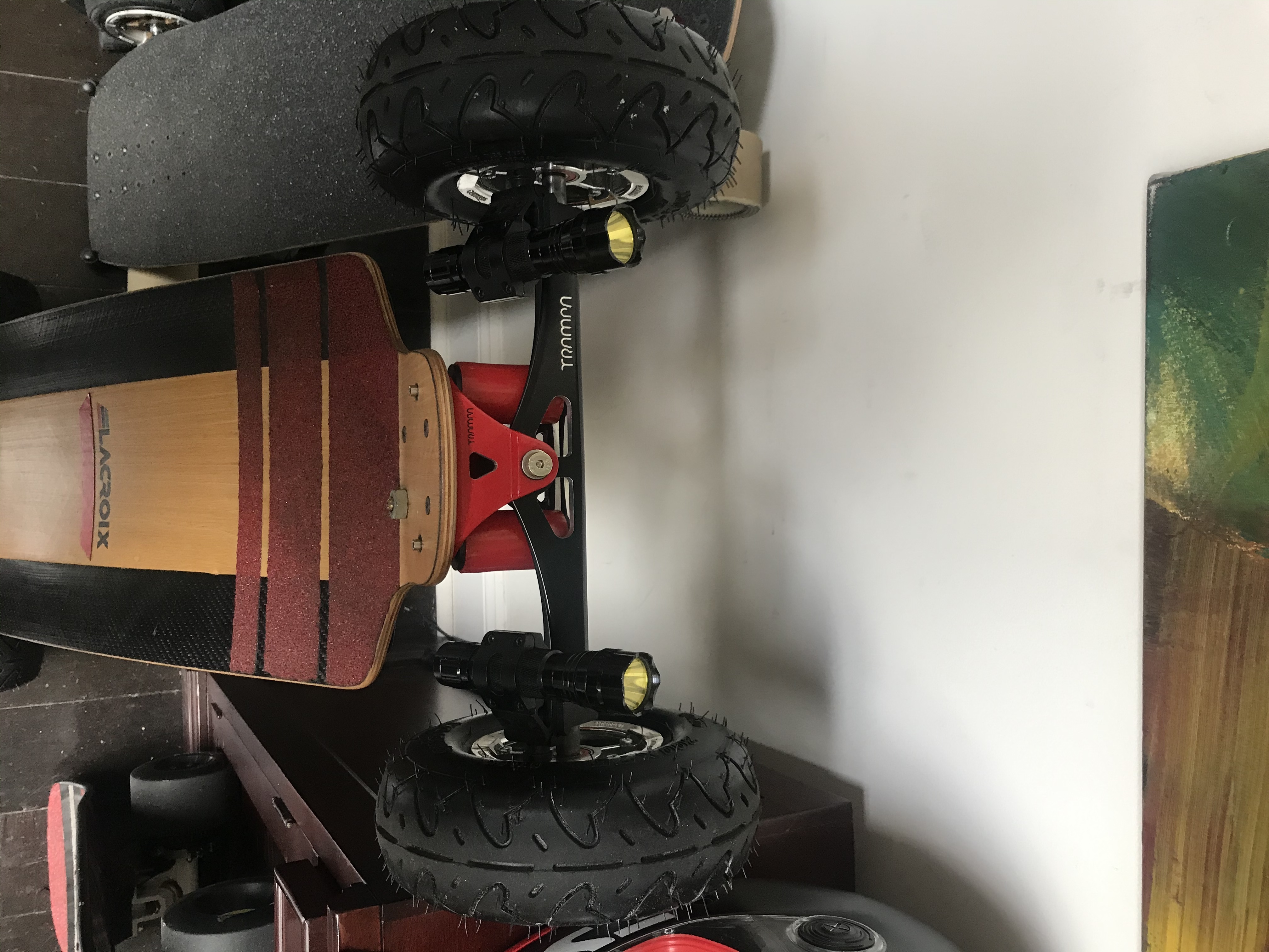

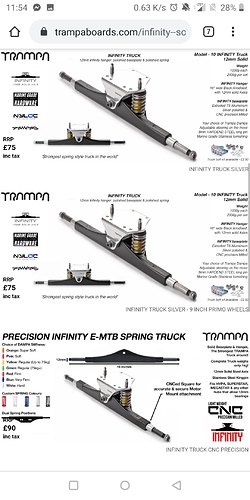

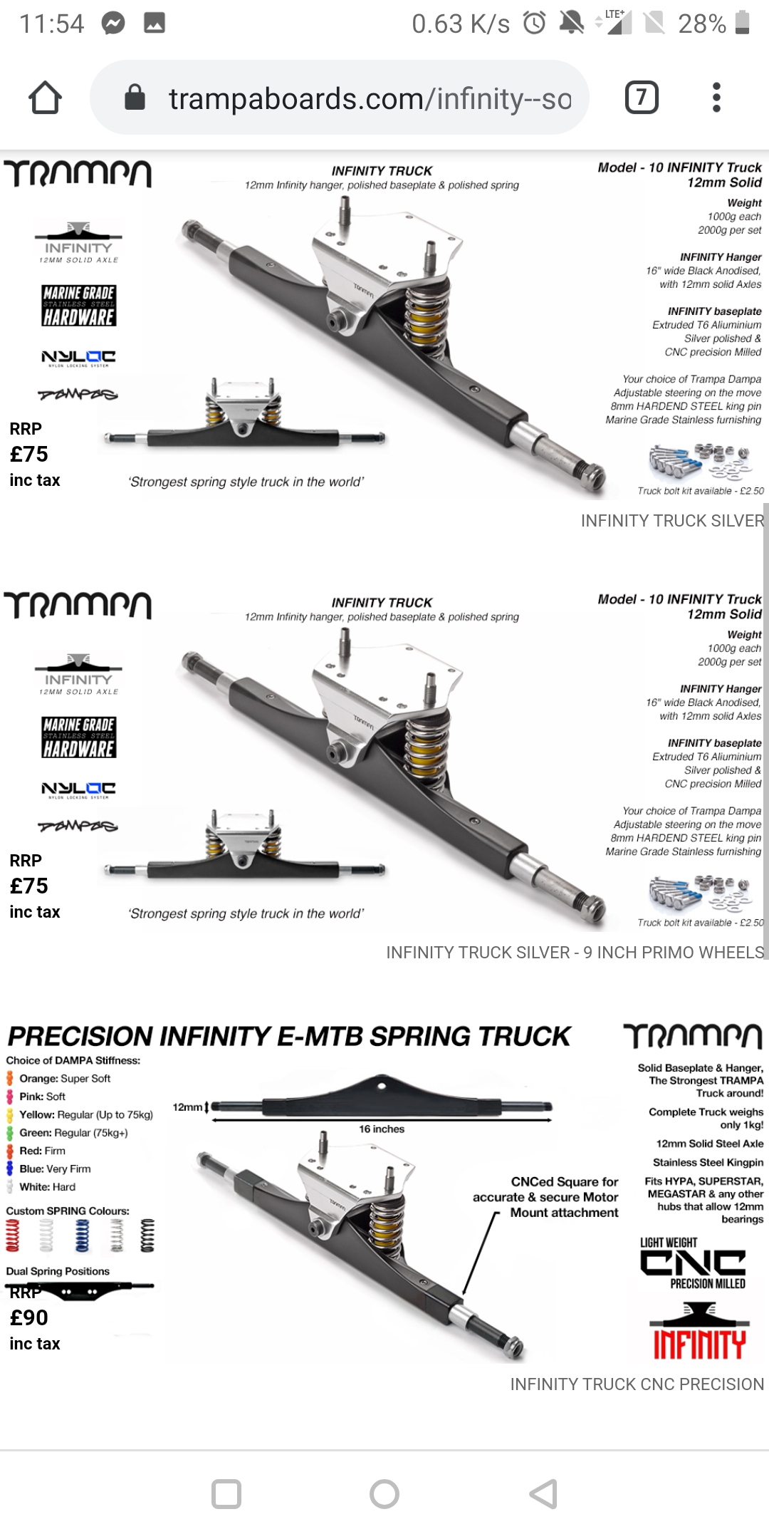

Don’t really know what category this falls under. But does anyone know what these precision CNC infinity trucks are for? Ive got just the regular infinity trucks but apparently there were other options…
Was I supposed to buy the precision ones to fit 3DS gear drives or are they only for trampas own clamps? @Trampa @3DServisas

No, I have the regular infinity trucks which were cnc machined by e-toxx to fit his clamps.
If you were to use e-toxx gear drives you would either have to go that route or buy the cnc version from Trampa.
I believe they fit both, just a matter of tightening the setscrews further when having the square cnc’d version. My old trampa belt drive was made for the cnc’d version but fit the normal one fine aswell :ok_hand:
Gear Drives made for Trampa Infinity hangers will fit bolt-on on these hangers. Except the last option which is pre-machined(squared).
Looks like I bought the right shit. Thanks! Please close now @BillGordon thanks!
