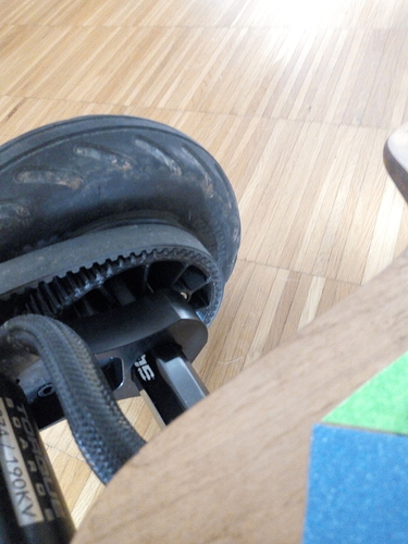

Inexpensive Pneumatic Belt Setup with 6 inch Clever tires

Interesting that the pulleys held up so well, what weather/terrain conditions did you use these in?
I’ve used printed pulleys before, though not at this size, and they held up remarkably well up until they were used in the rain on a gritty/sandy path, seemed to sandpaper the teeth down extremely quickly at that point.

I ride them in all weather condition. Actually this is the one that I take when it’s raining outside. My other DD board battery is not enclosed so I only ride that in dry weather.
I think it lasted this long because I had put a layer of super glue on the teeth and I generally don’t make the belt too tight.

Awesome pulley, I’ve got a couple hundred kilometers with no problems on my old setup with BN220s, besides wheelbite which has nothing to do with the pulley and everything to do with why I’m going to Matrix IIs.
Why are your rear tires backwards?
I just threw them on to check belt length, direction doesn’t matter if I can’t ride the board.
