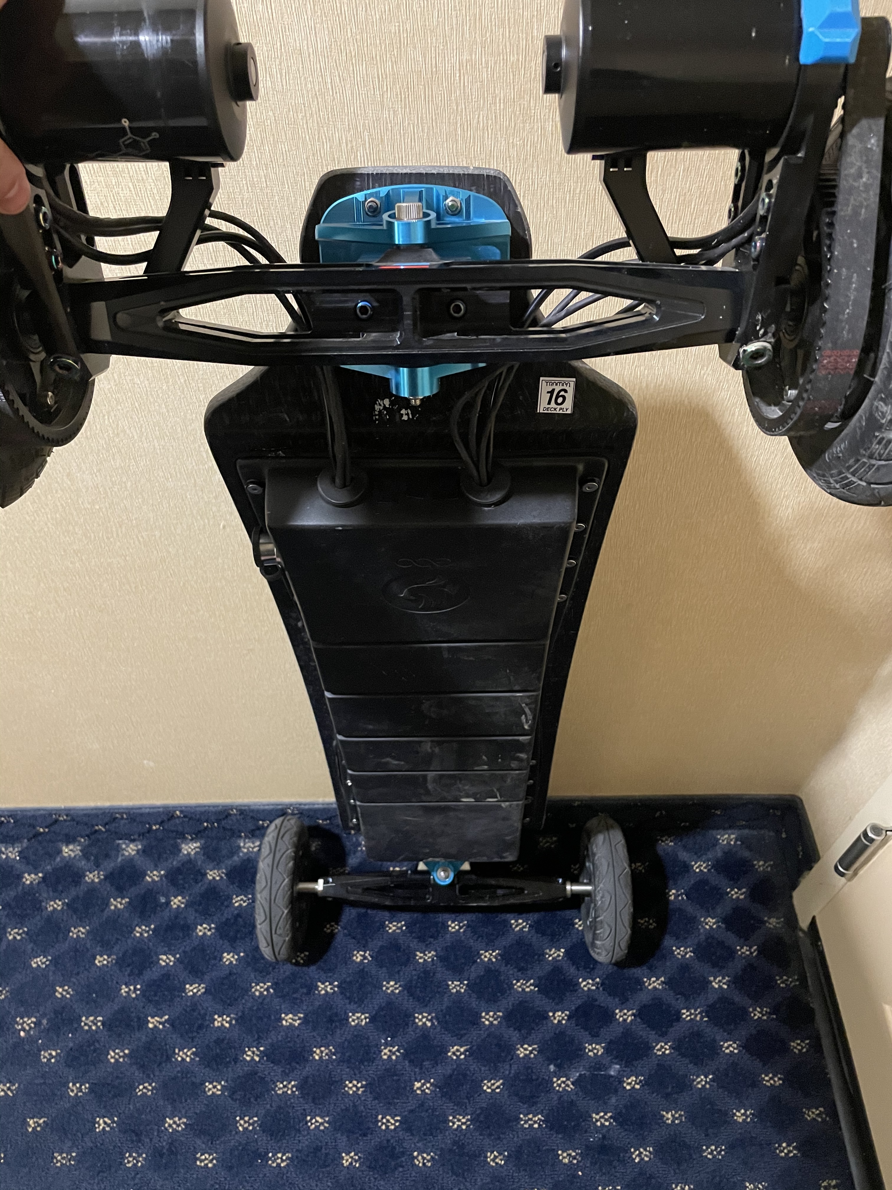

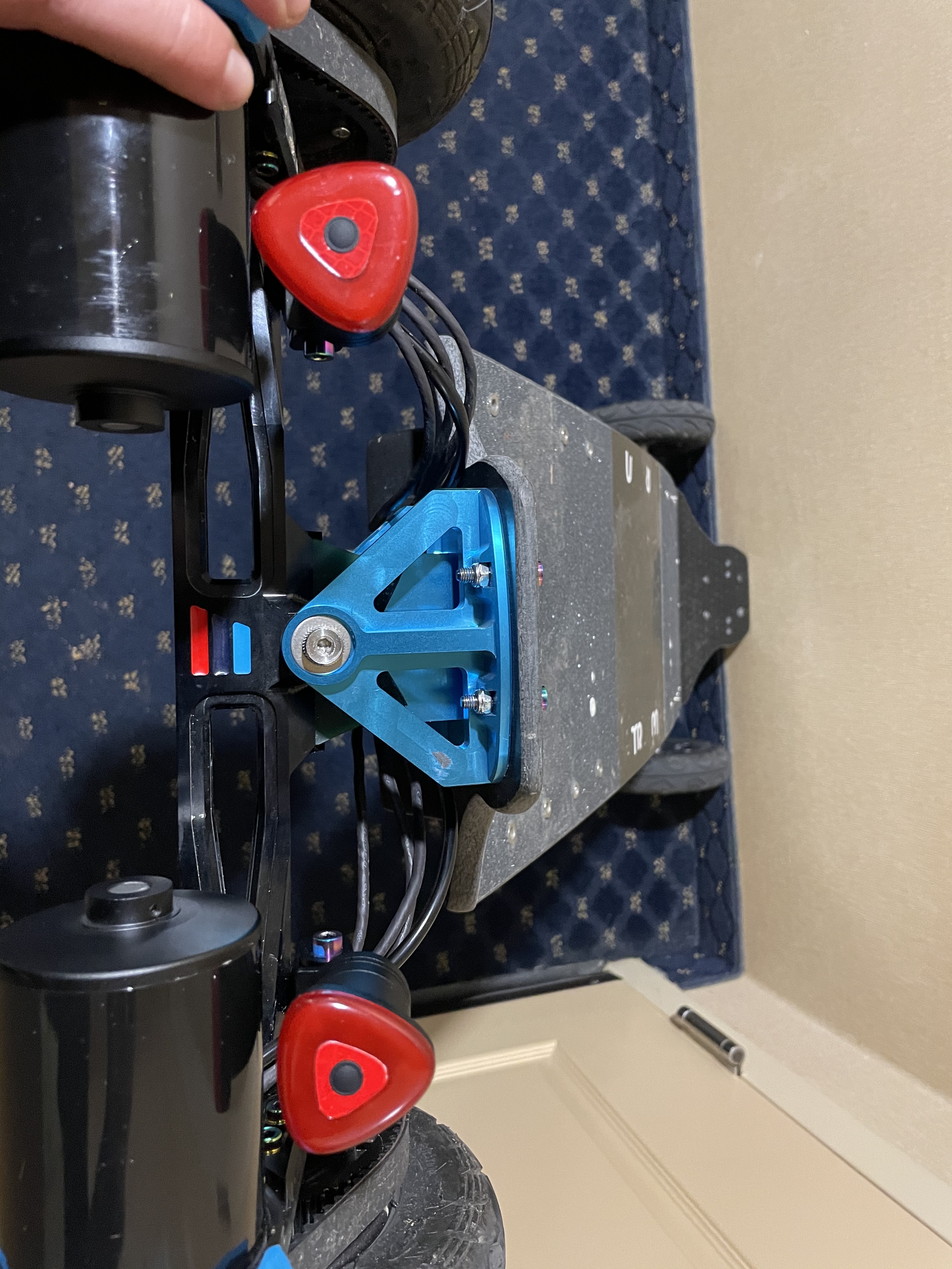

I give you… the nightmare. Because thsts what this thig has been. :weary::joy:
Its a trampa hs11 fatboi 16 ply deck with lacroix hypertrucks, stormcore 60d and a 12s7p p42a from eBoosted. Originally i was going to go with the setup Sean had, but soldering the phase wites proved damn impossible, so i had to drop back, and punt as they say. A new set of motors and a new stormcore later, and i finally got her up and running. Still trying to diagnose the quirks, such ss the crappy ride, but overall, for my first DIY, i guess it could have gone worse. Haha! Thanks again Sean! :slight_smile: @Creavenger @SeanHacker
Oh shit. It’s those baseplates maybe? I swear the blue ones are set at a higher height than the red ones that I have. Those are for the big batteries on lacroix boards to make clearance for the batteries. So I’m thinking that may be the issue?

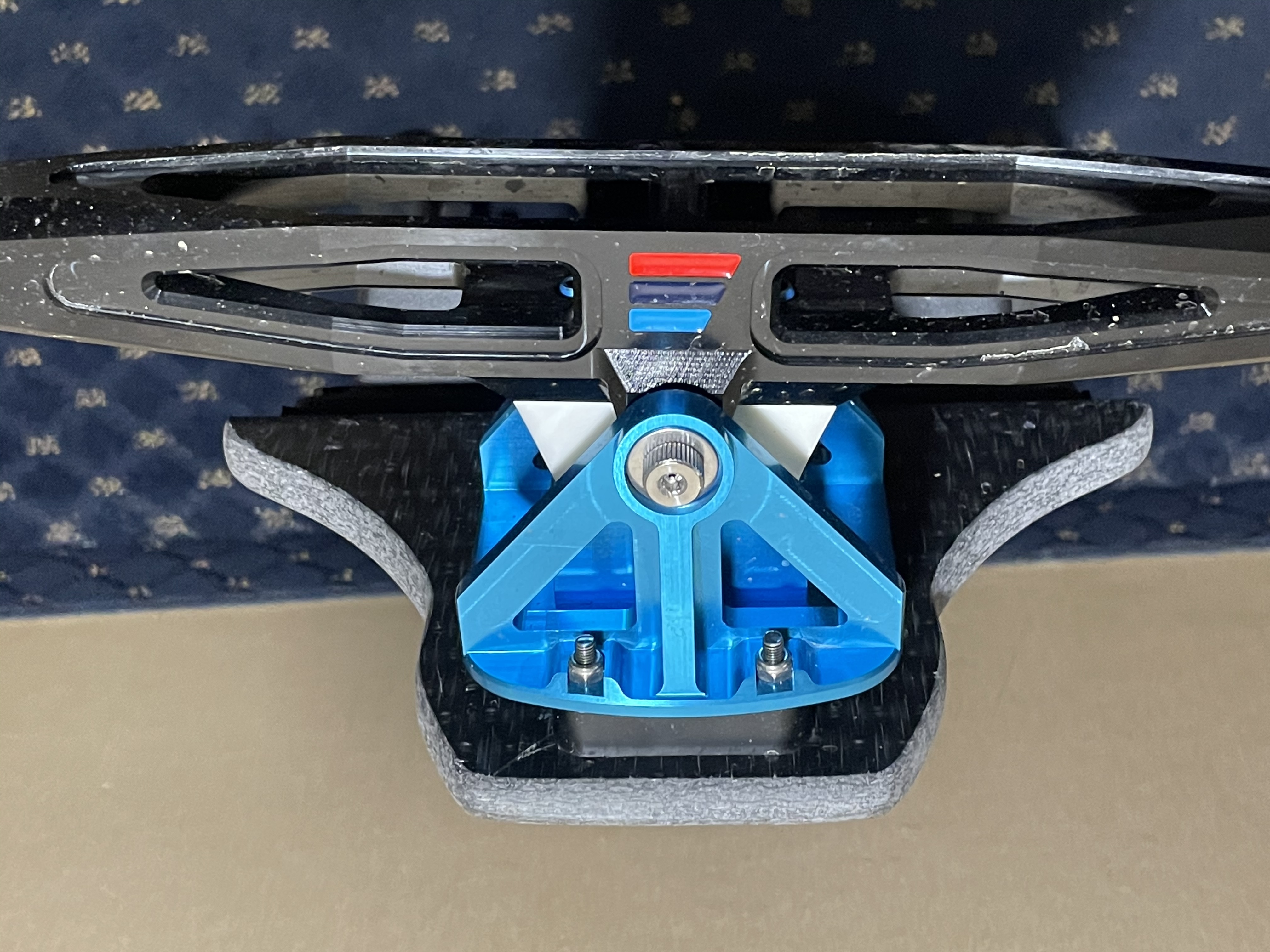

I would definitely give those white and blue bushings a try and see if maybe they help a bit. Would most likely at the least be able to carve better than the stiff ones.
Looks pretty dope on the trampa deck! Its probably the bushings that cause the trouble, but another thing I want to point out is that the trampa deck doesnt have any concave and since you dont have bindings either controlling the deck is probably a bit harder too.
@SeanHacker oh really?! I didnt think there was any difference! That might be it. I took the riser out and I swapped the bushings for blue in the front and white in the back, so well see what happens (id have never figured thst out onmy own, its stupid easy!!) hopefully after work today ill get a short ride in and we’ll have a verdict.
Thats a good point too about the concave, but with the riser in the front things changed drastically for the better. Were gonna find out soon!
@SeanHacker hooooly shit. I think you nailed it with the trucks being different! If you look really closely even on the website, the red has a shorter front, causing the deck to sit closer and the headlights to be realitvely higher in proportion!
waaait, I’ve seen that video in the sandrunner thread few months ago :smiley:
Once again @SeanHacker is the man! Blues in front whites in back, no riser… carves like a well oiled champ! :joy:
