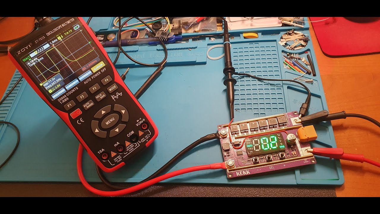

There is another inexpensive spot welder on the market.
Also purple. This one is programmable, dual pulse, and has 1, or 7 more Mosfets than my older purple welder.
Kekk k100
https://www.aliexpress.us/item/3256805395084787.html?gatewayAdapt=glo2usa4itemAdapt
This guy shows how to modify it to prevent low input voltage frying the mosfets, but apparently there is a revision which does not require it.
I think I’d just drive its circuitboard with a separate 12v battery via an XT 90S antispark, if i were to acquire it.
I’d like to use 0.15mm copper and 0.1 NPS sandwich on future batteries.
Perhaps a better weld lipo, or a second one in parallel) would allow my existing purple welder to accomplish that, or maybe acquiring this newer dual pulse welder would be justified.
I couldn’t and can’t justify a Kweld or Malelectics or a Glitter, for as few batteries as I plan(ed) on building.
Luca put out another Video in which he claims to have another modification for this new double pulse Purple spot welder.
He indicates the time to switch on the FETs is fine, but the time to shut them off takes too long.
