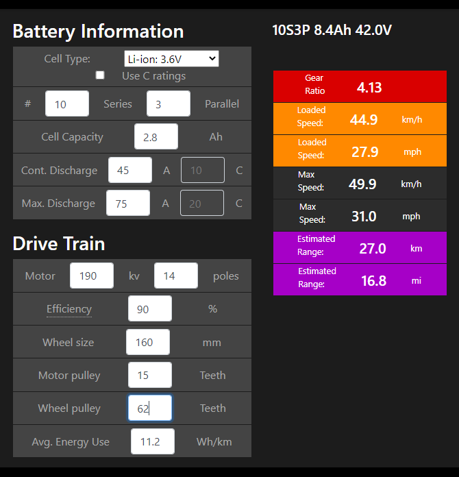

I’m pretty sure it’s a typo, everywhere else in the site says 62T including the question on that page
hmm im counting around 30 for half, so maybe
But if you want see real torque at some point soon I’ll have 15:72 with dual 6380 motors and a 180A battery :yum:
:open_mouth:
You probably caught the typo there, this makes a lot more sense
after counting, can confirm its 62t
The speed match what you were expecting now?
3mph faster is closer to what i expected, but somehow my original calc put the pulley at 55t, which made me excited to brag about “32mph” but honestly I can really care less, I cruise at 13-15. I was fine with a 12a esc and I dont need to be bragging about life threatening speeds
even with 62t, the torque is wayyy higher than what I need out of it. I was able to climb the steepest hill in my area at cruising speed on medium, which surpasses anything I would want.
