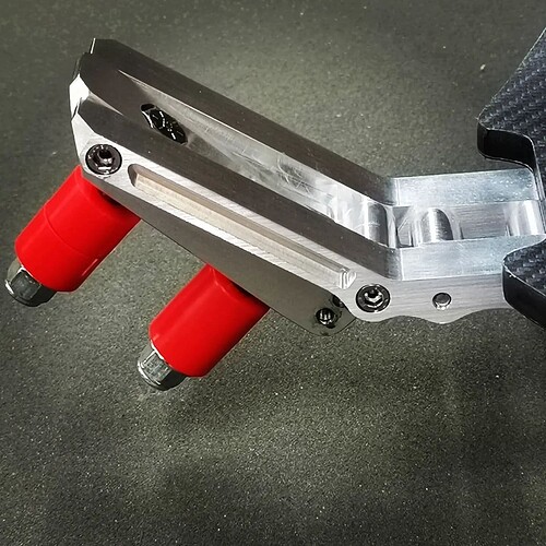

If you mean an angle change built into the brackets, I designed something like this.
I designed a truck with 2 parallel kingpins (noSno type) for the mini criuser version, but I didn’t know what bracket angle to choose, so for the test version I redesigned the base plate and brackets so that the angle of the truck could be changed
First version
and redesigned bracket and baseplate
The prototype version made of aluminum is slightly different, I will post pictures when I finish the prototype

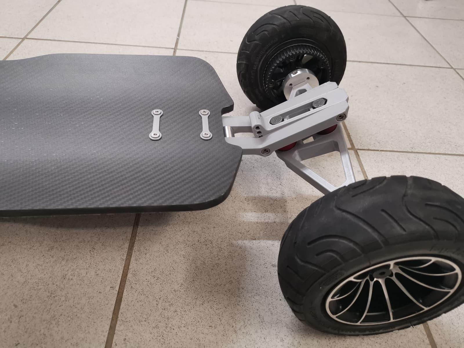

New prototype bracket and baseplate with adjustable angle for cruiser
I just need to finish the hanger and the tests can begin

very elegant angle adjustment :ok_hand:
Yes, that is exactly what I was referring to! I love this design. What are the different angle adjustment options and what hangers are these compatible with?
Curious what size pneumatic tires are on that 3link board?
Angle change is every 4.7 degrees
Baseplate is a part for my hangers, if this solution works I will design a similar solution for RKP trucks, which I am also working on now
I think they are Trampa tires 6.5 inches

That is really cool. So it looks like there are 2 adjustment settings in each direction. If the base angle is set at 30’, does that mean the angle adjustment range is from 20.6’ to 39.4’?
Have you electrified this yet? Curious to see a review on how this rides.
The base angle is 35 degrees, the additional angles are. 30,3, 39,7, 44,4
You can reverse the hangers, then it will be higher (I don’t know if I haven’t checked)
I could also modify the baseplate a bit to make it higher, that would increase the ground clearance
