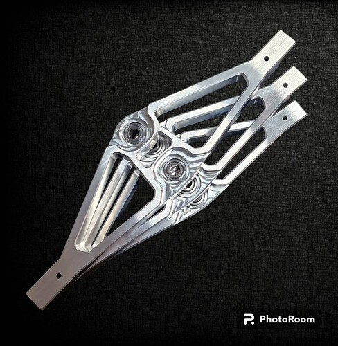

I really cant tell from the angle are taken, how much ground clearance will there be with the angled brackets, new trucks and new eBoosted enclosure?
@IDEA how much do these brackets lower the ride height?
I’m interested in using them on my re44, but I have a double stack and I’m not sure I’d have enough ground clearance with the lower ride height.
The price of the ATB version will be $320, this is the price for 2 pcs…
The clearance from the deck (measured at the lowest point) is about 100mm, so if the enclosure is 50mm high, the clearance at the ends will be about 50mm and in the middle about 70mm.
Height measured with 165mm diameter wheels
The clearance is about 95 mm. The clearance from the bottom of the deck to the ground (road).
Measured with 150 mm diameter wheels installed…
Currently there are 2 options to choose from, an adapter or a bracket.
If needed I can design a longer adapter, something intermediate from the currently available ones
DPKP hanger with 3 width variants: 270, 300 and 320mm (width measured without axles).
DPKP 320mm mounted on Trampa deck

@IDEA how much for these 3 Link brackets for traditional board?
2 pcs (1 set) - $200
Shipping to US (by Fedex) - $40
Price $200 applies to sets with short and medium top plate. The longest version, i.e. 186mm, costs $240, unless someone buys a set with a deck, then the price is also $200.
Threads are in inch standard but on request I also make threads in metric standard

I think I currently sit at 100mm so 5mm difference likely fine. But looks like I will have to outward mount if I go this route.
I’m working on the build but haven’t made a roller yet. Should have it on wheels this week once the deck gets here. What clearance spot are you talking about being 100mm? I’ll be running 200x50 tires on mine.
On 150 mm BRP tires, bottom of the deck to the ground similar to the way Tom measured above.

Just got these mounted on my new deck. I am using 200mm tires and I measured 122mm from bottom of deck to the ground.
These images give me hope that I can still reverse mount
With the IDEA brackets I’m not sure since the main heim comes out parallel with the deck instead of perpendicular like the normal SRB one, but I can’t really say for sure
