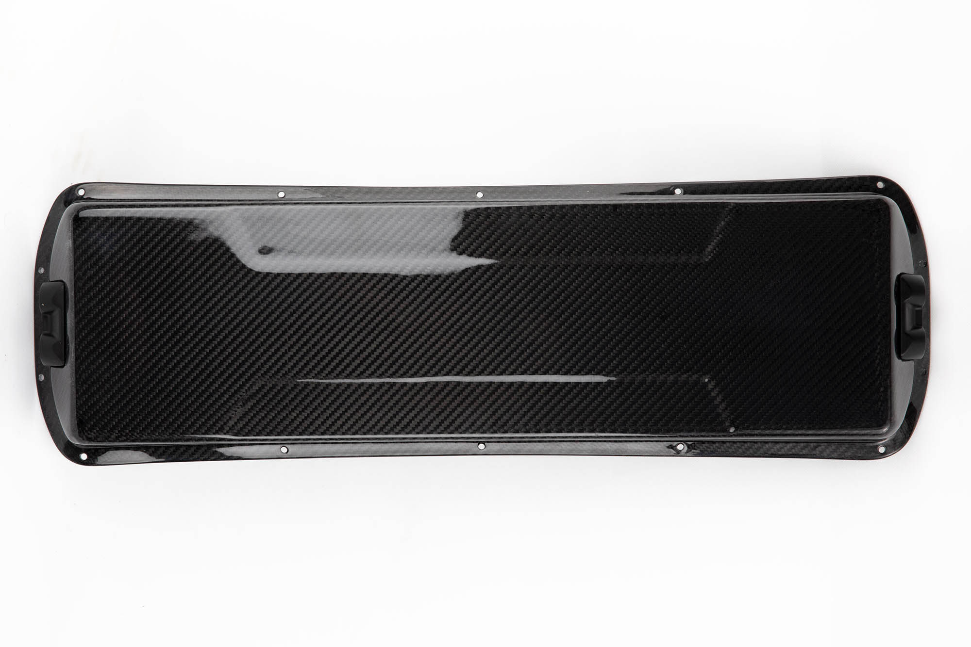

I’m wanting an idea deck with brackets, I know if some single stack enclosures that fit, but I’m looking for a double stack, or someone that can make a gasket spacer to allow the space, does anyone have any ideas or know if any that would work?? Tia
@IDEA shared these with me over Instagram. I don’t think he’ll mind if I post them here given that you’re looking to support him.
It’s the hi5ber zenith mkii 21700 @eBoosted . Hi5ber Zenith MKII 21700 – eBoosted Shop
Yes we’ve been talking and we can’t find a doublestack which is what I’m after, im still on the hunt I may just have to get the single stack and find someone to 3d print some sort of gasket or spacer/riser to give the acquired space. Prolly would just need to be an inch thick. Maybe there’s inch thick rubber strips I could cut to shape? But idk how that would hold up under pressure and over time

Theoretically, this enclosure should fit
I made simulation, theoretically 12S8P enclosure should fit, but you will have to cut slots for brackets
That’s my enclosure and deck. It’s very close to fitting perfectly. Will need a little modification, 12s4p 21700 should be possible with it.
I’ve not built it yet as life has got in the way, it’s my next board to do though.
Ive made an enclosure to fit between the brackets.
But to be honest the eboosted universal 12s enclosure works to with bracket cut outs and a 4.5mm closed cell gasket.
12s4p p42a fits no worries and with a dual vesc

Anyone got dimensions of the available space for an enclosure with the brackets installed?

Tomorrow I will post a drawing with the dimensions of the deck, you will be able to see if your enclosure fits
I designed an enclosure that will accommodate a 12S4P 21700 + a large BMS + 2 small ESCs, such as MAKERX GO-FOC HI10
If I use the small BMS only for charging I could also fit 14S4P 21700 + 2 x ESCs

Drawing with basic dimensions. Sorry for the quality
Perfect! Will measure dimensions now

Can you take a picture of your enclosure and draw the dimensions? Like @eBoosted does ?
I could do a simulation if your enclosure fits as I do for eBoosted’s enclosures
Here you have 2 examples

Cross section of the deck with brackets
Guys it might be better to have a deck locally in order to make a perfect enclosure for your deck.
