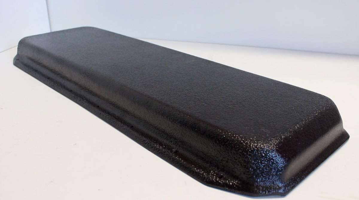

I plan on making my battery flexible and with the enclosures added stiffness, do you think it will be fine?
I have an enclosure if your interested, it’s abs. DM me if your interested and I’ll give you the dims of it to see if it will fit.
ABS enclosures work really well if you put fiberglass tape around the boltholes or use an aluminum bar or something as a multi-bolt washer.
you seem to have a LOT of space left on the deck. what are the usable deck dimensions? i too might have a workable enclosure. brybry is right that its a better plan to use a known working deck/enclosure combo. better, yes, but thats boring. if the deck has a lot of flex, than i think that the aluminum is the better idea. it will stiffen it right up, which will save you from potentially crushing the tronics. it looks rather flat as well, yes? its rather easy to fit enclosures onto flat decks. concave is where it gets complicated.
they are ideally 22 x 7 but could make 24x8 work
i got a 24 by 8. not sure if i have a use for it, literally just took it off a board that i had to take apart til i reinforce it. wcs fishbone enclosure, got it from propulsion boards. one cracked bolt hole i think. its in a stack of stuff atm. i might have something 22x7ish too, ill take a look.
this is also just about 24x8. decent price. also predrilled holes, so theyll be nice and even.
edit: doesnt look like i have anything closer to 22x7 on hand.
