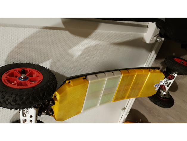

For the 3D printing part, i was inspired by the work of many as :
and this build, i couldnt find the @ of the builder as i only kept the pictures :
i m pretty much confident of my 3D designing skills and i already have an idea on how the enclosure will look, im also planning on installing a bump guard kind of thing to maybe protect the battery pack, im still not sure but we’ll see.µ

Consider tpu for the enclosure. The harder duro tpu seem to be pretty rigid and absolutely indestructible. Im planning on printing a tpu enclosure for one of my boards to replace the over large one it has currently and all my small experiments are very promising.

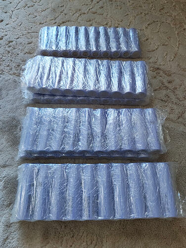

70 Samsung 40T5 4000mAh 35A cells recieved, it will be paired with a 150A Daly BMS, to make a beast 58 V 20Ah battery, i checked out the calculator and it seems like imma be able to push out around 50 Km of range! So excited for this build!

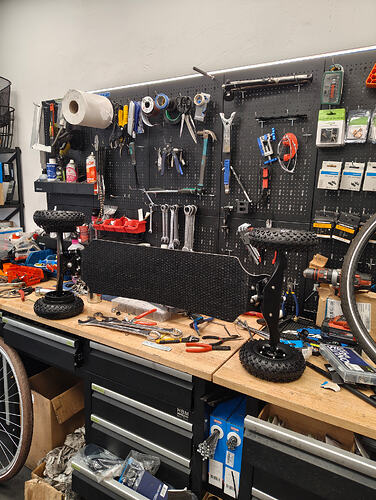

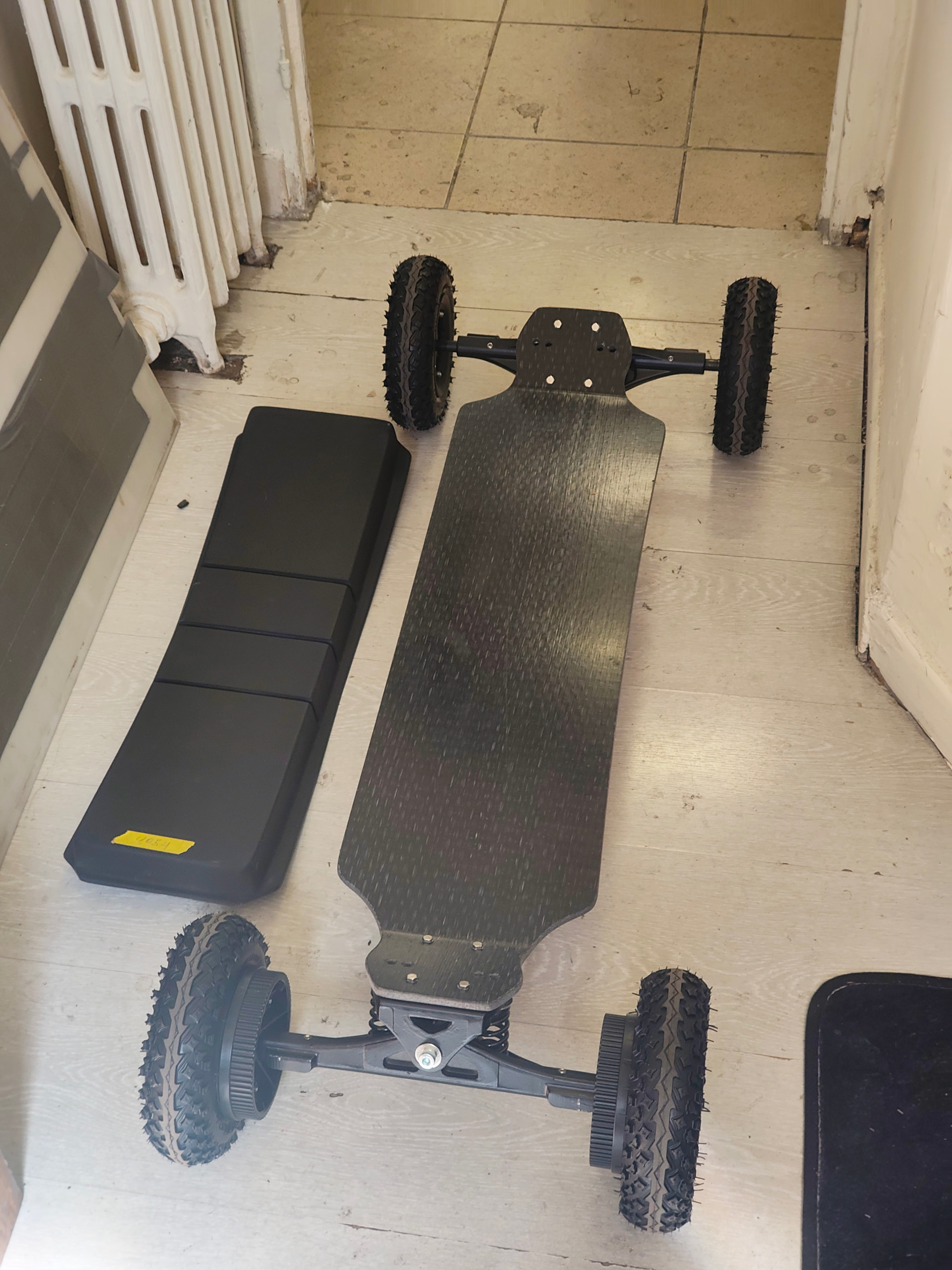

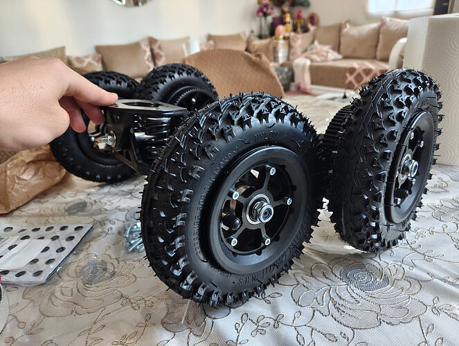

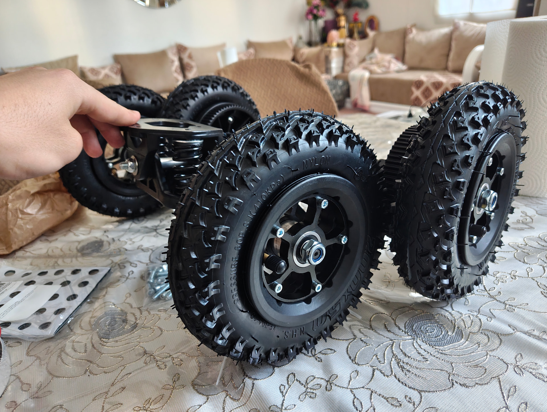

after Saving some money, i managed to order the few important parts! here is some pictures
i ended up by getting the L faster trucks and wheels, because they were the most budget ones, they’re heavy and good looking, the wheels too! i love them, i got the 4 wheels for 118€ from Alibaba !

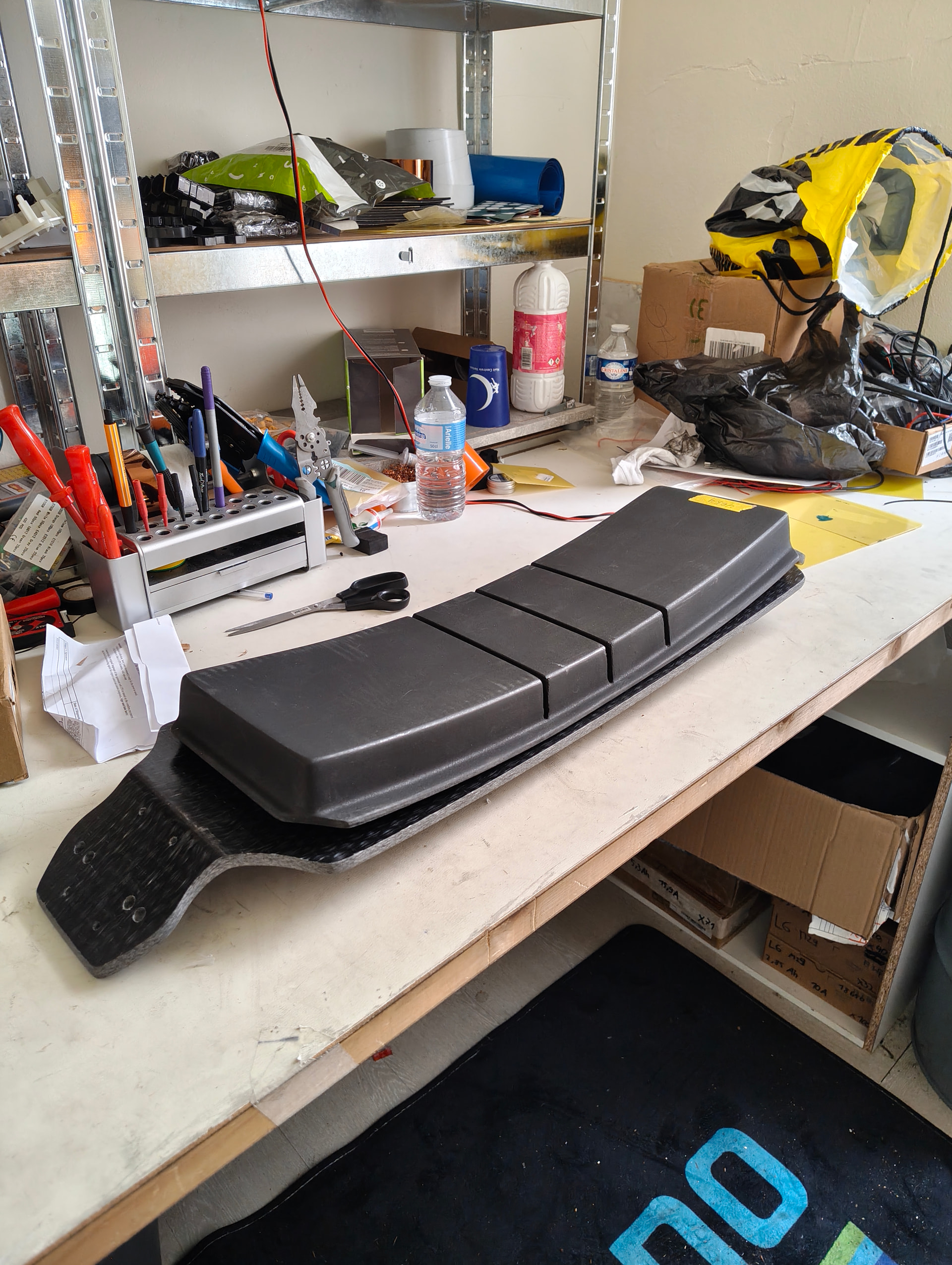

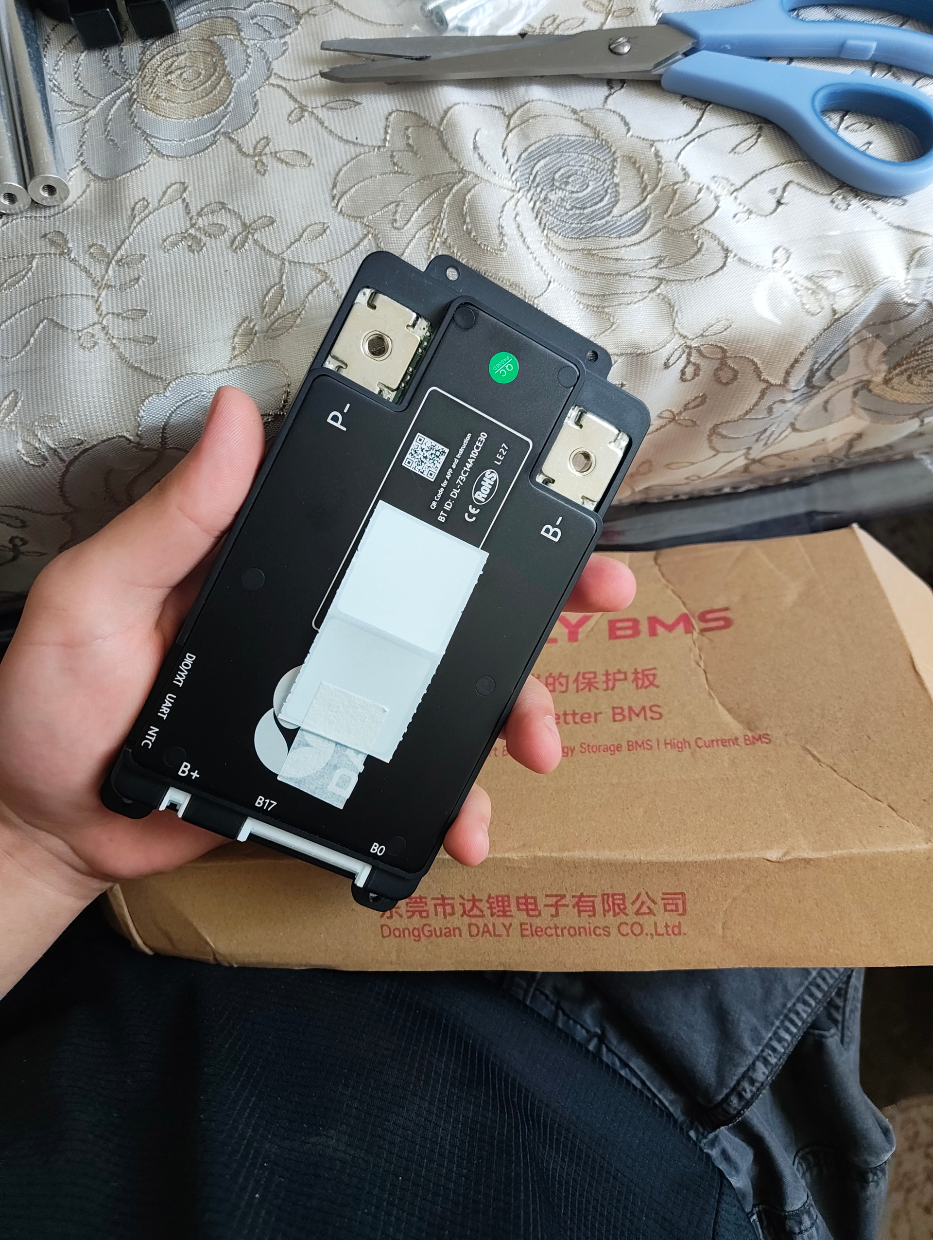

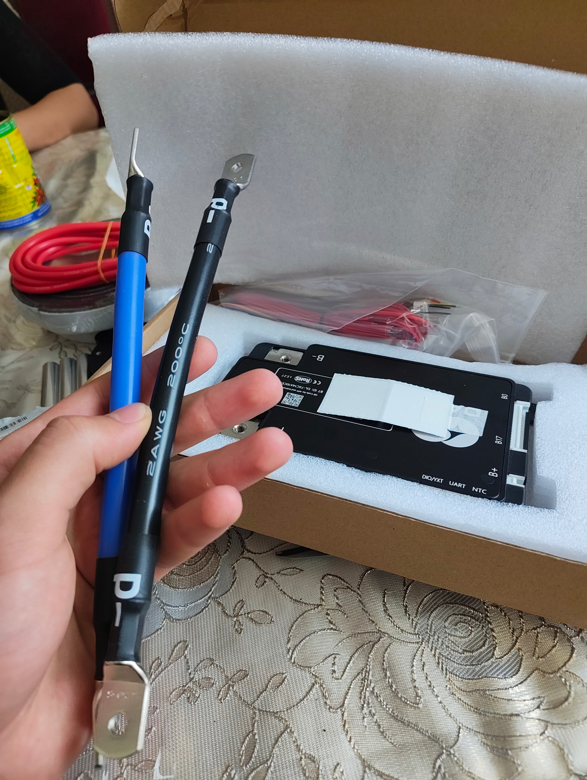

i didn’t manage to get a proper solution for the 3D printed battery enclosure, as it would’ve caused me alot of headache finding a solution to make it waterproof and resistant, so i ended up getting a eboosted Trampa DS enclosure, wich looks sturdy and clean! i will be mounting my 14S5P battery soon once i ordered the right bms, because i litterally baught a 150 A bms, not knowing that most esk8 batteries runs on bypassed bms :man_facepalming: (wich i just learned yesterday).
(bigger than my phone, ridiculous)
i will be returning it and buying a smaller and CHEAPER bluetooth bms, and finish getting the rest of the components (esc, motors, remote, lights…) alot to come!
I’ve seen it called an “ultraboard”. I was actually set on making one myself a few years ago, but just settled on prebuilds and modifying those because I’m lazy af.
oh man i would’ve LOVED to make it ultra slim… but i havent looked it up good enaugh, i had already baught the battery at that time, wich made it hard for me to make it slim, as i had 70 21700 cells to stick on my board, now it’s going to be bulky, heavy, and powerful (i hope)

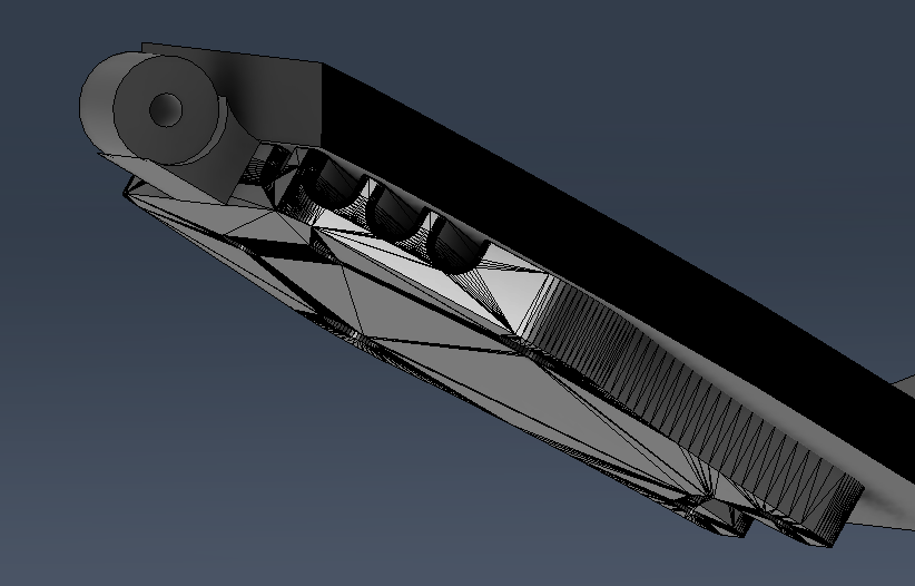

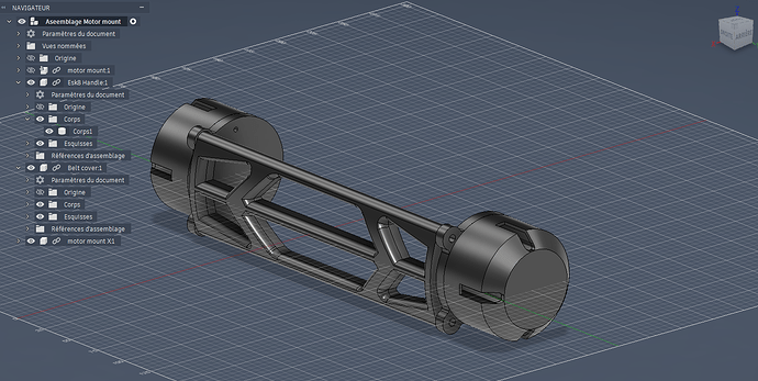

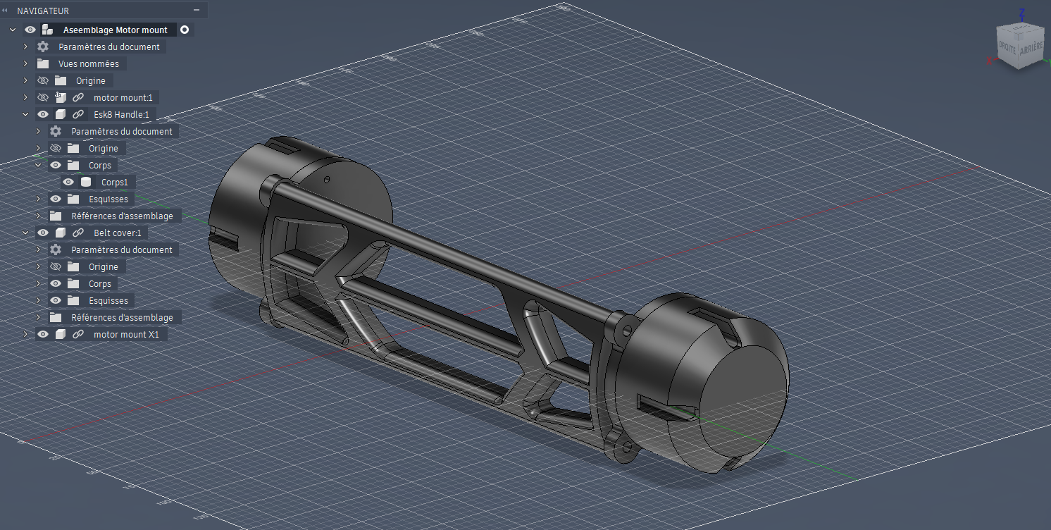

i’ve been working a bit on 3D designing this last week, and im pretty happy with the results, i desgned a bashguard to replace the metal rods and a belt cover :

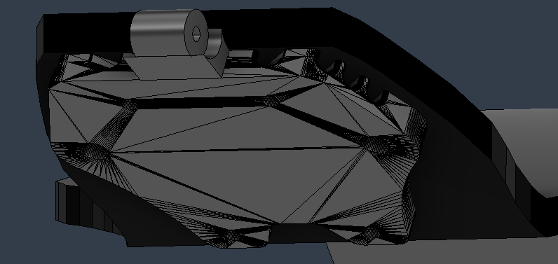

and i also redesigned this Trampa raiser so that i can fix my Meilan, X5 light on it :
I will print these in PETG CF, i will share the results soon!
I also plan on sharing the files once the project is ready, but you can still pm me if you want them :slight_smile:
