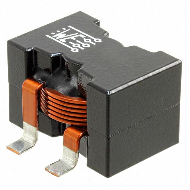

Now I suspect that the max currents that motors often specify is the reasonable limit where the saturation has caused like a 30% decrease in the inductance, but this should be tested and verified in a motor dyno with a standstill test with a lever arm against a scale and see how the motor’s torque is affected by the current and graph it out.
Here’s an example of a inductance/current graph from a pretty beefy inductor and you can see that the inductance is fairly stable until a certain current amount is reached and then it falls of very sharply. This behavior is also affected greatly by the material choice/mix of the core material. (https://www.digikey.fi/en/products/detail/würth-elektronik/7443642200/4865753)
I tried to not complicate it too much, mentioning inductance is fair tho.

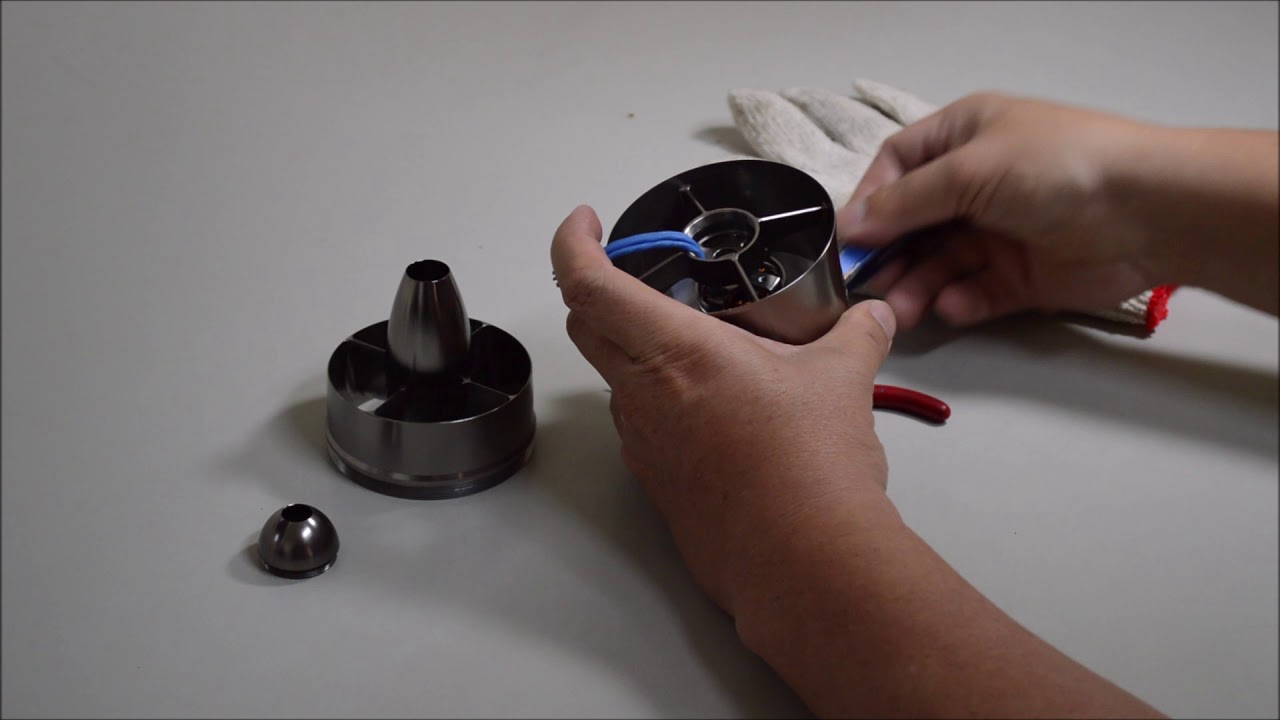

While I agree with the amp-turns explaination. I wonder how it applies to EDF motors that physically berly has one turn(basically just a short) but still seem to be total powerhouses.
Vedder plays around abit with it here; https://youtu.be/fbK2dcoYS7g?si=ta3QMAP7nvlKq5Zi&t=284

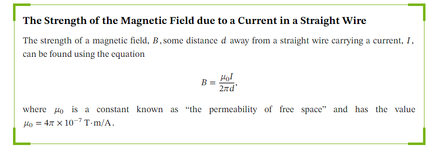

Looking at the equation, B → infinity when I does. But in order for that to happen you need a super conductor… and endless amounts of amps. (calculation is for a straight wire, slightly different for a coil where turns amplifies)
Yes I’m aware of that equation. But my understanding is that saturation is essentially where this relationship starts to break down right? Are you saying that the material properties of copper change in some way as heat increases which hampers its ability to increase field strength ?
I only ask because my understanding was that saturation was related to the actual current level as opposed to thermal conditions. I thought it was essentially what governs maximum torque even over instantaneous timescales where thermal effects do not apply.
There’s no saturation with copper and just ferromagnetic or ferrimagnetic materials

smaller EDF disassembly video, revealing a normal outrunner in it’s guts, looks like multiple turns of wire:
The EDF motor vedder had in the video is this (couldn’t find any info on number of turns used or pole count, but they’re outrunners), so I don’t think there is any special per say going on in the motor, but it is a specialized and expensive piece of kit, so I wouldn’t be that suprised if it has some more specific material choices being used:
He said he took it apart and inside was only what could be desribed has berly half a loop of a bussbar :man_shrugging: he said and I quote: “I have no idea why this spins, seems impossible, but it does”
