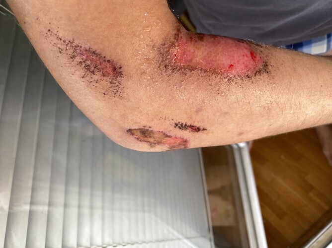

A few days ago I had my first serious fall. Luckily I wore a full face helmet, and according to neurologyst it pretty much saved my life… That’s a good thing.
Why I am making this thread is because that was the only thing I had on me regarding protection gear. Reason why? It was extremely hot day air temp was 39 Celsius ~ 102F and we measured asphalt later that day to be 56c ~ 132F. I have lazy rolling hoodie but it was impossible to wear it, I would be dead from a heat stroke within minutes :joy:.
So, I would like some recommendations, what you guys wear as protection during those really really hot days. Those road rash wounds hurt and burn as hell. It is really painful.
I’ve learned my lesson, really can’t see me going for a ride without some additional protection in future.

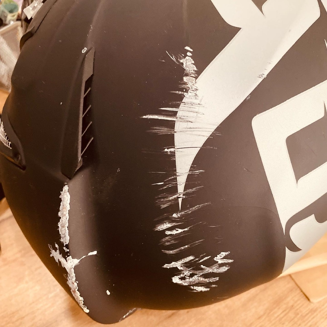

Some pictures (be warned, not so pleasent sight)

What made you fall? Board glitch out, or user error? Looks painful, I hope you get better soon!

It wasn’t a glitch. There was a bump on a bike lane that I didn’t see. I was riding board with a thane wheels so it got my back wheels “ejected” upwards so i lost contact with the ground. I almost got away but a few meters letter I’ve encountered big wobble that threw me off the board…
I think if I were on a pneumatics that those wheels would compensate enough for me not to fall. I am seriously thinking of riding only pneumatics from now on since here in Belgrade roads are really really bad.

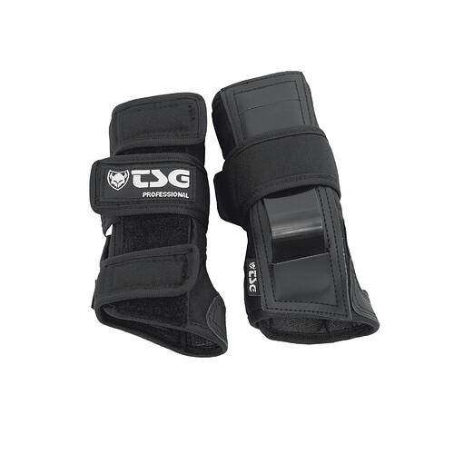

I Always wear a Helmet and wrist guards.

Leave the hoodie at home and get your elbow and knee pads, some wrist guards and a helmet and your are pretty golden.

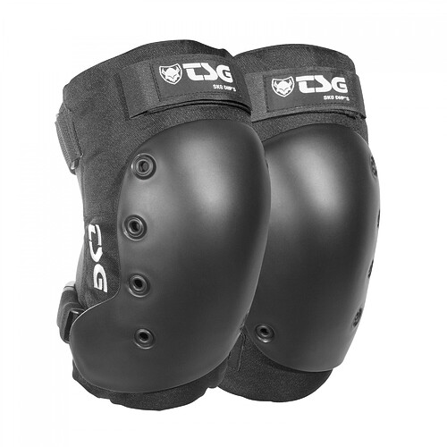

I second the pad approach. I use nearly 20 year old skate hardshell elbow and knee pads, along with slide gloves, and they’ve allowed me to slide out most falls. There’s also lighter, more breathable soft pads for MTB and stuff, and while they won’t let you slide out a fall, they’ll still help a ton against road rash while being much more comfortable to wear normally.

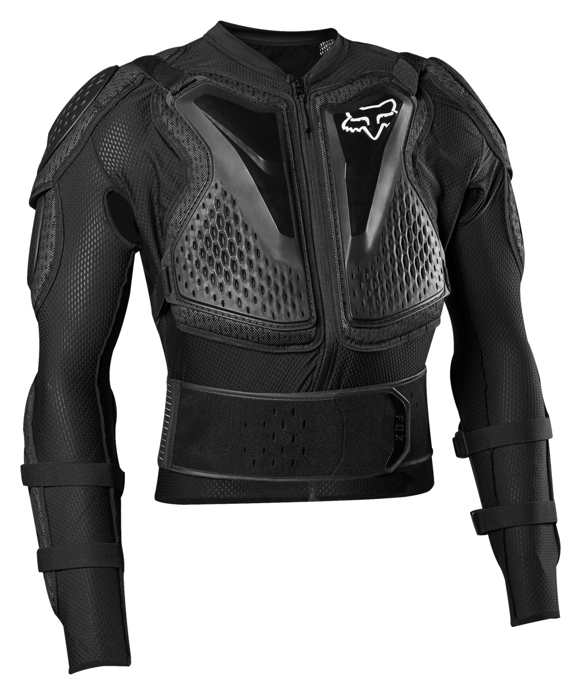

My main piece of protection is the Fox Titan Sport jacket.

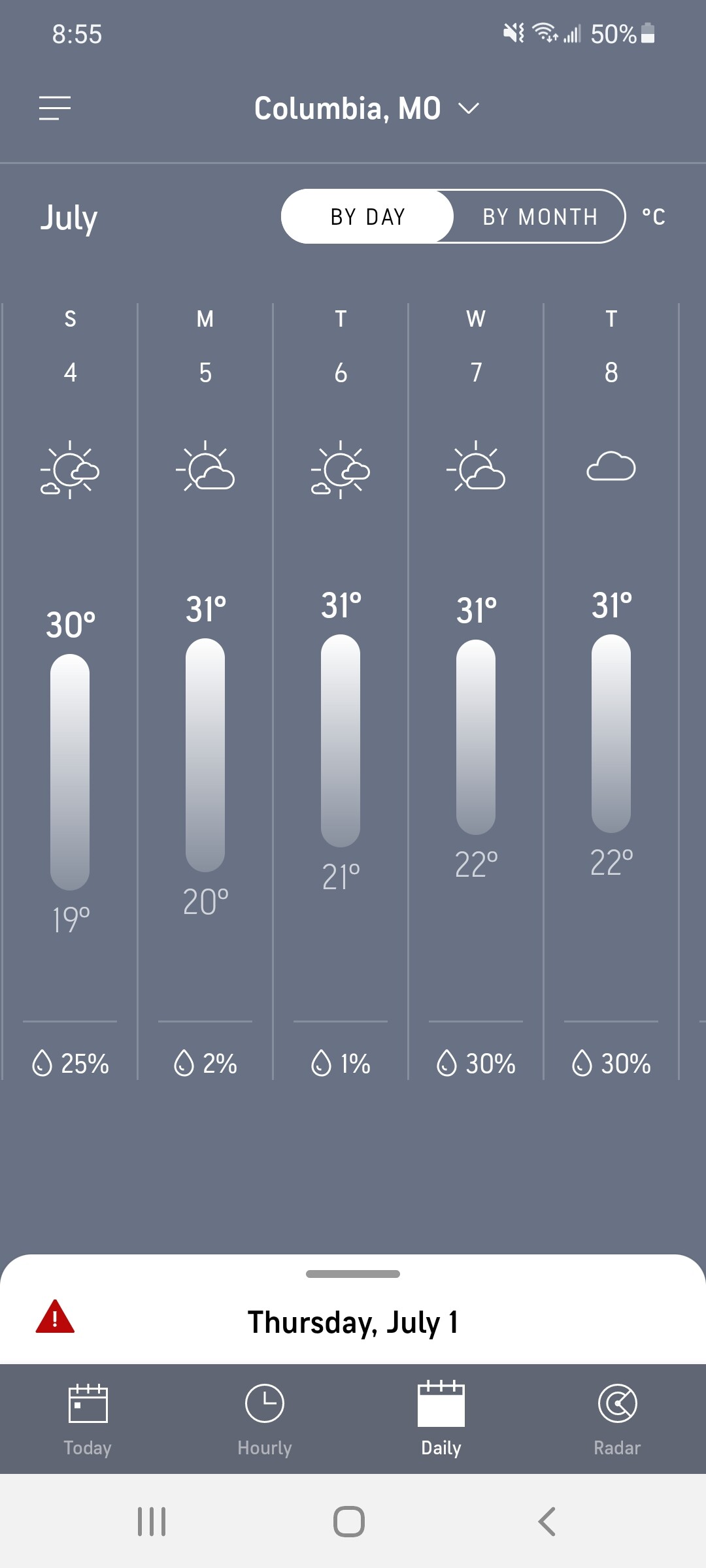

Here in Missouri it gets stupid hit in the summer…
Very humid on top of the heat.
In the middle of summer I can really only ride in the morning or evening.
Day and afternoons are out.
The Fix Titan directly against my body with a loose shirt over it is the most comfortable I can get in the heat.
It is not great.
But it is manageable.
And really helps to keep moving.

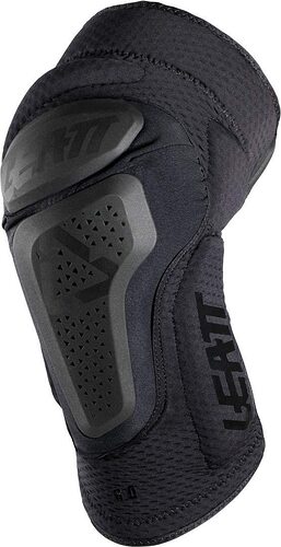

For this year I got these least knee pads for the summer instead of using my tsg dh pro.
The leatt is much more breathable.
