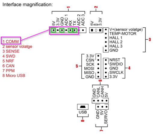

Note we can set a few settings via the remote screen (i.e: cells, wheel/motor pulley…)
For information. The cable that I have received with the remote was not a cable that can be attached to the PPM connector. And it was most probably a cable for the FESC 4.4. So I had to invert 2 the TX and RX wires. Here is how I have attached the receiver to the FESC 6.6:
