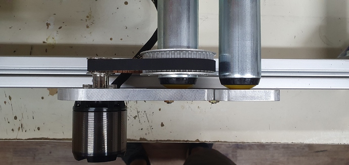

How are you planning to get the data from the rig? Are you using the motors and esc’s as sensors? If so, you’ll need to account for efficiency losses in the motors and esc’s on the rig…
One thing that might be interesting would be to hook up the rollers to a flywheel with a known moment of inertia and plot the rotation speed of the flywheel over time… That’d let you accurately measure the output power of the board.

I’ll connect one of the VESCs to the VESCTool and get some telemetry from there.
Actually i’m not too sure, i’ll fit the roller pulley on tomorrow, and will be able to do a quick test on a board. And by quick test, i mean engaging brakes on the rollers and have gun the throttle on the board to see which survives

Fit the pulley onto the rollers. Ready to run!
Here i am testing a secret board that i can’t reveal much yet.
The rig works well! I have the rig’s remote on one hand, engaging the brakes lightly, and accelerating the board with the remote on my other hand.
Now it’s math time… how do i start
@DerelictRobot! Is there a right way to go about doing this?
what are you trying to measure… i’d like how long escs can put out a given motor current before they thermal throttle
Some basic limit/stress testing could be done by setting some resistance braking to the roller motor, strapping the board down, and using that to hit max amp draw or hold/cycle to a certain amp draw, can think of a lot of things, but I would just start trying things out and collecting data.
