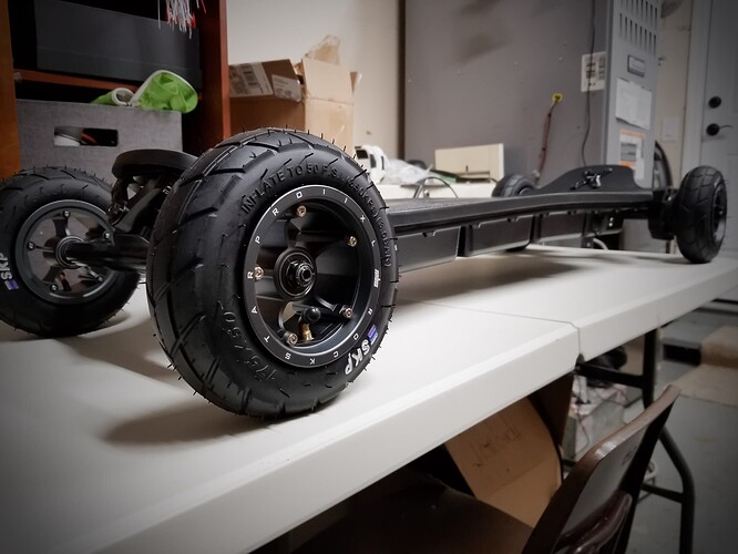

Sounds like a fun street killer. What don’t you like about flexy boards?
Also, sounds like you too need those new Radium wheels to get close to the thane feels, but more grippy practicality of pneumies.
I don’t know. I like my boards stiff and trucks loose :heart_eyes:
I was planning on buying smaller wheels but i cheaped out when i got a bargain on the Rockstars. Kind of regretting it already :joy:
Radium wheels aren’t out yet, and you’ll need the enclosure clearance :stuck_out_tongue:
7 inch wheels would work right? I’ll just try it as it is. And figure it out from there.
I rode 7 inch wheels on my Flux for a while and it was great.
I would probably still be running 7s but the gearing didn’t work out when I switched to gears…

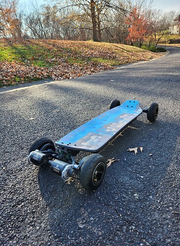

Beautiful! What wheels are those?
HV is hype right now. Look at the gearing also. Quite torqey.
Those were the Kaly Hellcat wides.
They are sitting on the shelf now because I put on the new MBS wheels which are super nice looking too, I think…
I was planning on buying those wheels and Matrix trucks at first but then things changed :joy: They are beautiful. Is it the regular or XL?
these are the XL.
they are a bit different than the Kaly in that the MBS does not actually stretch the width of the tire on regular 7 or 8 inch tires.
the wider outer lip is for 9 inch tires.
but I am really happy with them so far.

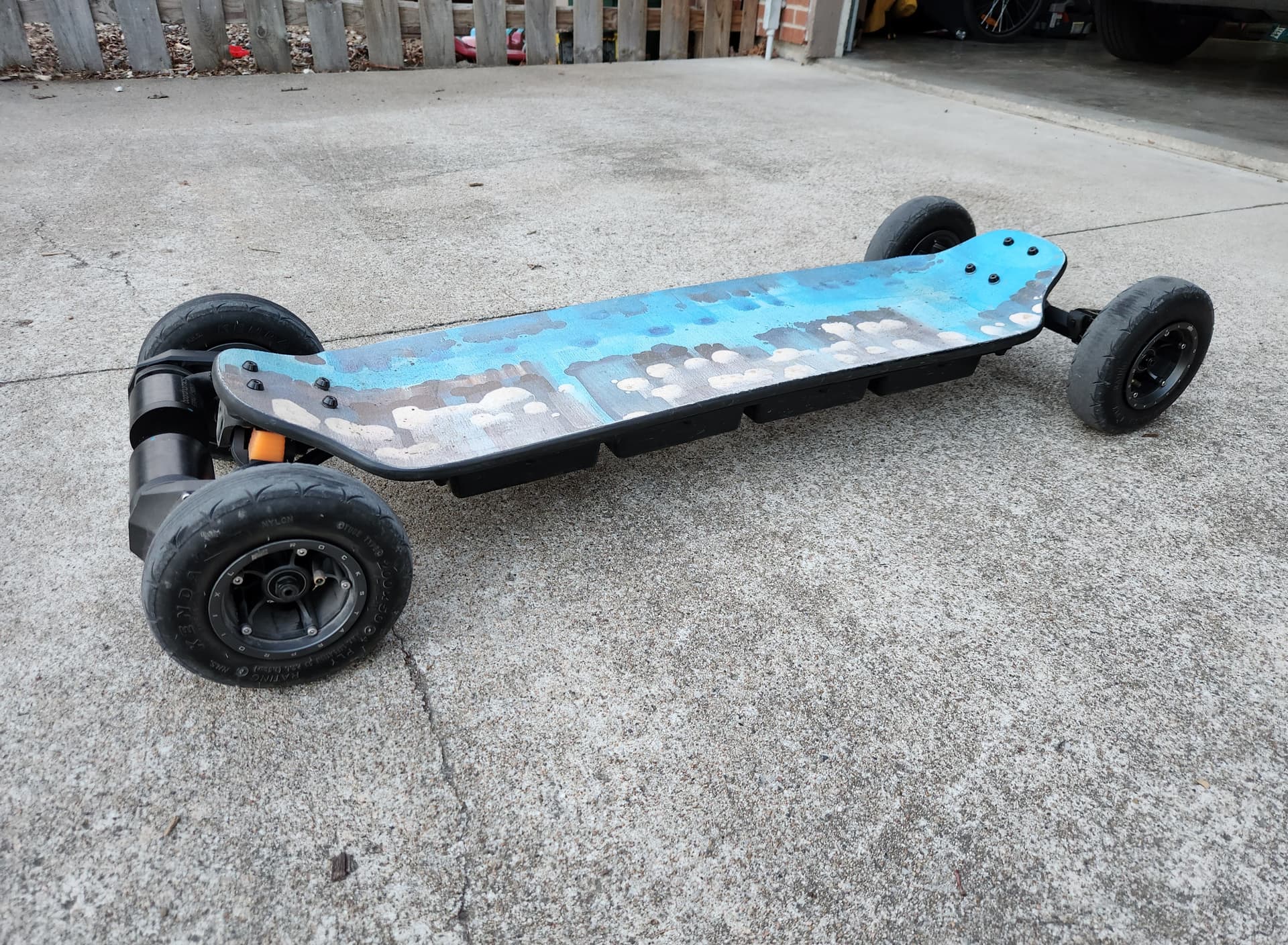

Did you feel that there was any benefit with stretched tires? @rafaelinmissouri
I’m a big fan of 7" wheels on the Flux. Feels more nimble.
For me dude I was not able to really tell any difference in ride feel or behavior.
Other people may have noticed a difference but I really didn’t.
So all I got out of it was the cool look.
Which is in fact really cool.

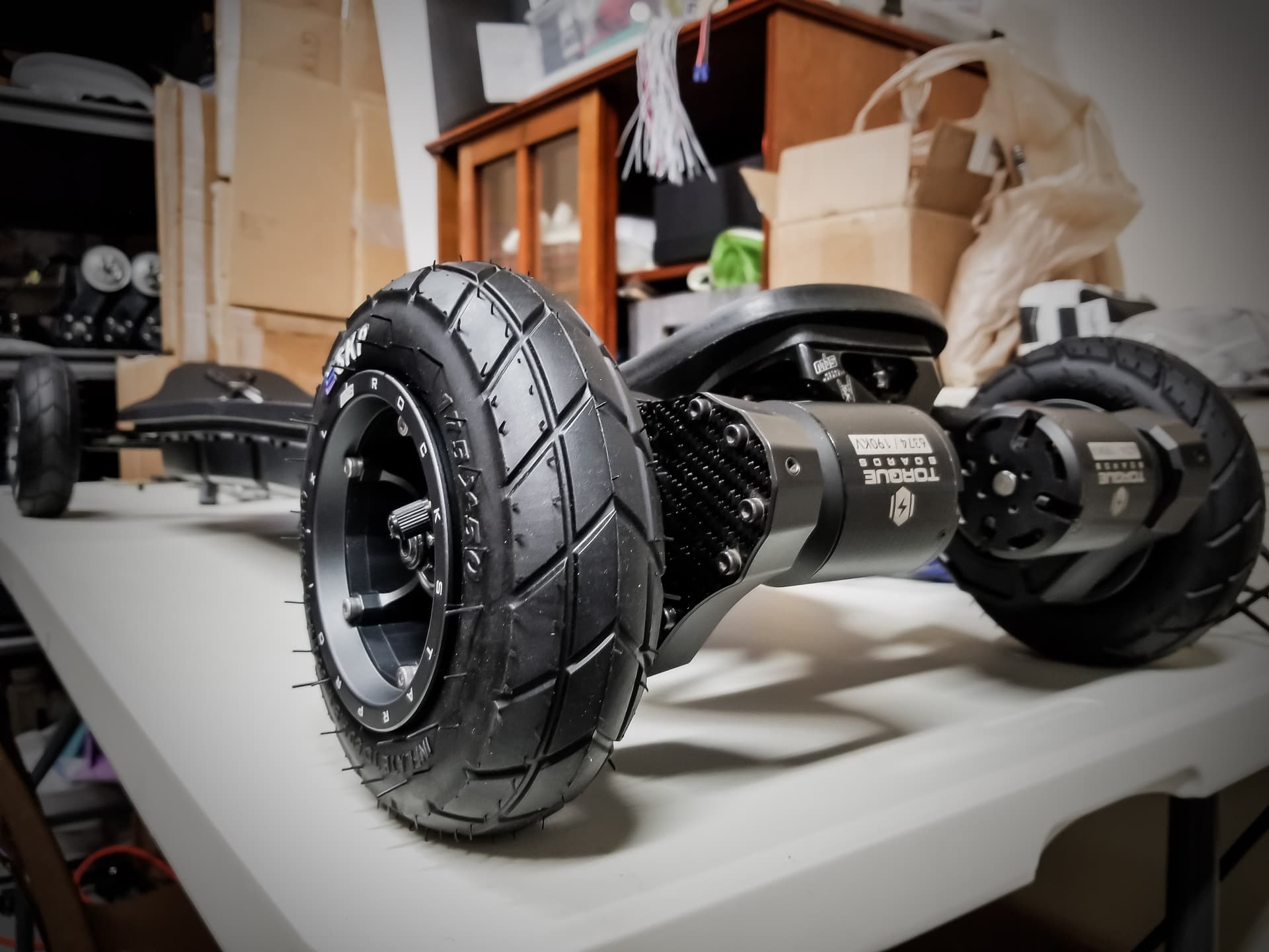

That thing looks dangerous :fire:
Tell me more about it!
