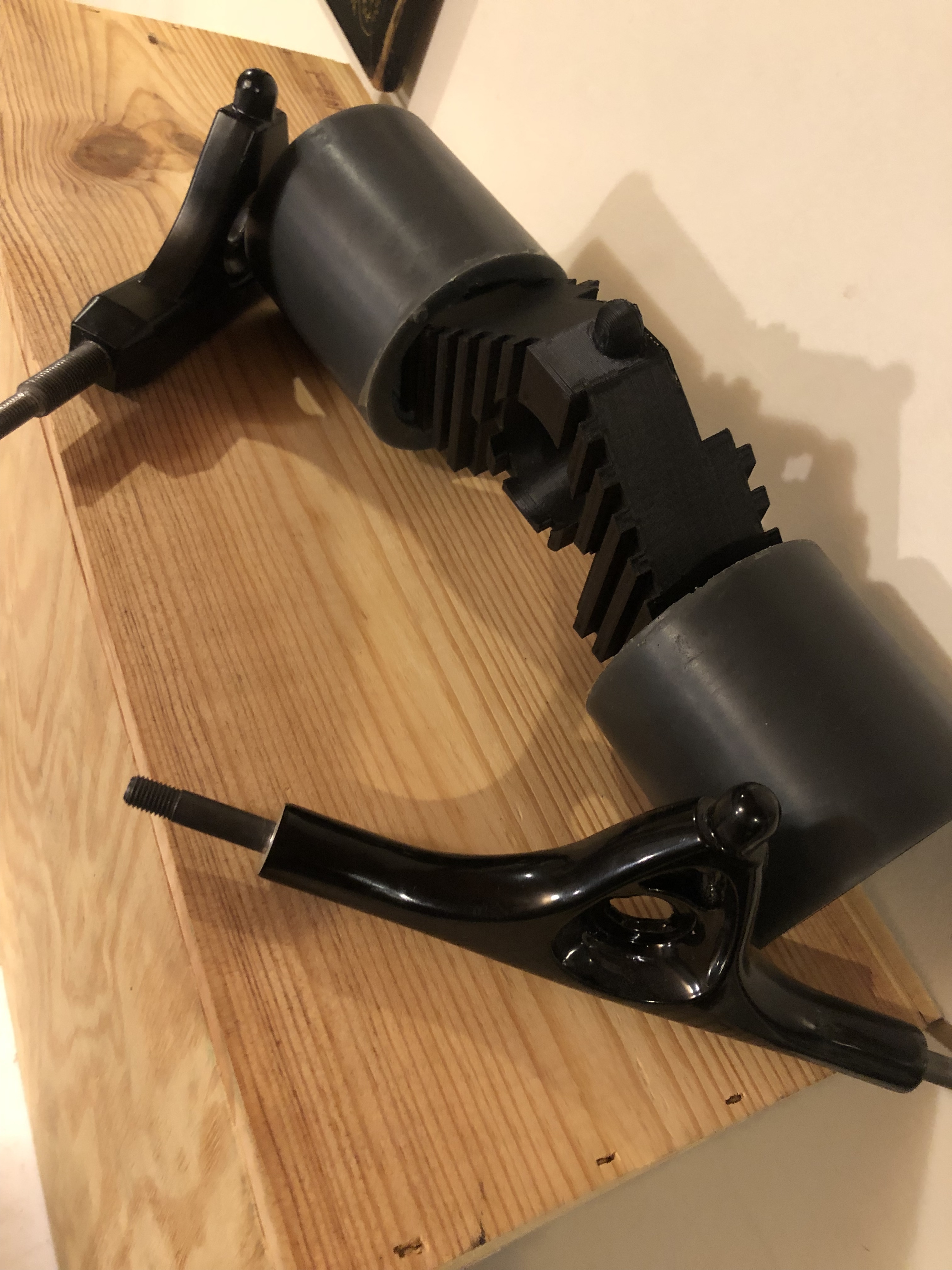

@Pedrodemio. I will get work on making it stronger there maybe but I think it can be misleading with the pics I posted and theres a big hole where there normally is a small 8 or 10mm axle… I could model a version of surfrodz or some other aluminum hanger and show the mass at the different lengths and I bet this is at least double nearing triple. I cant even find what type of aluminum they use. do they break ever? what other aluminum hangers have broken? silverfish longboarding is gone and maybe so is the info.
What is wrong with the 12mm axle?.. I was kinda hoping someone would make a narrow width hanger for the hubs to make a mini board lol

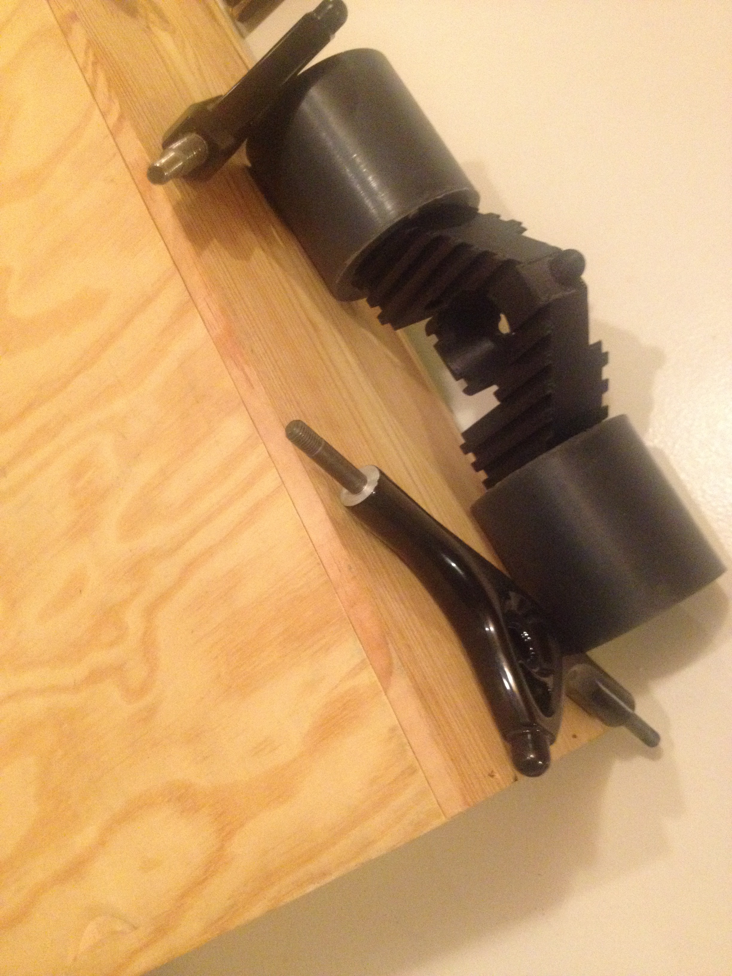

This print isn’t even what I showed modeled and it hangs way low but u can see the difference in size. nothing was wrong with the 12mm axle before other than it wasn’t precision straight and wasn’t near what this is for cooling. THAT is why do @Titoxd1000 this. this design maximizes space and in this age of cnc machining this is possible. it’s an advancement.

@Mobutusan this would be precision straight as apposed to cast. that’s the benefit of these machined aluminum hangers. cooling is kind of an extra.
