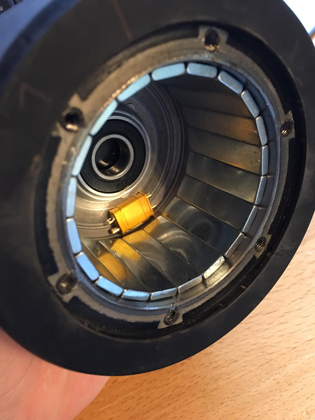

I still want to balance the hubs so I took them apart just to take a look. It seems like they have empty space at the end of the Hub motor to fit the bearing.
XT30 for Scale.
Now the question is What kind of glue should I use?
What’s the blue stuff you often see for balancing?
It looks similar to the torque stripe stuff I use at work but don’t think that’s as… sticky? Probably doesn’t have the weight required either tho maybe epoxy small wheel weights in there?

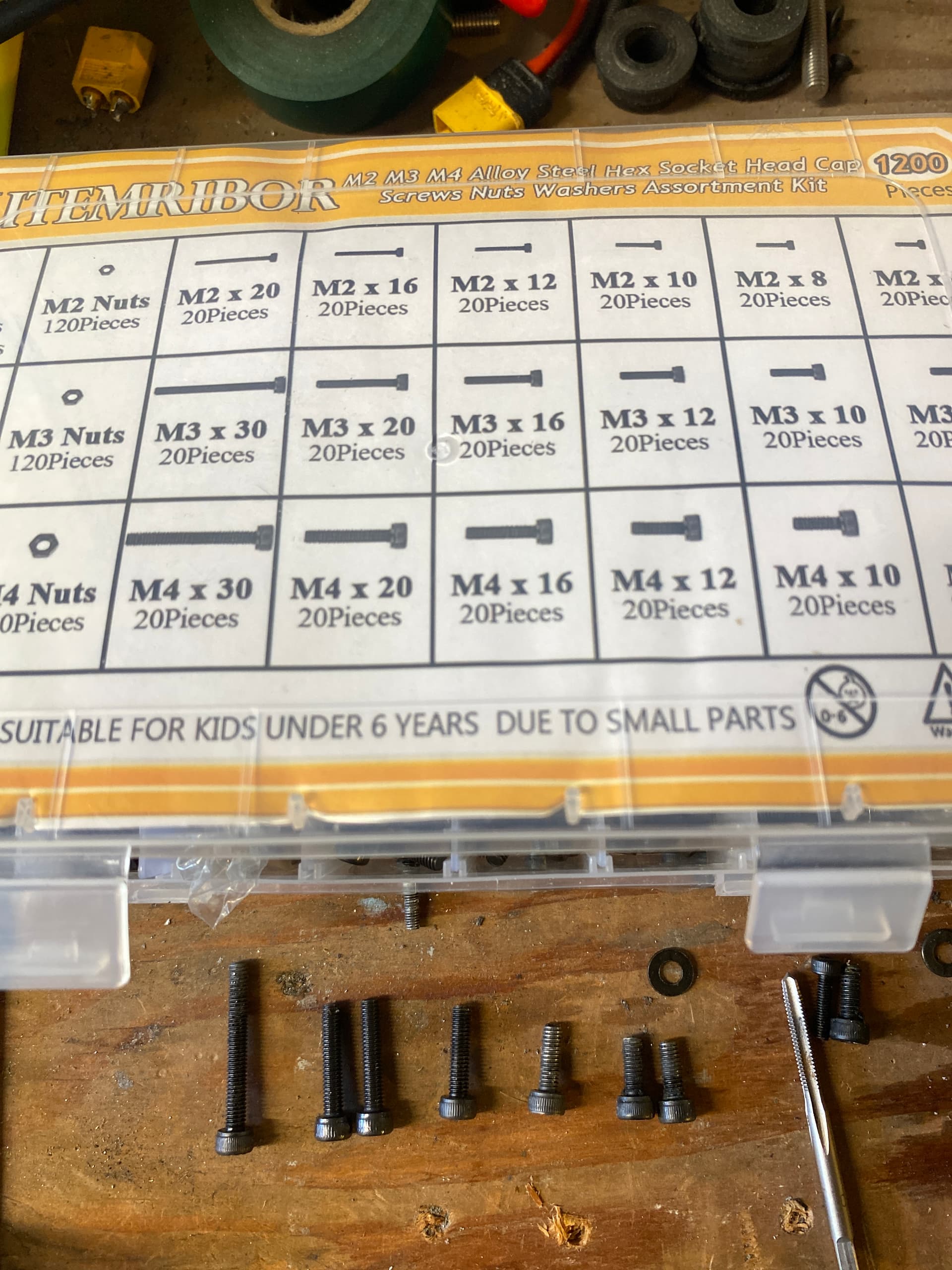

Was trying to find something to do while i wait on more parts because everything i touch turns to ash and i had a bad idea:
Find the spot for the weights and mark it, then replace the m4 or m2 screws with longer ones instead of adding weights. There is a limit to this as the existing holes are already drilled and tapped but i have a 3.4mm drill and m4 .7 tap from a previous repair.
You could also just add washers to a longer bolt but it doesn’t look as good, and opening and closing the hub every time seems like a bigger chore to me than drilling and tapping aluminum. Ymmv
So smooth
Didn’t know I wanted this but now that it’s done it makes me happy
So how did you balance them? Washers under the screw that holds the can?
Didn’t need to use washers, i was able to get 2 of them without tapping the hole (m4x16mm max). One i had to tap the hole deeper but it was already drilled. (M4x20mm) All of them seemed to be drilled through but i was limited by the taps i have.
I cant tap deeper than 20mm with what ive got and there is some sealer in the holes I needed to drill out a little bit. It could have been used to balance them at the factory but I just stuck with the plan. One of the wheels was really bad compared to the others and I replaced the two adjacent screws with longer ones too and that seemed to work.
You can see two of the 10mm screws I pulled out on the right vs the 16mm and 20mm replacements. Couldn’t use any of the 30mm i had
