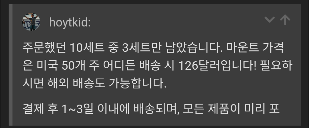

Is it still available for purchase?
Yes it is I still have 2 sets of motor mounts left shoot me a message
Jokes aside
@kangsoohong sorry but I believe he just recently sold the last set ( @hoytkid correct me if im wrong)
