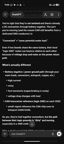

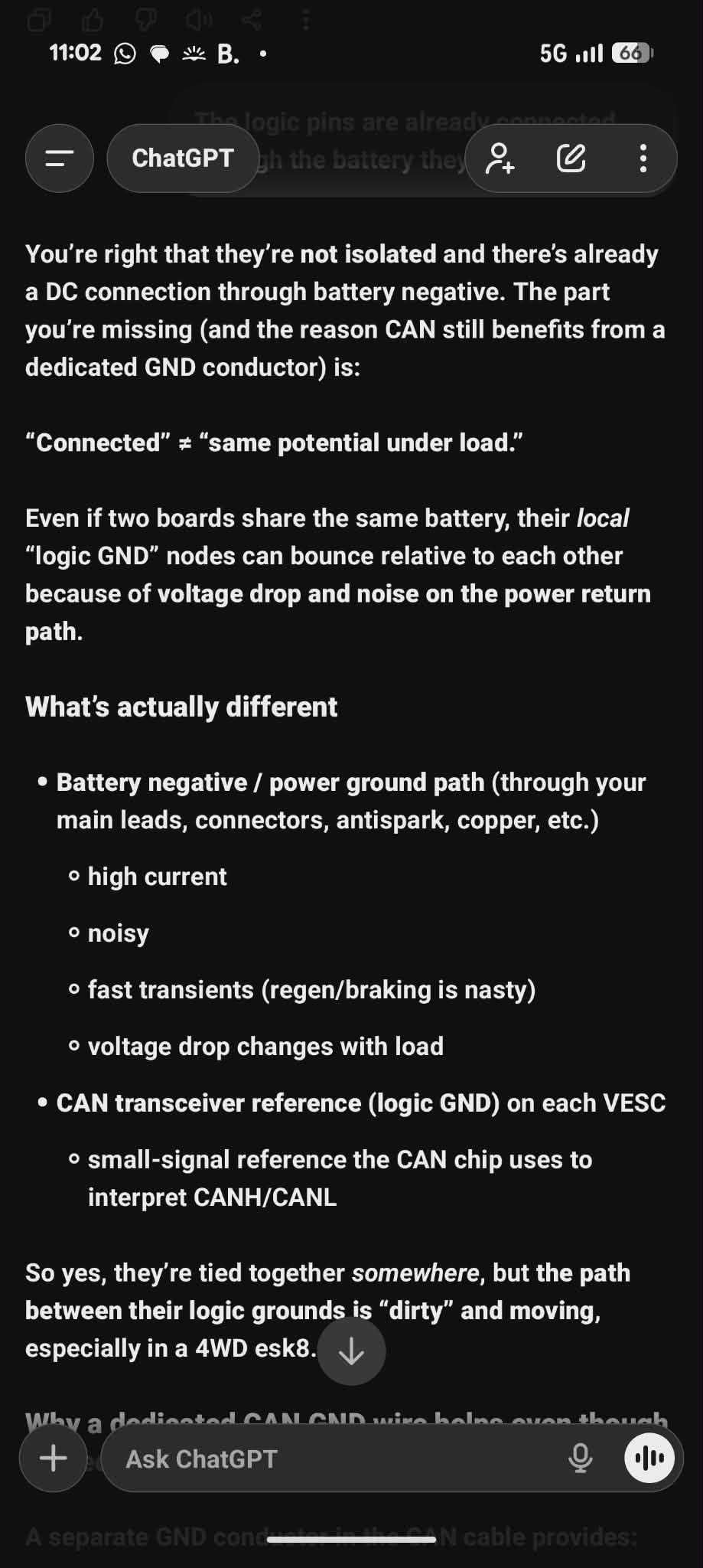

I know it’s been talked about before, but it’s been a while. Chat gpt is throwing spanners and I had enough weird experience with the hobbywing esc’s to cast some doubt.
Previously I just connected can h and l between esc’s and the ground to the shield of the cable on one end. I’m assuming that’s all everyone is still doing. However that setup lasted most of a year and then my board full throttled into a wall.

Cheers dude, I’ll check that video out. A lot of my lift gear communicates over can so I’ve experienced the reliability issues those can terms can create so that resistance check was definitely on the list. I figured there was something up with the ground loop theory when chat gpt was sticking to its guns.. I guess explains the issue I had with the hobbywing ppm split.
