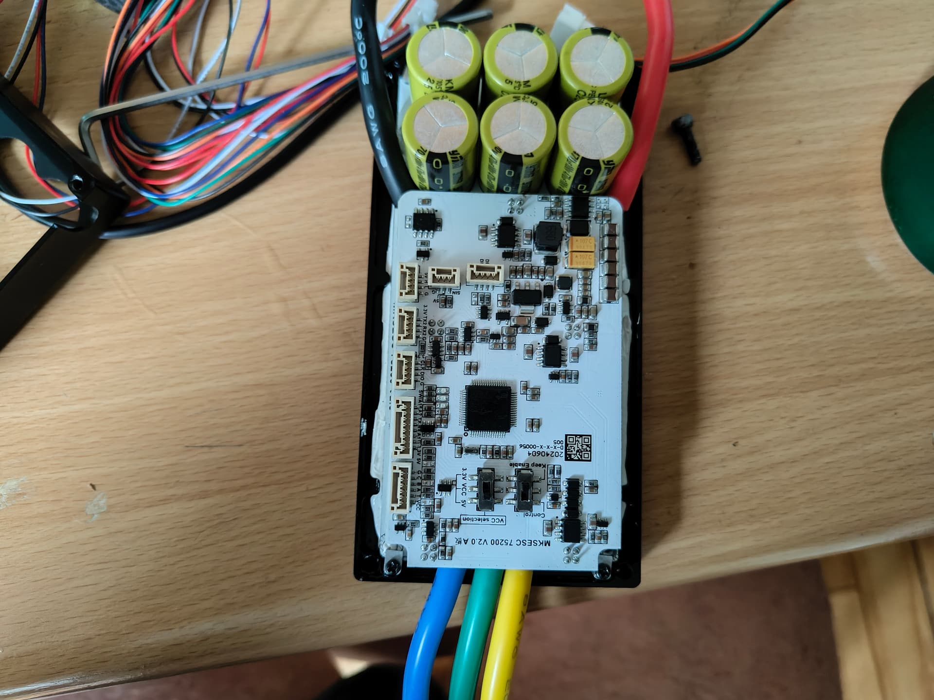

Upgraded makerbase 75200v2 linear 3.3v regulator for current sense amplifiers

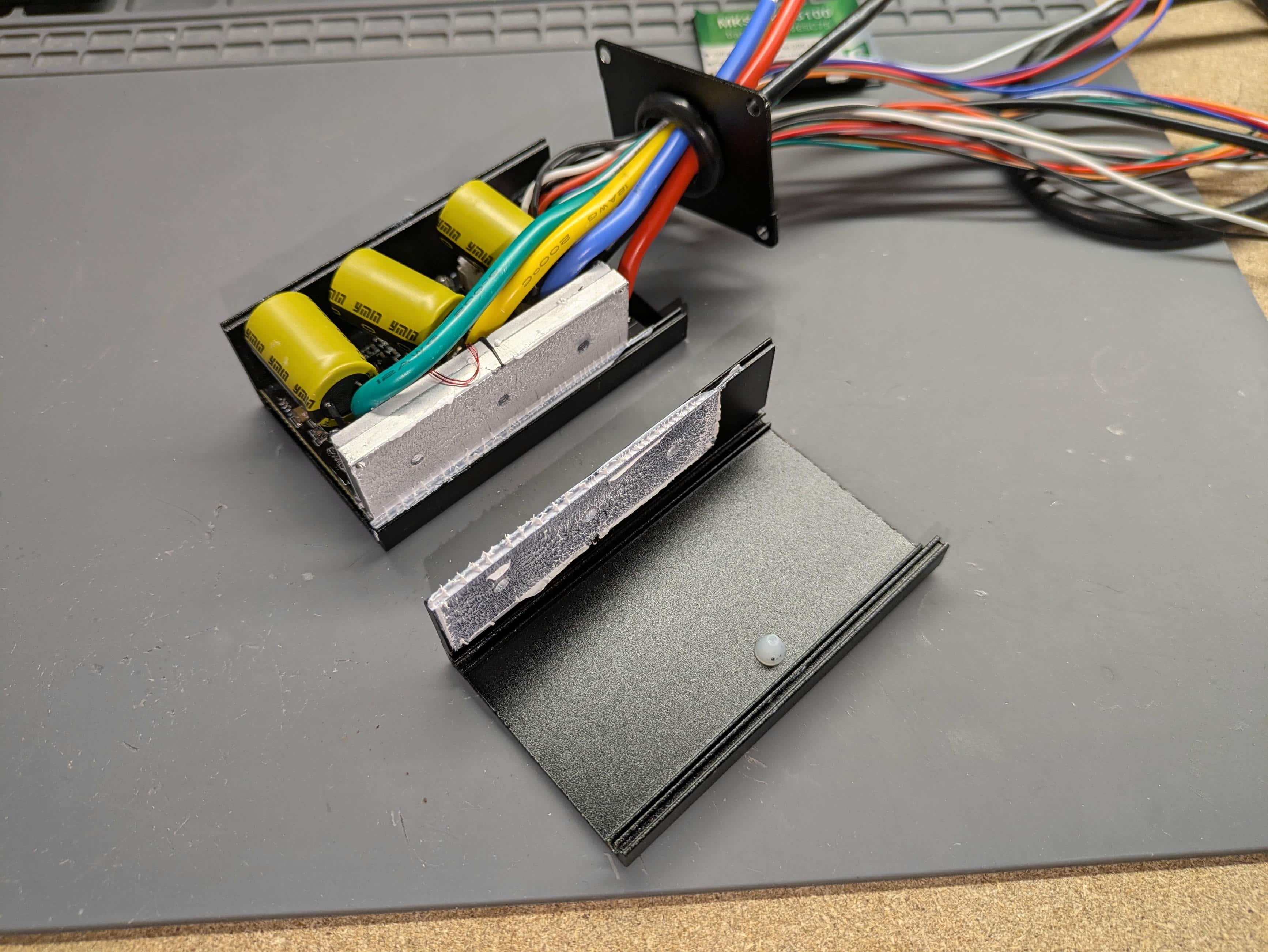

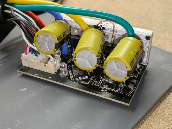

Hey, @reelism I’ve also just acquired an “MKSESC 75100” from AliExpress and am wondering what firmware your device came with from the factory? Mine came with “Fw: v6.02, Hw: MKSESC_75_100_OLD” and I am curious if you have had any other issues using the v6.05 firmware for the 75_100_V2 hardware? Also, it appears my board is a slightly different, maybe newer, revision of the PCB, images below.
EDIT: Check my reply below for an update on firmwares: How to update firmware on the Flipsky 75100 & 75200 FOC ESC - #454 by JdogAwesome
EDIT 2: Just ran a test with this ESC and I am very impressed! Pulling 2-3kW for ~2 minutes showed only a ~14C increase from 32C to a max of 46C. Video of the run here: https://www.youtube.com/watch?v=1ZvEmQOlLgg

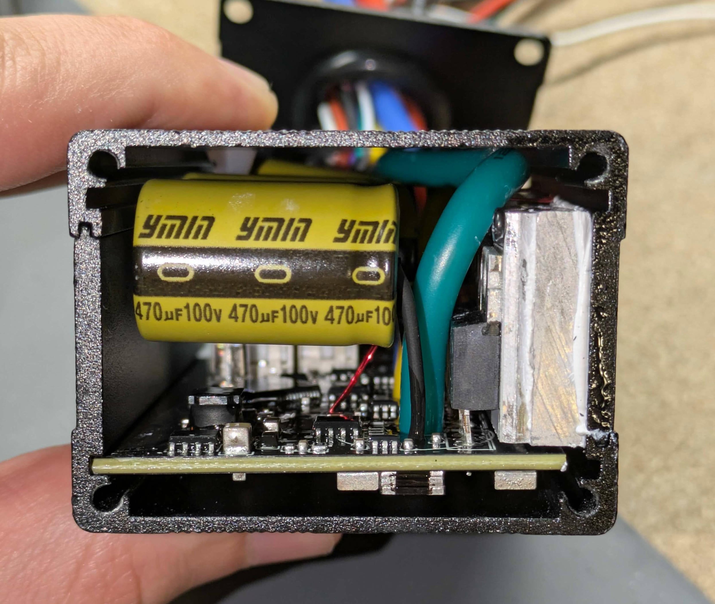

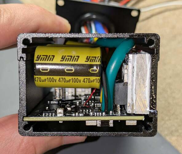

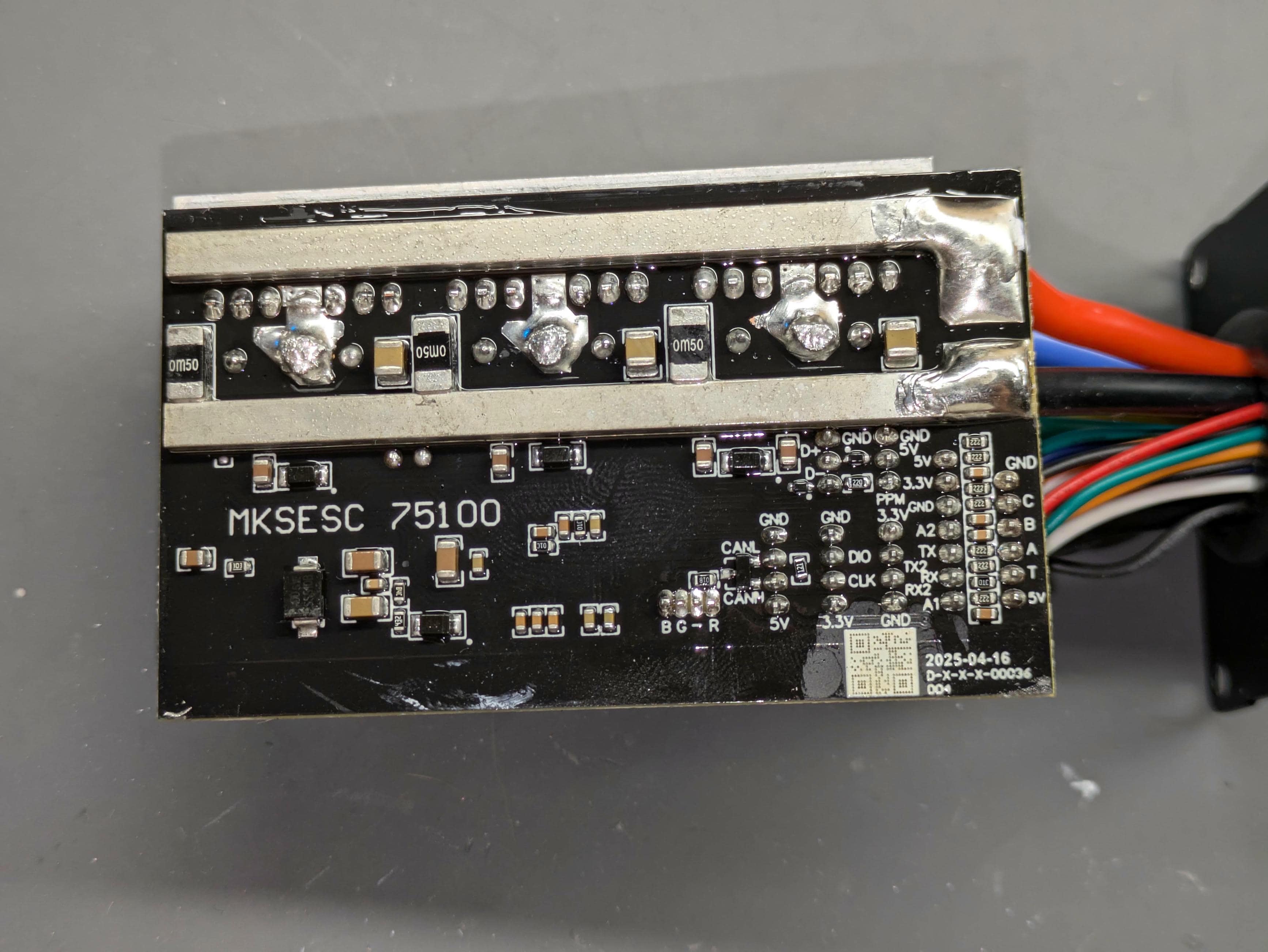

NOTE: I am happy to see the TO-220 FETs soldered to a thick aluminum PCB. I’d imagine this will provide much better thermal conductivity than the kapton insulators of the older Flipsky units. And nearly the entire top and bottom of the PCB is well conformal coated, another plus. However, these floating capacitors are crazy, probably going to design a brace for them, or epoxy pot the entire thing.
Additional Images Below:

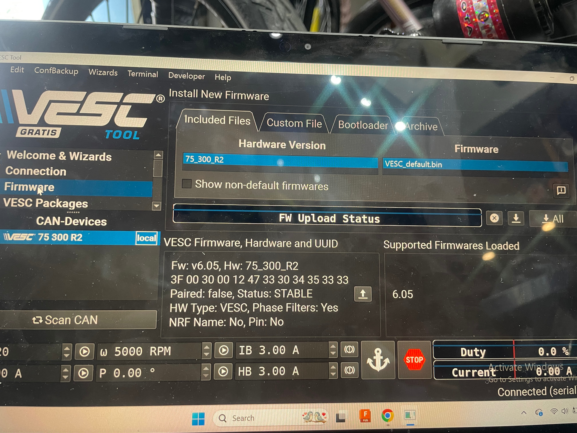

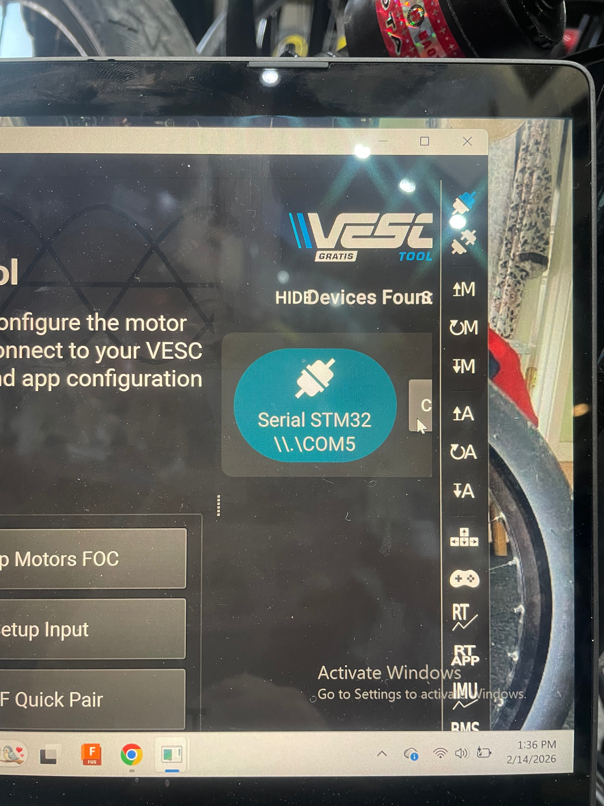

I’ve got a flipsky 75100 and shows hardware version 75_300_R2 and I want to add a firmware that works and does field weakening. Can I damage it downloading the wrong one?
I had it going on the bench with the original firmware, which was then the 75_300, then swapped to 6.05 firmware looking for field weakening, and now the vesc tool won’t let me do things and the motor fails foc test plus lots of other weird things I can’t do, although it looks to be spinning fine in the test.
And my vesc tool is problematic even though version 6 and have to keep going from whole screen to collapsing the screen to access button
I’m worried I already damaged hardware using the 6.03 firmware as it stutters badly with any throttle, but encouragingly it does run smooth during foc test even though fails
I’ve successfully used the firmware from this thread on my 75100s - haven’t tried field weakening though so I can’t vouch for how well that works but they’ve been stable.
Did you try the V2 firmware (or other appropriate version) from the top post yet? Which hardware variant is your 75100?
I have managed so far to avoid damaging a VESC with my firmware mistakes but from what I’ve read on here it makes sense that it can happen if the system is run with the wrong firmware on the VESC - so could be possible in this case but hopefully not.
This is a 75100 v2 with the 75300 hardware. It doesn’t really have the hardware but showing it does in the firmware tab.
At this point I’d take any firmware to just get it going and I can search for field weakening later. I forget what it had and don’t want to be guessing.
If it’s the 75100 V2 with the aluminum PCB you should follow the the guide/links on the top post and do a custom install of the Firmware v6.00 Hw:75_100_V2 (I used the regular version since I’m not looking to push too hard but there is the no_hw_limits variant as well). Make sure it’s the right one from the pictures up there.
Then you can upgrade it to 6.05 from there with the normal integrated process in VESC tool.
The 75_300_R2 it shows you have currently is exactly what this guide is about replacing so should be a pretty turnkey process. It’s the same one I did as well - basically the R2 line of firmware these Flipsky ESCs ship with is not matched to the actual HW features and you’re moving over to the custom version @jaykup made that is.
One thing that could kill a vesc is if you use a HW without HW filters and don‘t switch them off in the config. 75300v2 has hw filters, hence it is supported by the FW and possibly set to on. If the cn manufacturer would do a proper job, he would submit a PR to vedder with proper HW definition of the vesc and not just use a halfway compatible binary from a different HW.
