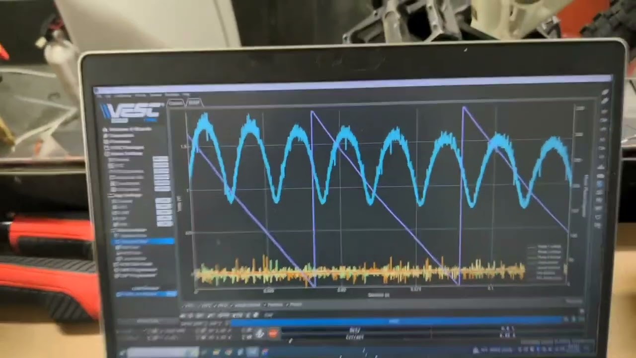

heres the results, night and day. Amazing.
default firmware
The sample firmware posted above. this is after motor and hall detection only and zero tweaking yet, other than flux linkage, as detection set it at 100mwb for some reason. i set it at 21mwb and here is the result. keep in mind i had the samples set a bit high so it looks rougher than it would normally, i didnt feel like re recording another run.

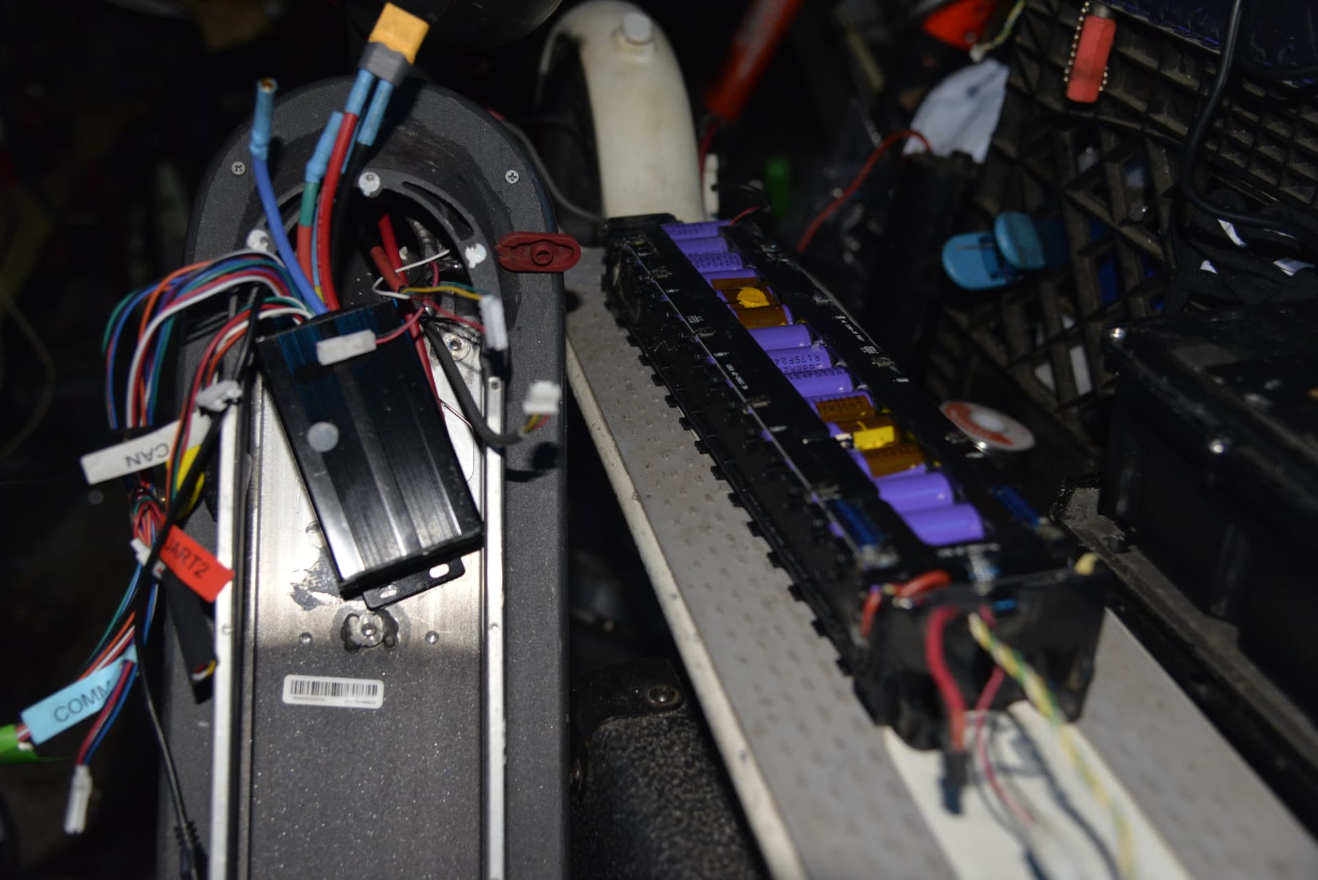

the 75100 in my m365 using sensorless bldc sounds like an f1 car… wtf :rofl:

I can’t get the same detection results twice with mine when I ran through the foc wizard with my ninebot max and a xiaomi m365… but atleast it sounds cool. :thinking:

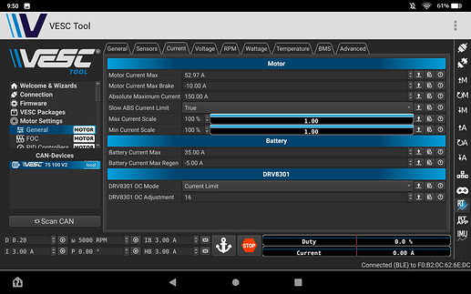

the resistance and inductance detection values go up and down and all around. under load trying to ride it just for shits and giggles in sensored foc it stutters nd bucks like hell but sensored bldc runs like a MFer.

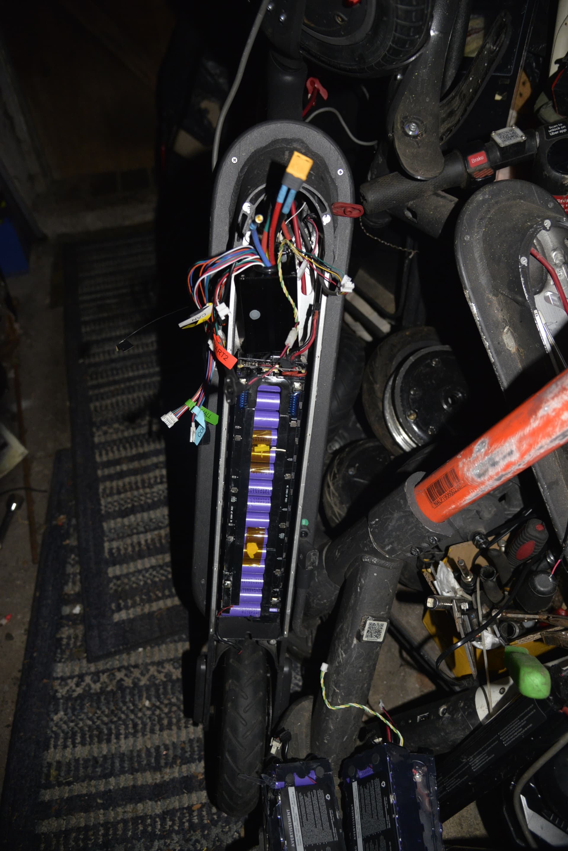

hardware is makerbase 75100v2 box with the fw 6.0 from the top of this thread.
here’s what it’s running…

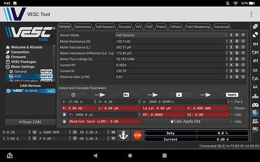

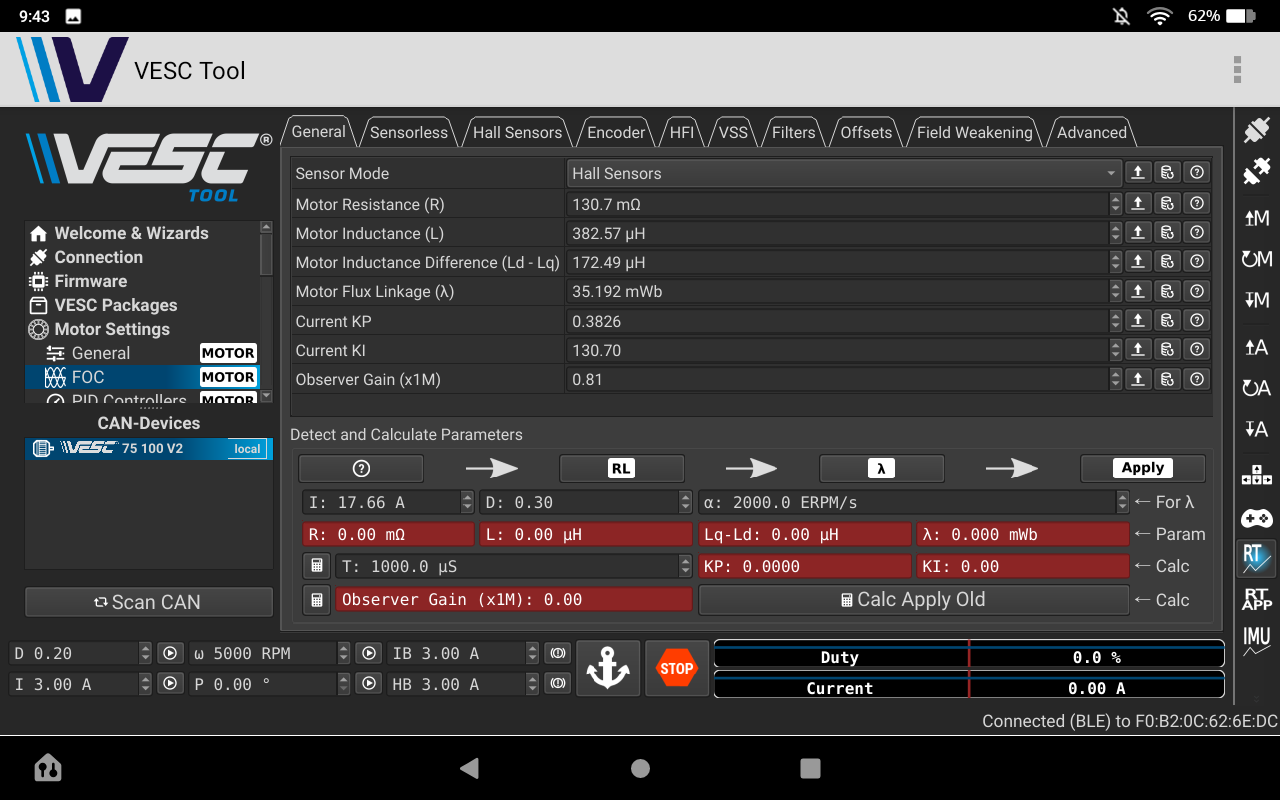

Can you take some screenshots of the motor detection using the 2kg outrunner and any other settings you change after reseting defaults. Does it detect halls and it’s running with those at low rpms?
Do you have the ability to measure motor resistance and inductance manually to compare?
If the detected values are bad it won’t run FOC right. You can also do manual detections on the FOC tab and play with current / time constants to see if you get something that works.

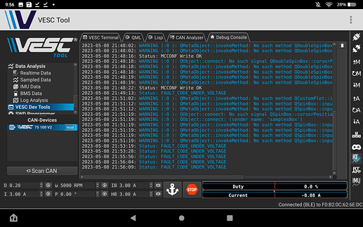

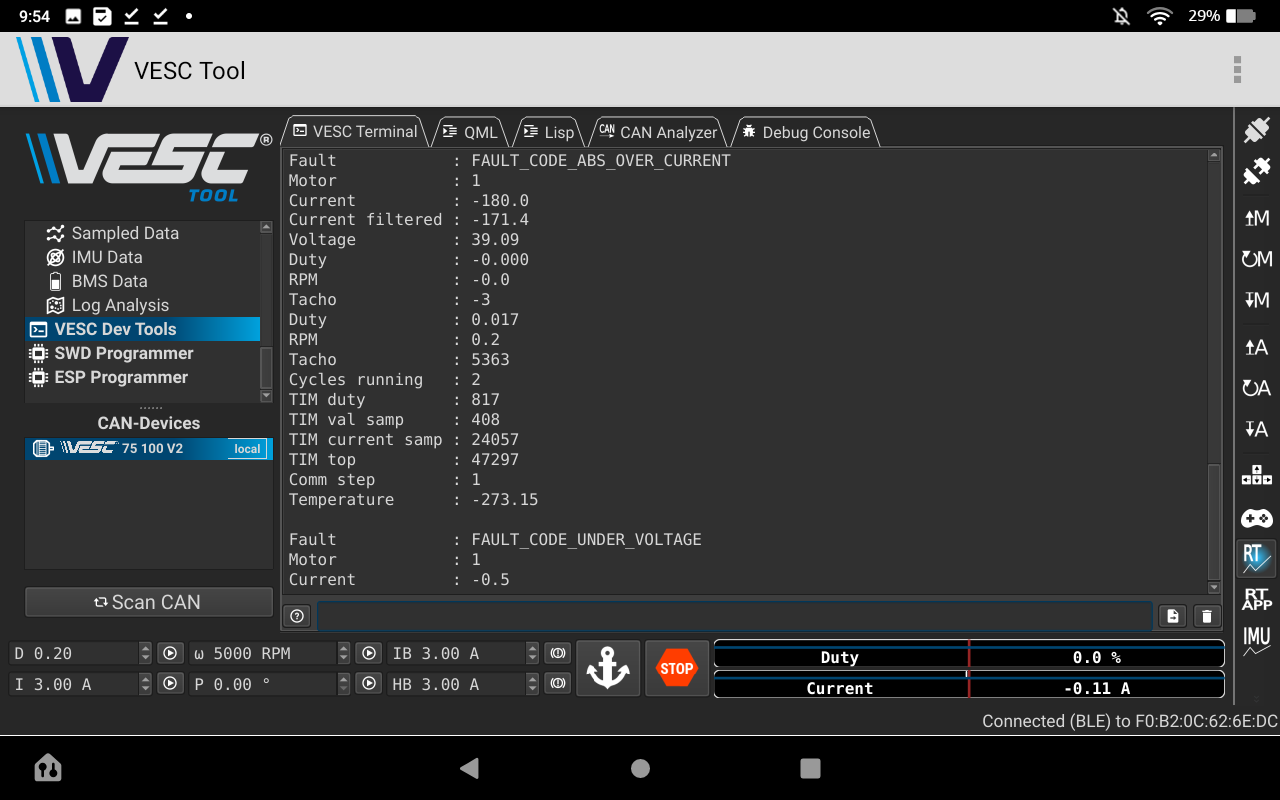

i keep getting these transient under voltage and over current faults, went through all my connection points and wiring thoroughly but it’s legit.
