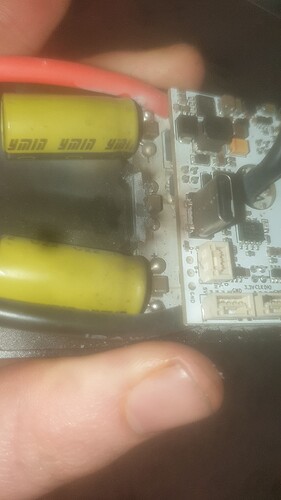

To add on that, it really seems like i might’ve desoldered a phase shunt by the current somewhere?
it measures about 166k between each phase on the vescs themselves, although i still get abs overcurrent errors on one vesc while it surely isn’t doing that much power, while cutting out rapidly, both on regen and on acceleration, swapping the motors still the same thing while without a load it’s an absolute non-issue, runs smooth as hell, i just suppose one or more of the shunt resistors desoldered themselves somewhere then, as that would “amplify” the measured current although i haven’t checked that yet, i’ve noticed Ld-Lq measurement is double on that specific controller aswell. and it triggers abs overcurrent at 180A while it’s definitely not putting that much power into the motor now
another thing is that the motor phases seem completely fine aswell
other than that everything seems fine.
i guess i’ll have to open er up and hope nothing serious broke

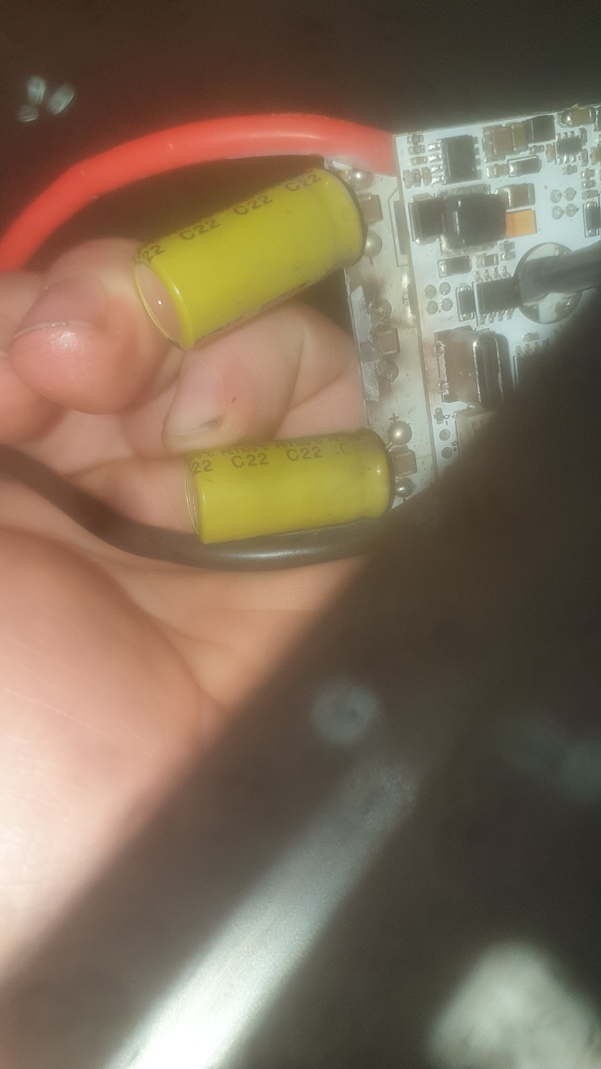

You can call me impressed, left cap has a broken leg and middle cap literally desoldered, it seems like the PCB is damaged tho? i didnt probe it yet, i hope thats not significant… ohh well :joy:
Seems like it’s still smoky in there from your incident
Oh, so you have the new version. I was confused because there are two versions of the original controller that’s in the generic metal box. Shouldn’t make a difference though as the design is similar, it just uses SMD FETs which makes for a much better thermal design.
The detached capacitor is really no surprise. Flipskys 4.20 mini has a crap design where the cap easily breaks off a tiny solder pad. Would it make a difference in performance? I’m sure it would but not sure if it would cause the symptoms your describing.
na, thats just the effect of an S9+ which had the camera glass lens cover broken for like 2 years :joy:
on the other hand there’s no real damage other than the caps it seems (on the first look), i dunno if all caps should be fully in parallel on the positive and negative rails, if they should be the traces are broken aswell (i sure hope not)
the least that’ll need to surely happen is the one with the broken leg replaced, the other 2 caps measure within spec (320 ish uF on my Fluke dmm), and actually the other broken one does too but i don’t trust a cap with such a short leg lol, inb4 it shorts one day
on the other hand idk if this one had silicon sealant over the caps as a sort of protection, the other 75100 alu pcb does
It definitely needs enough filtering, 990uF atleast and i think i overtaxed the caps which broke the controller, hopefully no real pcb damage but oh well
Yeah, they are in parallel
Ok then i’ve got broken traces, no doubt, rip, albeit it gives me the option to try and add larger filter caps outside of the case aswell :thinking:
or just a new alu pcb
damn shame, they were so nice and they never even got very warm, but when you push your luck stuff is about to go wrong :confused:
I don’t think it’s your fault, a cap is the last thing I would expected to blow. Looks more like something shorted between the caps legs. Maybe one leg detached creating a intermittent connection?
I did that with a FS 4.20 mini. Just make sure to keep as close as possible to the ESC. Pay attention to the caps ESR. Going to want low ESR caps
yup, if it aint low esr it cant help with the high current and high speed peaks, and i wouldn’t want it too far to reduce inductance, i think i just got a gigantic peak that the caps and traces couldn’t take, albeit the caps still measure normal values otherwise

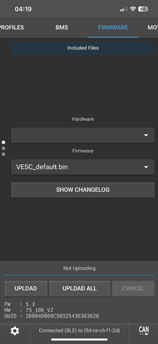

Hey quick question guys
I have flipsky 71500 202
Hw : 75_100_V2 it is corrent ?
But in app says :
It is ok ?
Regards
