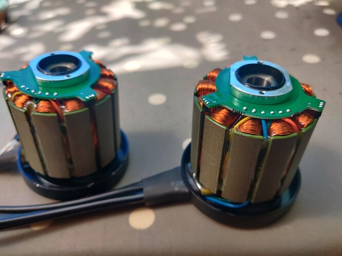

This is usually caused by poor routing of the sensor wires by the motor manufacturer, such as having the GND and TEMP wires not parallel to each other and instead each going through a individual slot on the stator, this makes a huge induction looks and the motor spinning causes lot of spikes in the temperature reading
When you are near the temperature limits, this makes it jump up and down and get into the hard cutoff limits
I never understood how manufacturers thought that cables below spinning magnets are a good idea, especially when they use more than one slot for routing.
Yeah, makes way more sense to be on the front of the motor, but I guess it’s harder to manufacture
A lot of motors don’t use a support bearing and it would be easy to place the PCB in the front. Even on those designs I have seen PCBs in the back with wires in the slots.

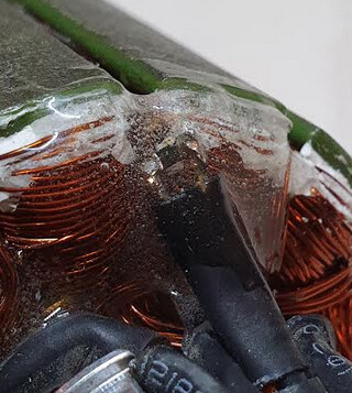

A guide as to where to stick the temp sensors would be dope. I’d love to revive old motors with broken sensors to use as my winter motors.
Just glue it directly to the windings with some epoxi. Ideally in the front of the motor.
The front is where the phase wires come out?
10KNTC
I think that’s a yes?
yes

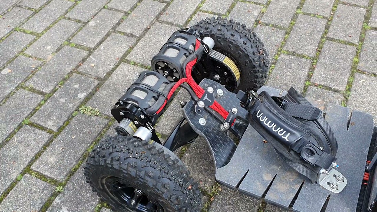

Yes I have tried it out and it wasn’t working great. But I also don’t have hardware with phase filters to compare with. That’s why I was asking for a video showing hardware with phase filters running ASS a lot better.
The Trampa motors are the only ones I have with a temp sensor and they are broken.
VESC HD 60T with 160KV 6376 motors.
Thanks for the video. :+1:
Looks like it is working well. I hear some HFI bleeps when you were rolling backwards but the motors were spinning slowly. Is there some range from 0 to X rpm where it is used for tracking, because from what you said I was only expecting it at 0 rpm?
