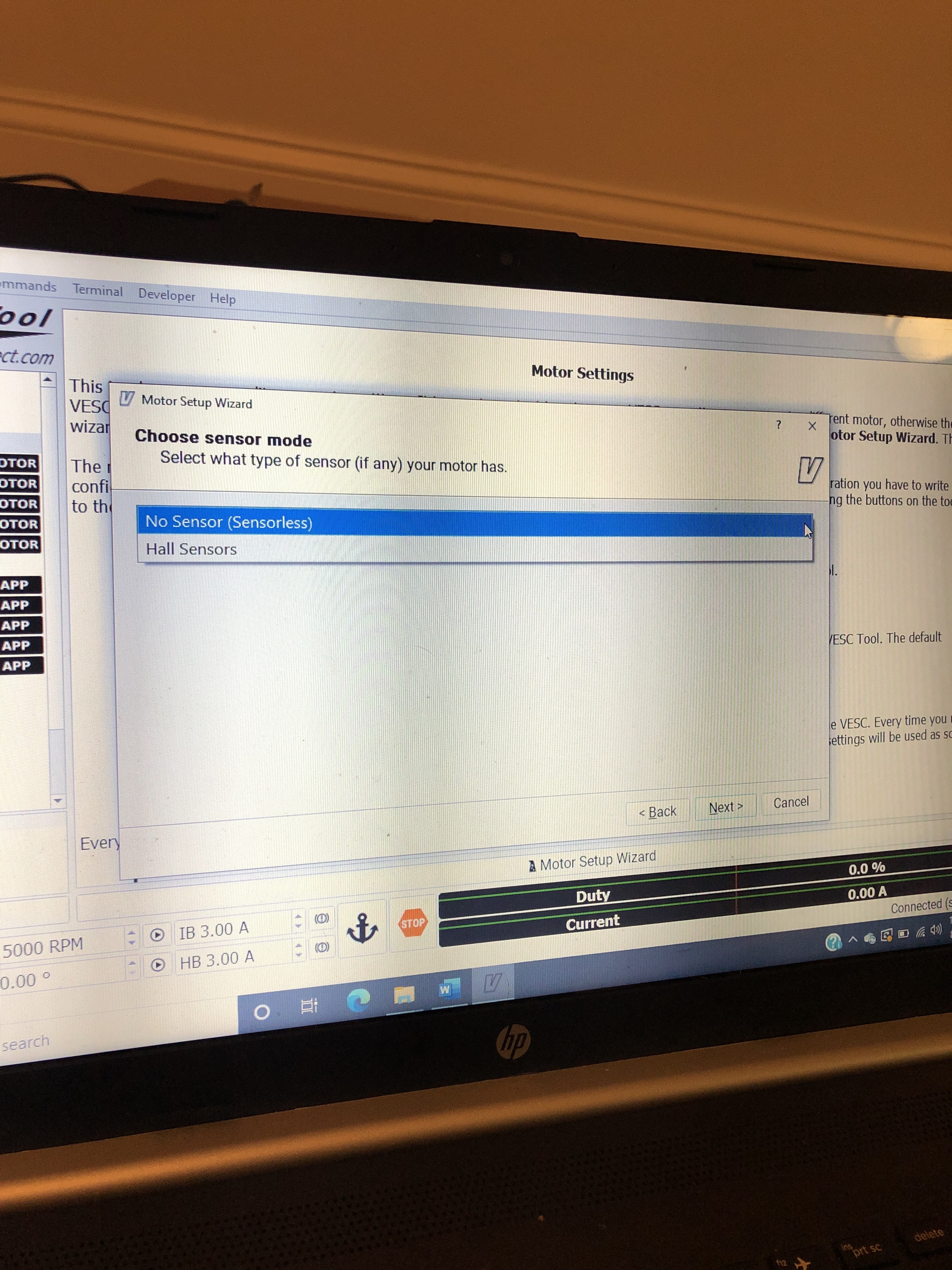

When I setup the motor On the side the usb is connected will spin that one only
When you did the motor setup wizard did you select the CAN setup option?
Also using a mini remote with one receiver
I do not think so
If you select the CAN setup option (there should be two buttons I believe) it should setup both motors, or throw an error if it can’t
I went back through the motor wizard and do not see a can setup option . Do you know what page it would be on?
Take a screenshot of the page right before you click the detect button
