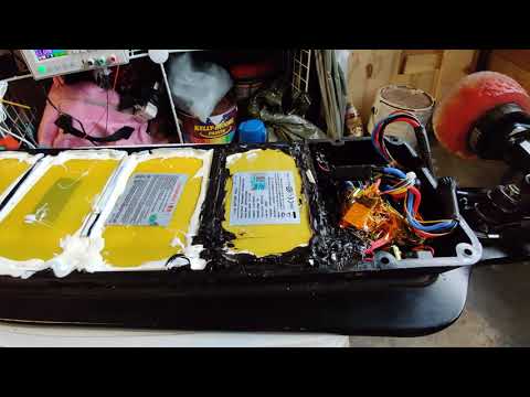

Recently my Ownboard Bamboo AT started not powering on. I thought battery died but upon closer inspection I found it was a simple BMS failure and fixed it easily.
If you have a bamboo board and your board doesn’t power up, this could be the fix you can do. Just sharing since I have heard many people having problems with Ownboard battery.
Update:. It seems clear to me now that the BMS Failure is caused by the USB module:

The USB module is fine. The reason you were getting 9V when it was plugged in is the same reason the esc wouldn’t power on when you then plugged it in without the usb port. The USB port is has no way to power off and was putting just enough drain on the battery to cause the BMS to fault.

Yes it does. I am doing another Ownboard BMS repair, bypassing BMS is recommended if using vesc with it so you don’t trip BMS
Agreed. I dont know what’s happening to the bms frankly but it faults at the slightest current draw and prevents the board from turning on. If this happens mid ride, pretty high chance youre going to a slide. While it’s potentially not the safest choice in terms of battery health bypass discharge its generally considered safer for the rider since you are eliminating a fail point in the system.
With the 3 ownboard packs I’ve personally removed and replaced all the cells were still in good balance the 2 packs were newer, less than 100mi, and had a very small voltage difference between cells. I’m pretty sure the failure on the bms is in the discharging circuit although I can’t confirm that.
Yeah most likely discharging circuit is faulty somehow and cannot handle the current.
I finally figured it out guys, Ownboard BMS is not bad the problem is actually the USB module that shorts and causes BMS to fail. Because my BMS failed without an explanation as I don’t abuse it or anything like that.
But after putting new BMS in Ownboard, it STILL WOULDNT CHARGE I WAS LIKE WTF. Getting zero volts out of charge port.
So I opened the board and disconnected the USB module connection and voila! Now it charges fine.
The USB module I believe can short very easily from any kind of moisture that gets into it. I let Ownboard know and they will probably fix it
But if you have an Ownboard Bamboo definitely disconnect the USB module as it will ultimately cause your BMS to fail.

Just want to say same thing happened to me, I was using the skate on a rainy day and suddenly the board turned off. When I tried to charge it, it wasn’t working. I found this post, unplugged the USB charging port, unplugged the battery, replugged the battery and it turned on again.
