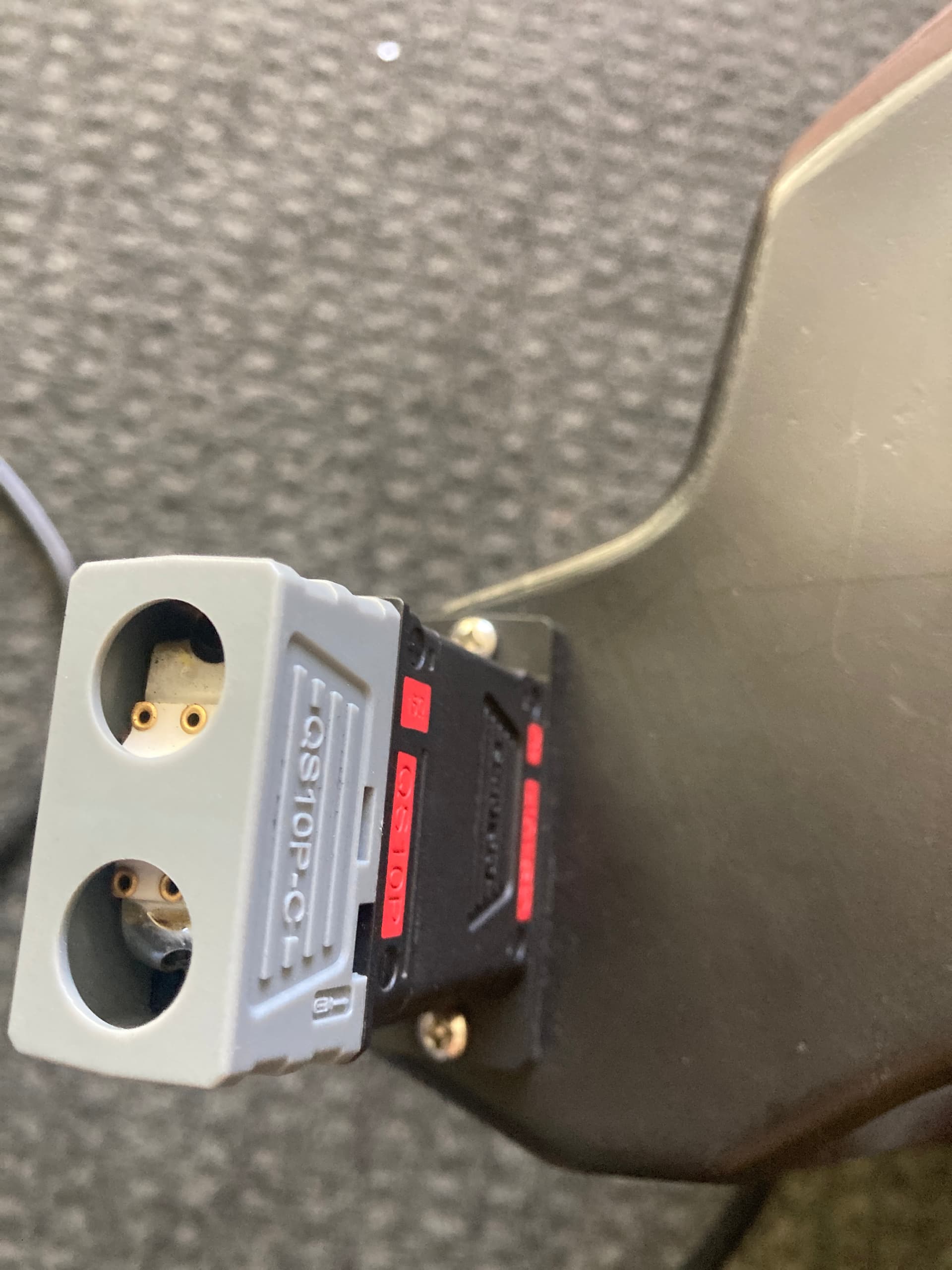

Custom 50ohm QS10 loopkey with imbedded 300 amp fuse (label says 15ohm but really 50)
Bigger than needed for a board in physical size but for high voltage the high resistance is a must. I still have lots of custom made QS8 (non-panel mount) with higher resistors as well I’m selling for my cost.
