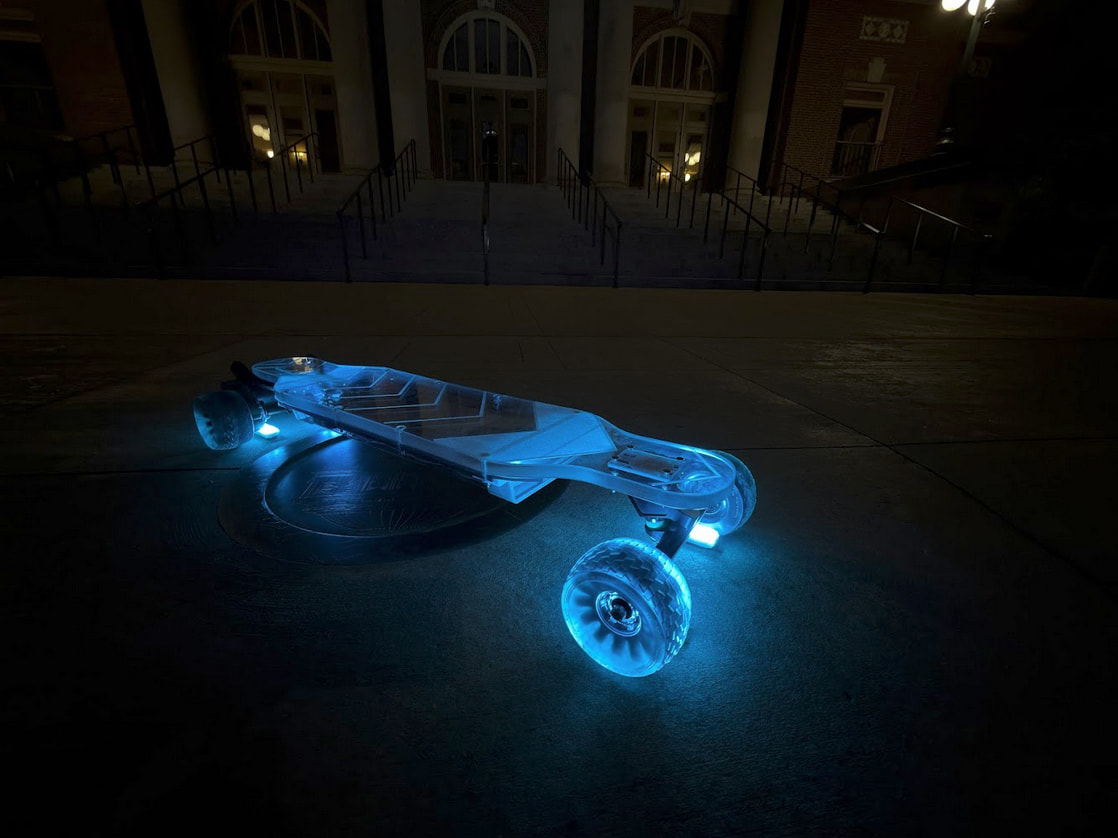

The name is Honmoon. Honni for short.
For those of you who haven’t watched KPop Demon Hunters (go watch it), the Honmoon is basically a magical translucent barrier that the hunters maintain to protect the human world from demons. A semi-transparent shield with hints of rainbow tints. I thought it fit perfectly. My board is literally transparent, and it represents like 4 years of me slowly building up to actually pulling this off. The barrier in the show gets broken down and rebuilt stronger over time, much like the process I went through with this build. The LEDs inside also tie into the rainbow-ish colors of the Honmoon. I might be butchering the lore slightly, but you get the idea.

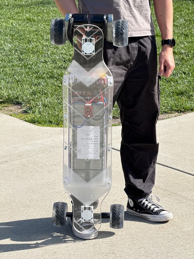

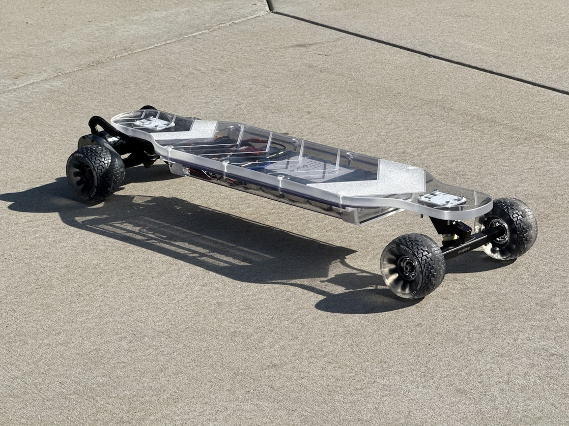

Deck: 40" Plat Chev Ghost Boards Deck (¾" acrylic)
Trucks: Old Scrap Evolve Trucks
Wheels: 120mm Cloudwheels (1st gen - fight me)
Battery: MBoards 12s3p Molicel P42A Pack (pre-PCB)
Motors: Two 6368 140KV Flipsky Motors
Drivetrain: Omni Esk8 Cruiser Gear Drive Kit, 15:20:40
ESC: MakerX DV6s
Remote: GB Engineering Remote Lite (previously Hoyt Puck 2.0)

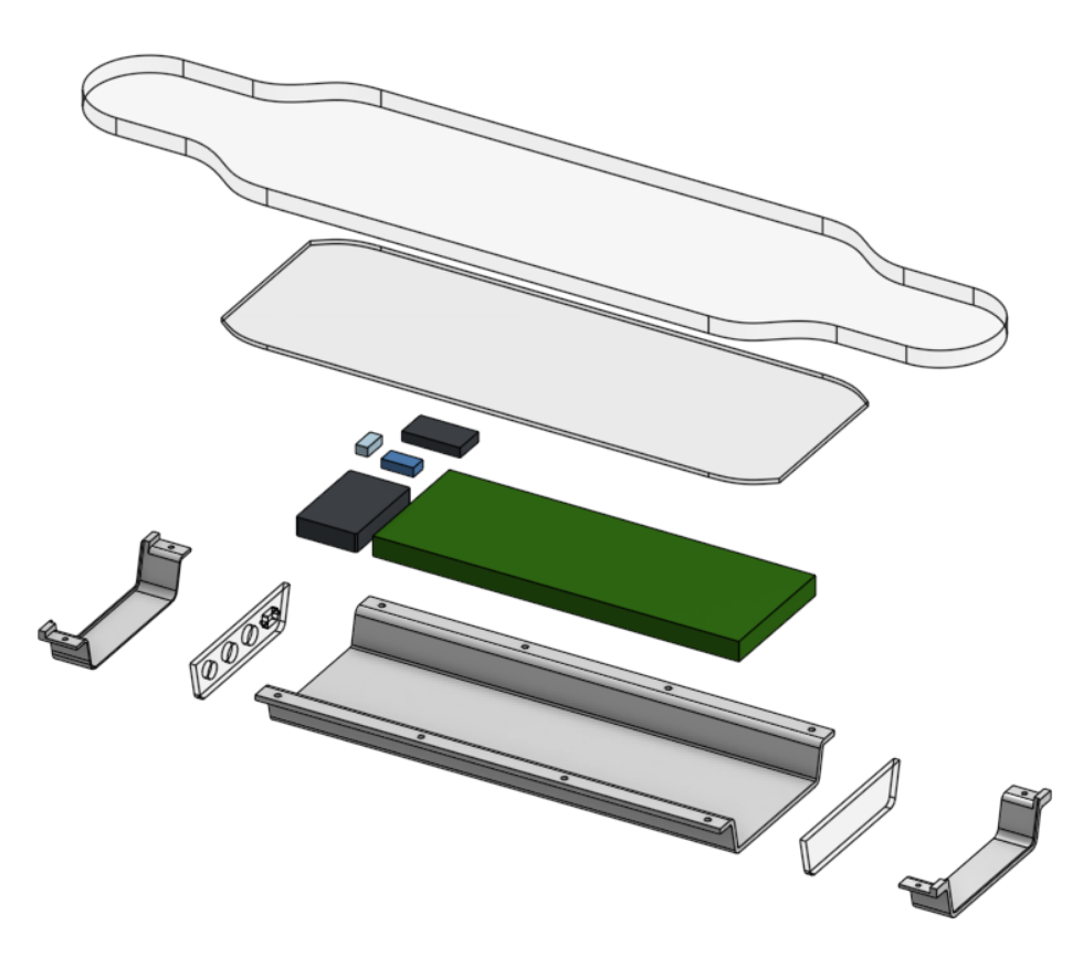

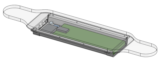

Enclosure: Custom-designed polycarbonate enclosure manufactured by SendCutSend

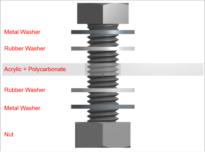

MISC: ⅛" polycarbonate sheet for deck reinforcement, clear PETG 3D printed band for enclosure cap, ¼" laser cut acrylic for enclosure caps, clear-ish griptape, white ⅛" riser pads, rubber + metal washers on every screw to keep stress off the polycarbonate, ⅛” polycarbonate for the Omni-eskate gear drive front panel replacement, LED light strips, blood, sweat, and tears. I am not joking about the blood part; I got a nosebleed once while working on this board and just kept going.
SPECS
  • Board Weight: 26.8 lbs
  • Range: ~30 miles
  • Top Speed: ~32 mph
These are calculator values and haven’t been tested yet.

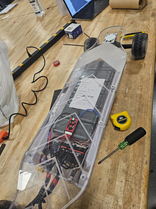

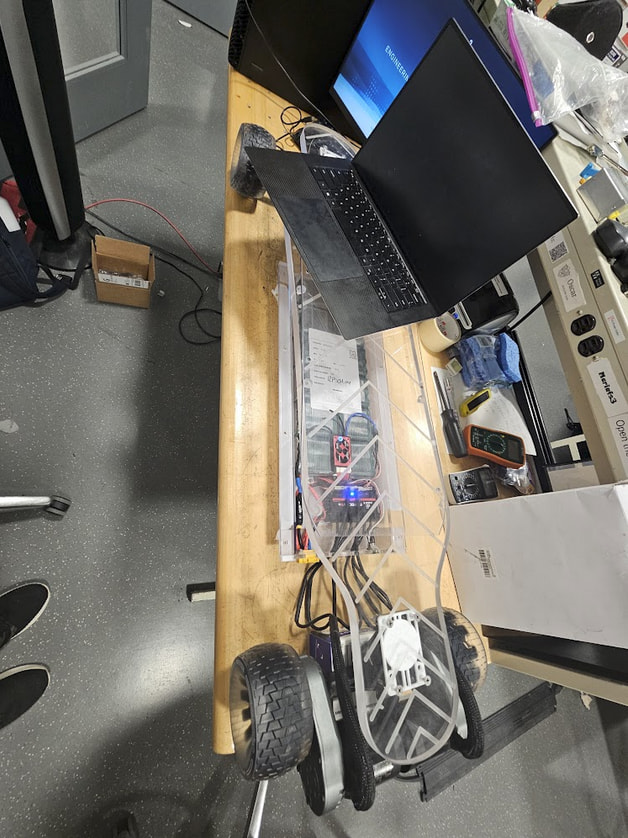

I am genuinely terrible at taking progress pics, so most of what you see here is thanks to my friend Leo, who graciously took photos while I was working in the lab.

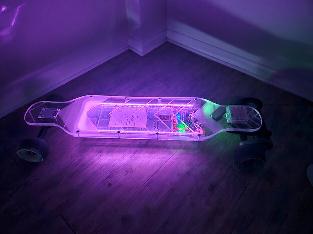

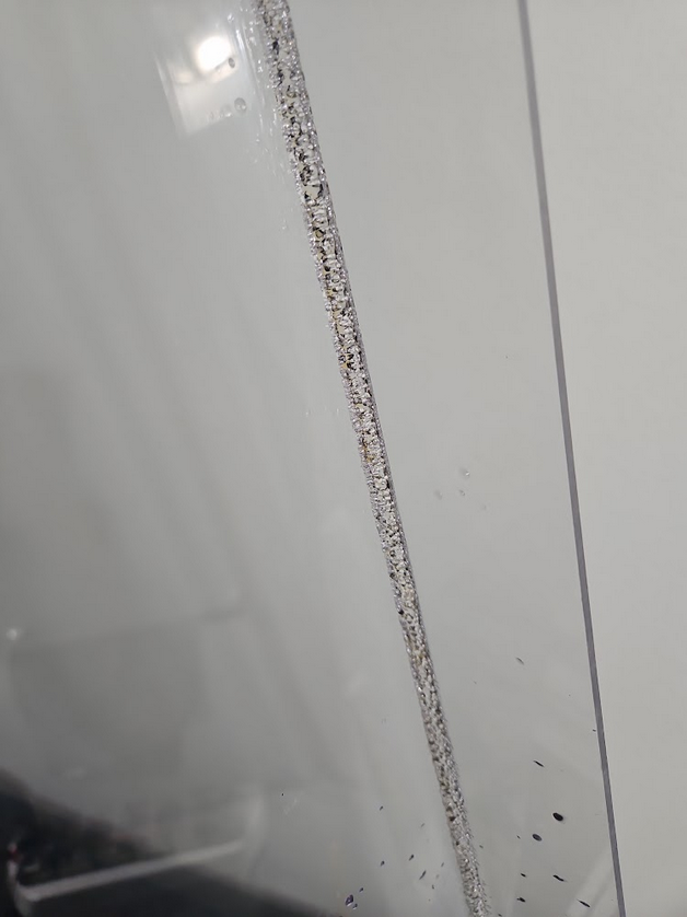

My initial plan was to heat and bend a sheet of polycarbonate myself for the enclosure. I failed miserably (like, genuinely embarrassingly bad). If polycarbonate is not hot enough, you just can’t bend it, but if it gets too hot, it starts to melt the polycarbonate and makes bubbles in the material itself. Bubbles in polycarbonate give it internal stress points. So I sent it out to SendCutSend and had them professionally cut and bend it instead. The silver lining is that I reused the failed sheet as a bottom reinforcement panel for the deck, which actually worked out great and gave the deck way less flex. Failure recycled into a feature.
The end caps were the next adventure. I tried to clear 3D print them, but it turns out clear 3D printing is very hard, very slow, and comes out cloudy instead of actually clear. So they ended up being ¼" laser-cut acrylic (I’ll eventually swap them to polycarbonate) with a clear PETG 3D printed band to mount them. To make sure the enclosure screws didn’t crack the polycarbonate or acrylic, I added rubber and metal washers on the top and bottom of the deck for every single screw.

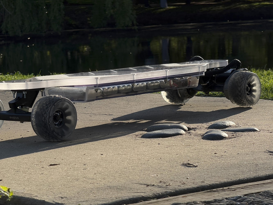

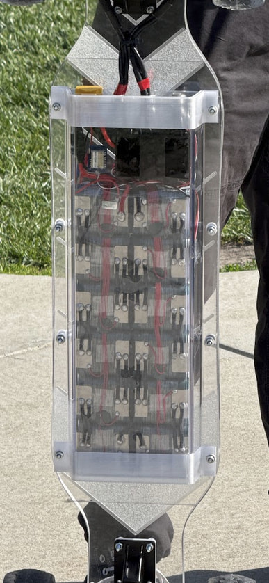

Now, about the battery, quick sidebar because I think it deserves it. This is a 12s3p Molicel P42A pack from MBoards, but it’s a pre-PCB pack, meaning I bought it before MBoards switched to using a PCB to connect the cells. If you look at the pic, you can see every individual wire running from each cell group to the BMS, and honestly, I think it’s beautiful. There’s something about visible, hand-built wiring that just hits different, especially in a build where the whole point is that you can see everything. The new PCB packs are probably objectively cleaner, but I lucked into having one of the old-school ones right when I needed it for a board that’s all about showing off the guts. No notes.

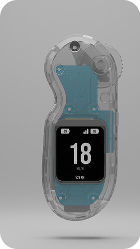

The remote situation was its own saga. I originally really wanted to use the GB Engineering Remote Lite because it’s fully transparent, and I wanted to try something other than the Hoyt Puck (I personally don’t love the shape of the puck or the Post Mote; no hate at all, I use Hoyt Pucks on all my other boards, just personal preference). However, George Bennett was doing some model updates around the time I ordered, so I was waiting months for it. I got a little antsy and ended up buying a clear Hoyt Puck 2.0 from MBoards, which arrived very quickly. Then the GB remote finally showed up, and I instantly swapped to it. Way better shape to hold than the puck, and it just fits this build better since it’s fully transparent rather than the frosted-clear of the puck. The configuration website is genuinely cool too. To George, if you’re reading this: sorry for asking for so many updates and being annoying about it, your product and customer service are great. No negativity towards you at all. Just wanted to mention the timeline since it was part of the build.

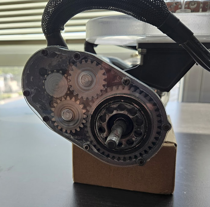

The last big mod was replacing the top panel of the Omni Eskate gear drives with polycarbonate, so you can see the gears turning while I ride. Making that part was awesome because I learned how to use a CNC for the first time. I added these panels onto the board after my photoshoot, along with the LED strip on the inside of the enclosure, pointing inward to light up all the internals.
Here are some general pics from me working on the board:

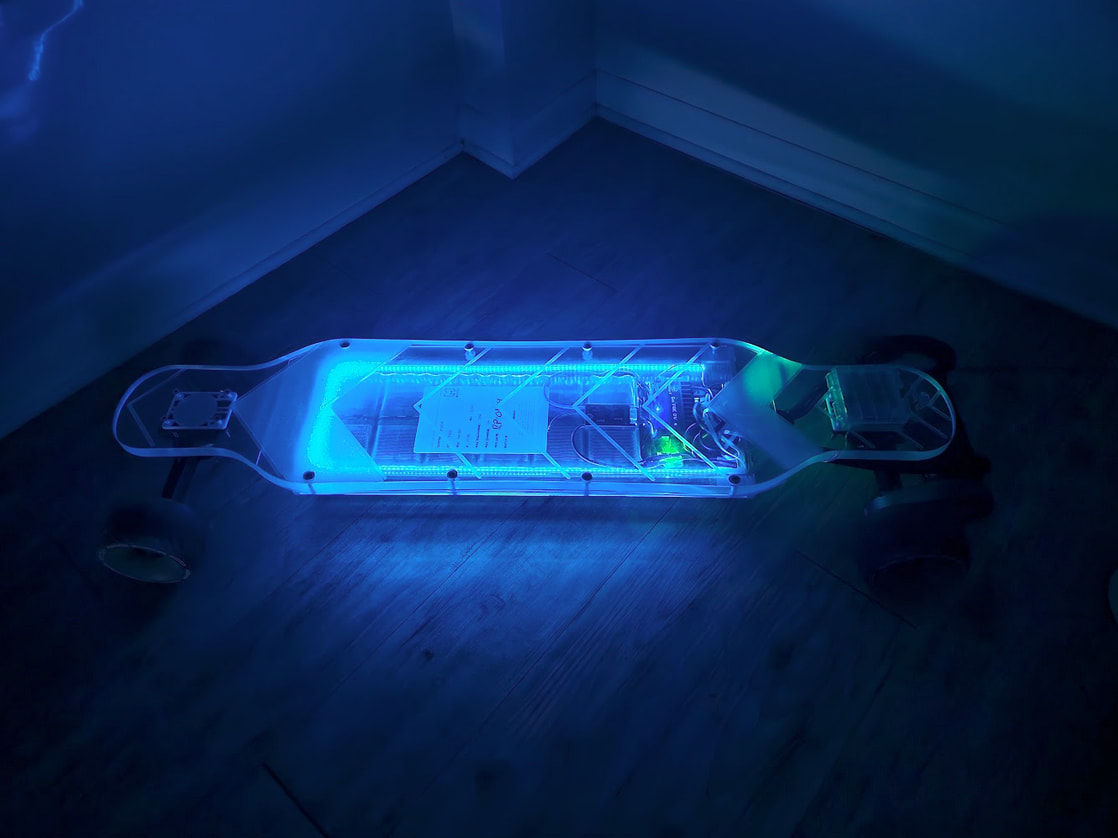

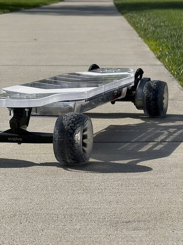

  • At first, I was deathly afraid of riding it, but once I stepped on and got comfortable, it just felt like a normal e-board. It sits a decent bit above the axle, but I only do light carving, so it doesn’t really matter.
  • The unofficial weight limit is one Brian Liang (me). No research was done. It’s based purely on vibes, and it’s my board, so my rules. I’ll gladly let anybody lighter than me try it as long as they follow my rules (which you only get to hear in person).
  • I fully understand this is probably not the strongest e-board on earth, but that’s not why I built it. The deck is ¾" acrylic, which isn’t ideal, but a custom polycarbonate deck would’ve been insanely expensive, and I’m a college student, so… yeah.
  • To me, this board represents my entire DIY eskate hobby — it’s a personal showpiece, not a daily driver. I know somebody is going to comment “i WoUlD nOt TrUsT tHaT bOaRd. tHaT tHiNg Is A dEaTh TrAp.” To that person: “Alright brah, anyways.” Not the point.
  • What I love most is being able to physically point at stuff inside the board. People ask about components, and I just go “idk, let’s take a look.” I can also write on the deck with a dry-erase marker and wipe it off, which has been an unexpectedly fun feature.
  • And yes, I know everyone hates on first-gen Cloudwheels. I honestly think they’re fine as long as you know what you’re getting.
  • One slight concern: I’m a little worried about transporting this on the NYC subway because people might genuinely think it’s a bomb. Might have to make a cover for it just for the ride to the meetup spot.

This is seriously so cool! Seeing those battery welds on bottom is just… :fire::fire::fire::fire::fire:

In my opinion your battery is upside down tho. Those series connections don’t seem to have any slack on them and could potentially limit the flex in that direction.

The glow in the dark pictures are so good dude!!!
The clear gear enclosure covers are so cool!

Thanks! Fair point, but I actually designed this build specifically to prevent flex. The ¾" acrylic deck plus the polycarbonate reinforcement panel I added underneath (mentioned in the post) keeps it pretty rigid, so the series connections shouldn’t be under any stress; and honestly, I don’t think this MBoards pack was designed to flex in the first place. I also mounted it this way on purpose so you can see all the cell-to-BMS connections, which I think looks sick. Appreciate the eye on it though. I am always open to advice to improve my build :wink:
