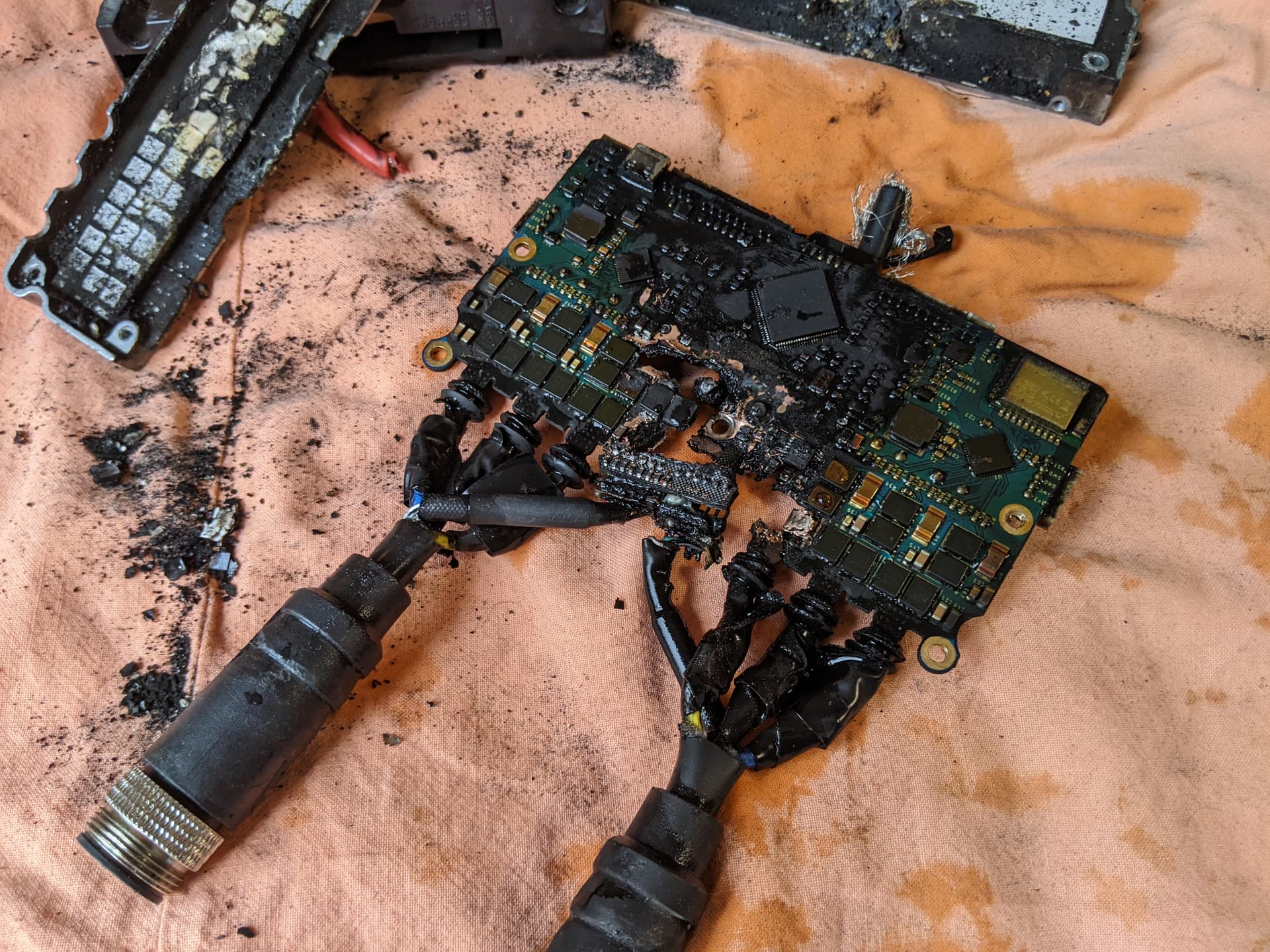

@GnomeMeansNo From the video it looks to me like the stormcore is off. Did you turn it off before you got in the uber or got home?
If so this would seem to imply something went wrong with the switch?

This interests me as well since I have a 60D on my desk with burnt precharge resistors and solder blobs around it.
I’m thinking the same thing happened in the case described in this thread. Could be that the precharge resistors were stuck active when the unit was on, and still active when turned off… heating up until desoldered itself… causing a short.
Mostly speculations though… pictures would be interesting.
In my experience this is almost always a symptom and not the root cause. Probably phase or input mosfets, the BQ chip or in rare cases the small t1 and t2 chips. Have you checked resistance between phases? All the same?

I didn’t check if it was responding to the power switch but it stopped responding to the remote before I ubered so I think it was well and truly dead already at that point.
I’m not in the habit of turning it off I just let the 10 minute timeout turn it off after I turn off the remote so wouldn’t have done that.
I’ll try and pull it apart this weekend.
Yes you are right. I think my controller has kept the precharge active for too long. There are burn marks in the thermal pad above the resistors.
The values are still fine though. The controller seems ok when bypassing the precharge fets.
I might just bridge those… will see. Don’t have the need for it at the moment so will delay the repair :slight_smile:

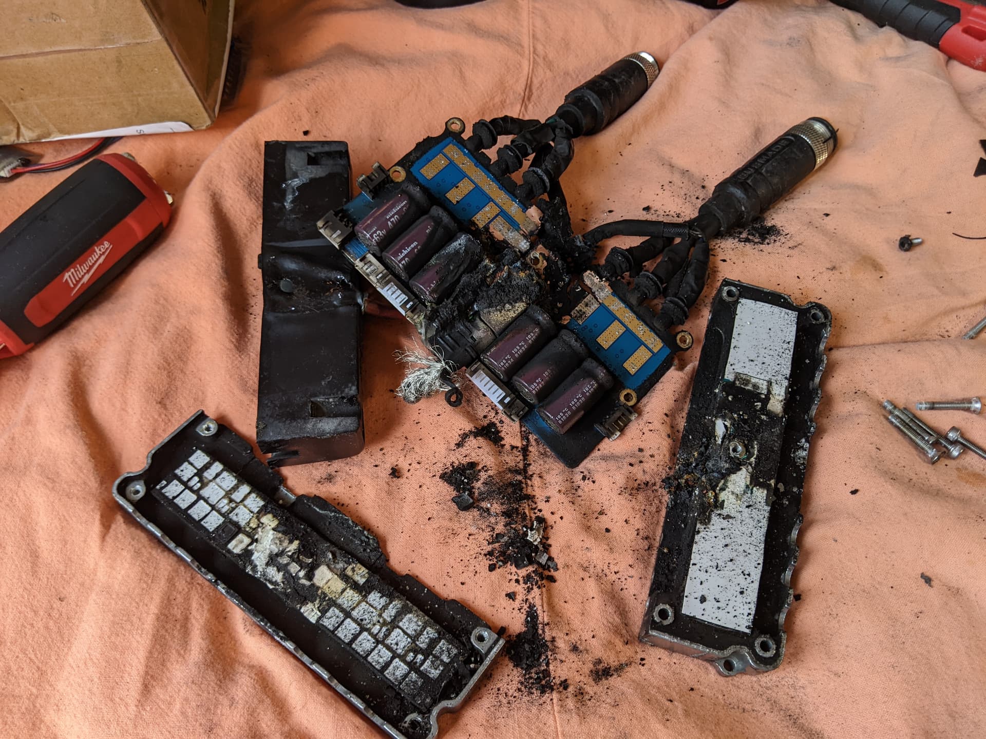

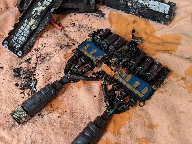

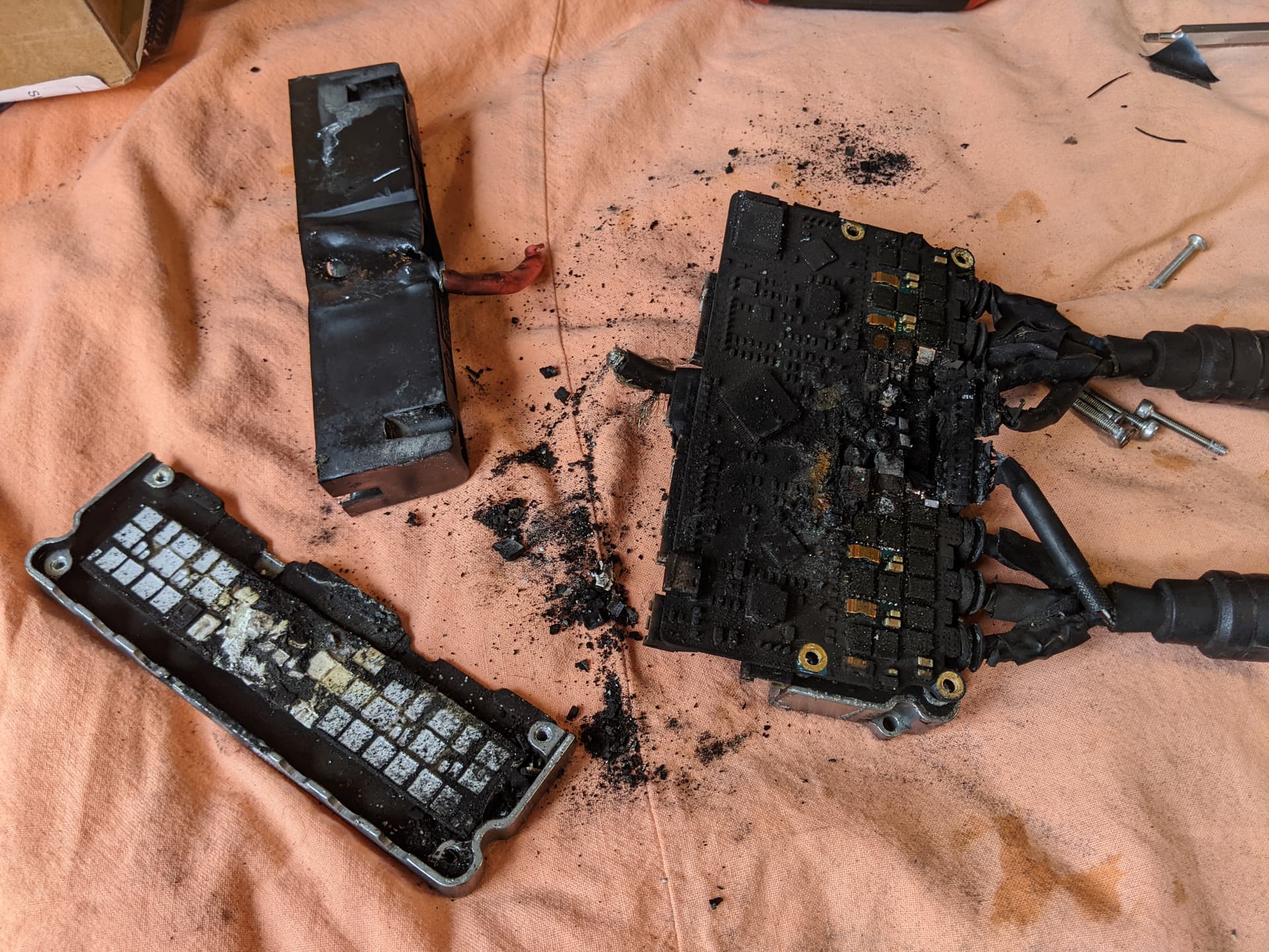

The board might have been on, it was last used like a few days before and I’m not sure why all I know is the fire started at the capacitors.
I’ve seen this exact failure lead to the stormcore blowing up inside of a board while turned off with my own eyes.
Now if I see a stormcore go into that unresponsive state I unplug it, consider it dead, and send it back to LaCroix. They can deal with it.

@GnomeMeansNo what firmware was your Stormcore running at the time of failure?
This is a good question. 5.3 is questionable to me
Whatever they were coming with in Sept of 2021.
5.something
IIRC that was FW5.2
Scrubbed a bunch of soot off to hopefully get a better look
