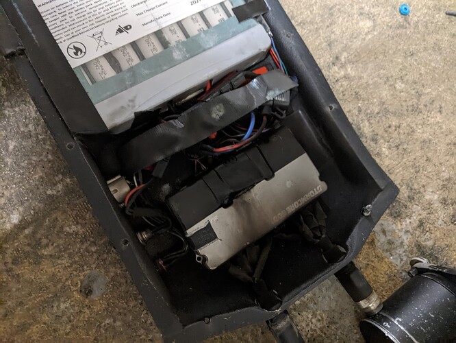

My ESC just burst into flames.
I was chillin with some dudes at a charge stop and when we pulled out my board went a few feet and then locked up.
I noticed that one of the motor connectors was I think not fully connected. No idea how that happened I guess I neglected to screw together the collar that holds it together last time I was messing with it and then maybe I knocked it apart when disconnecting the charger or something?

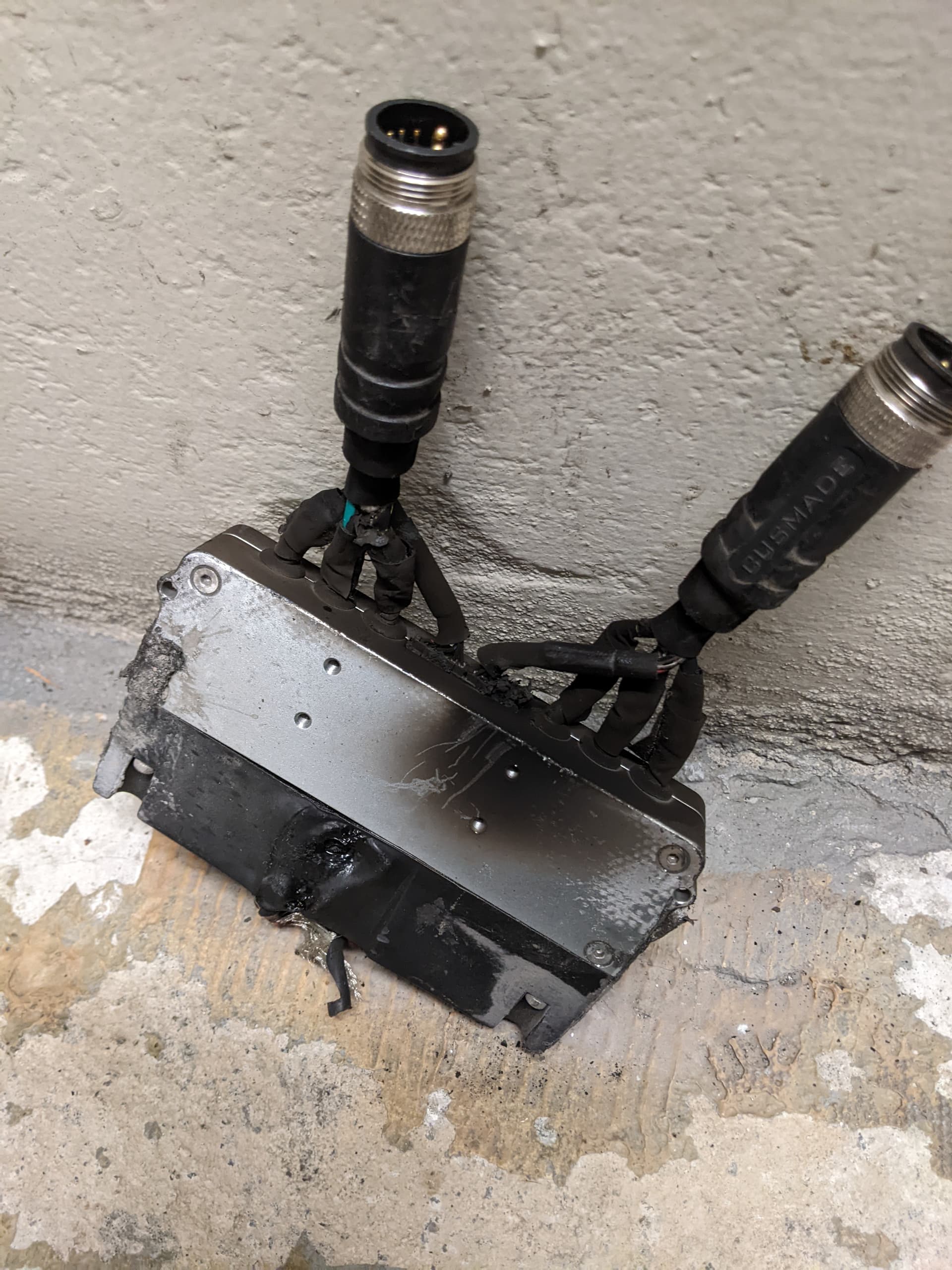

Anyway I ubered home and a few minutes after I got home I heard a weird sound and there was fucking flame squirting out the ports.
I debated throwing it off the balcony but the flame died down so I took it down the stairs to the parking lot instead:
It smells like a battery fire but my battery looks good so I’m thinking what I’m smelling is just burned up electronics from inside the ESC
My working theory is that trying to punch it with one motor partly or fully disconnected popped something in the ESC creating a short that kept heating up for the next hour.

I also had my stormcore catch fire a few months ago, while it was just sitting. That sucks man I hope you figure out what happened.
Holy shit dude this sucks!
A similar thing happened to me with one of my DV6, and had black smoke billowing out at work.
I hope your other parts are okay. It looks like your stormcore is the culprit here, I would contact Lacroix about it asap if I were you.
Is there a know fire hazard with Stormcore ESCs?
I had a loose motor phase wire, my 6.6 dual crapped out, when i got home there was a short in one channel of the esc, had i kept pushing it im sure something woulda blown. Long story short, loose phase wire cause problem, not sure why.

Dang that sucks!! You should totally inspect the battery and make sure that it wasn’t damaged by the storm core fire.
Once we confirm to the battery is safe (almost certainly is, may need a new XT90) we can get you some new heat shrink and a new end cap for it :+1:
What were your settings? Slow ABS set to true or false? Curious what the inside of the Stormcore looks like too.
Glad no other property was damaged and you are safe duder.
Out of curiosity how old was your stormcore? A lot of 60d+ and 100dx seem to be very questionable quality control wise circa spring 2022 till January 2023 ish.
This is very anecdotal but there certainly was an uptick of burned stormcores being posted around.
I think we have to say yes at this point.
