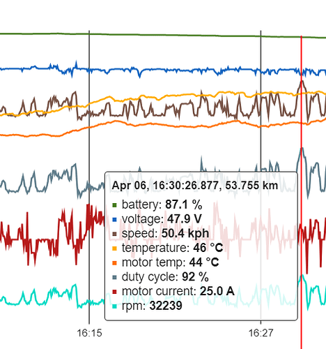

Hey guys - i want to understand why my DV6s is reaching 92% duty cycle on 51kmh/31mph. The motor current is low, and by the gearing setup i should be able to go crazy 81kph/50mph…i am trying to understand the RPM logged as it seems high (maybe it’s part of the reason why).

More info:
With no load, speed is 50kmh as well with 32000rpm (minnie data).
It seems its reaching ERPM limit, but 32k from Minnie doesnt make sense…only if is summing up both motors ERPM*motor pole pairs which would give us around 112k ERPM. Limit is 100k ERPM.
@janpom - can you pls explain how RPM on minnie is calculated? Thank you.
The “RPM” is actually ERPM. We’re aware this is confusing and we want to do something about it. We just didn’t get to it yet.
Thanks for the fast answer.
So: 32000ERPM / 7 pole pairs = 4571 rpm.
This doesnt make any sense…too low erpm to limit anything. If this number is correct, my motor Kv would be:
4571 rpm / 47v = 97kv.
Anyone has any idea of whats os going on?

This is just to say your math looks mostly correct to me.
Technically, the voltage is 47.9V and you should also take the 92% duty cycle into account, so:
4571 / 47.9 / 0.92 = 103.7 kv
Not a significant difference though.
Thanks guys, this all makes sense now - i though i was missing something when doing the math.
