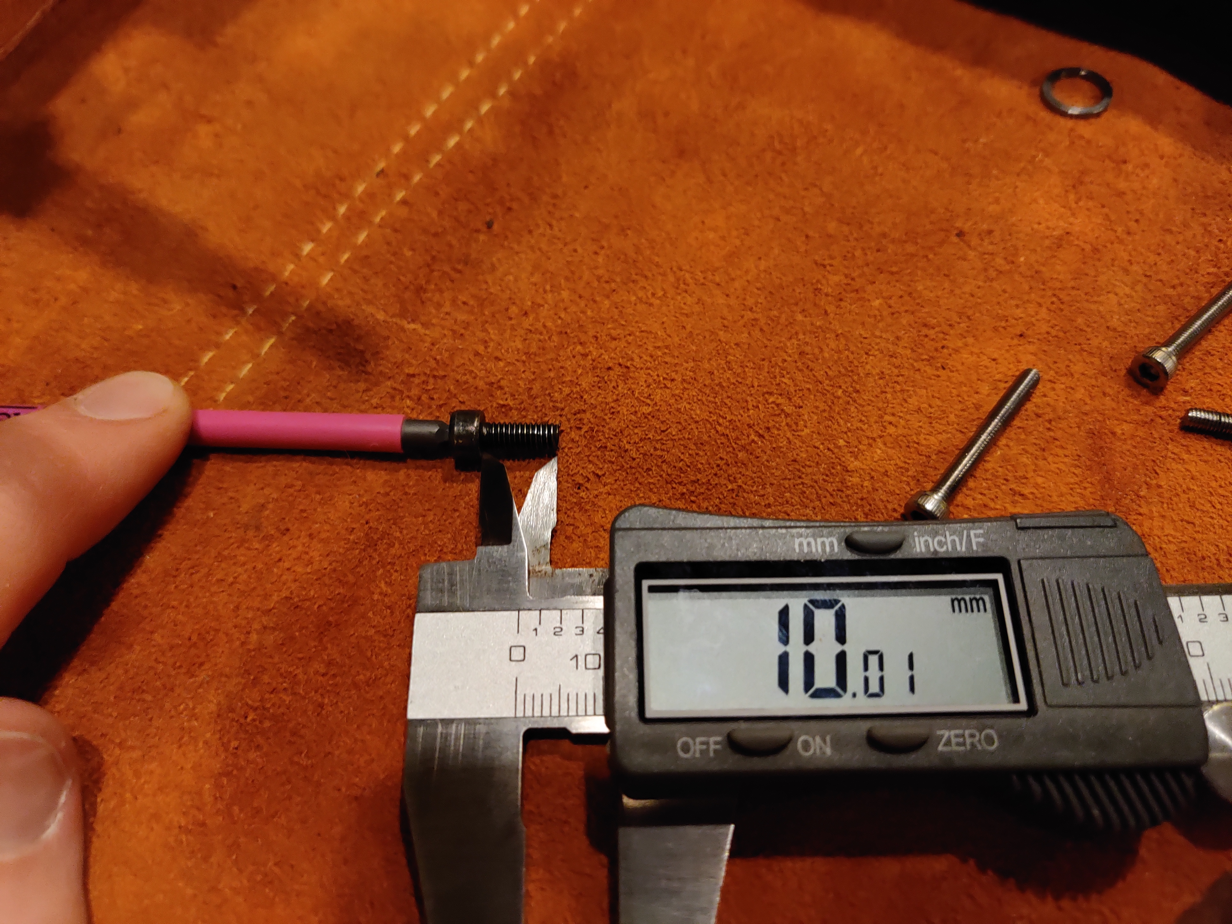

This is around 20mm.
Ill need to measure this, but i dont think there’s much space here.
One of my 6374 motors had this same issue. I noticed before powering the motor that it turned with much greater magnetic resistance when one of the bolts was fully tightened. It was probably the last two turns of the bolt where the effect began.
Replaced the supplied 10mm bolt with an 8mm to resolve.
The other motor seems fine with 10mm bolts.
I haven’t tested continuity.
Interesting! That sounds slightly different than my issue, but same cause. It sounds as though your bolt was shorting between two of the motor phases. On mine it seems like it was only one phase per motor, because they ran totally fine individually, only when current was going to both did it cause a problem.
Were you using the same open can Haggyboard motors sold as an add on to this kit? Or another brand?
Yes, same Haggyboard motors sold with the kit.
I didn’t think of that but the bolt shorting across phases makes perfect sense.
This all obviously happened very recently, but I let Timo know and I’m sure he’ll investigate and make any adjustments needed. Also should mention everyone is really setting a high bar for customer service.
I just swapped out all the m4 10mm motor bolts for m4 8mm and am again impressed with the quality of the drives and the ease with which they assemble. I have about 150 miles on the motors and they seem fine.
Awesome! I really just wanted to make people aware of the problem. With my ground down bolts I have not had any issues yet, so I hope I dont end up needing to put Timo’s legendary customer service to the test :slightly_smiling_face:

Bolt I did not shorten:
Bolt that I did shorten:
It is pretty close to flush. If anything it may be a little bit in-set.
