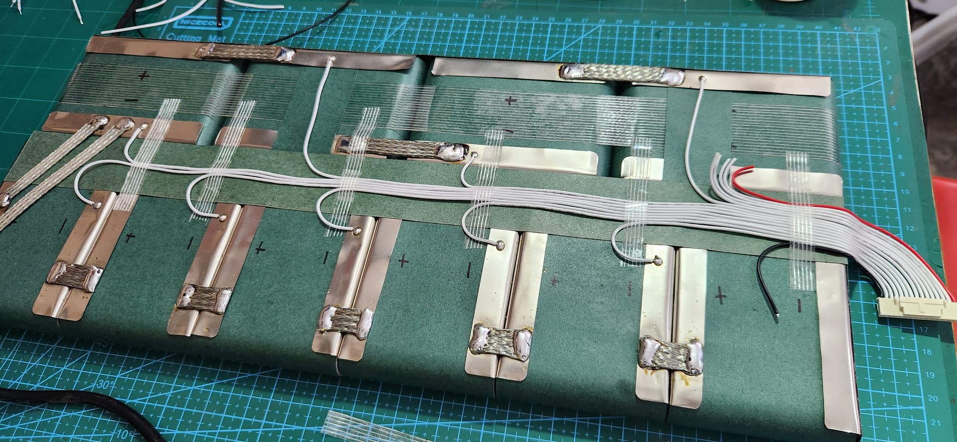

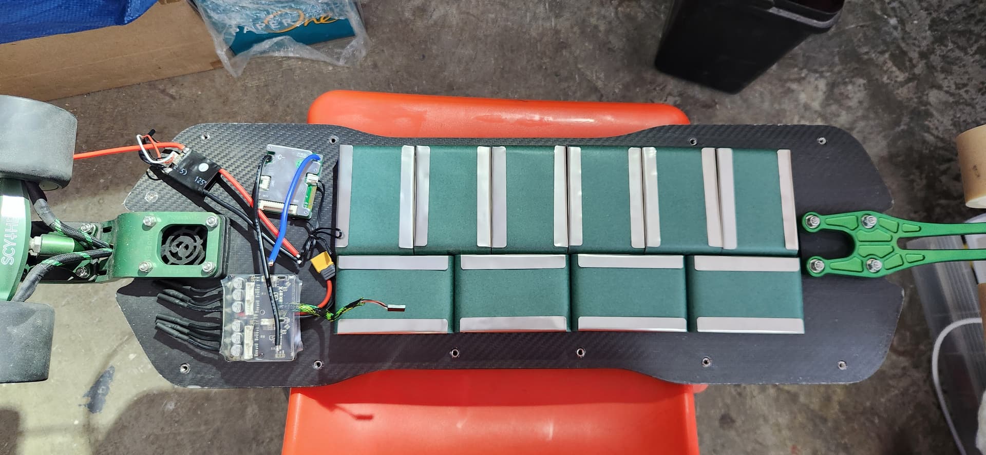

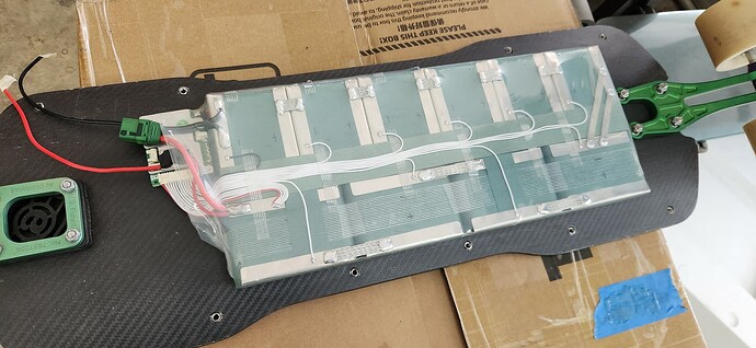

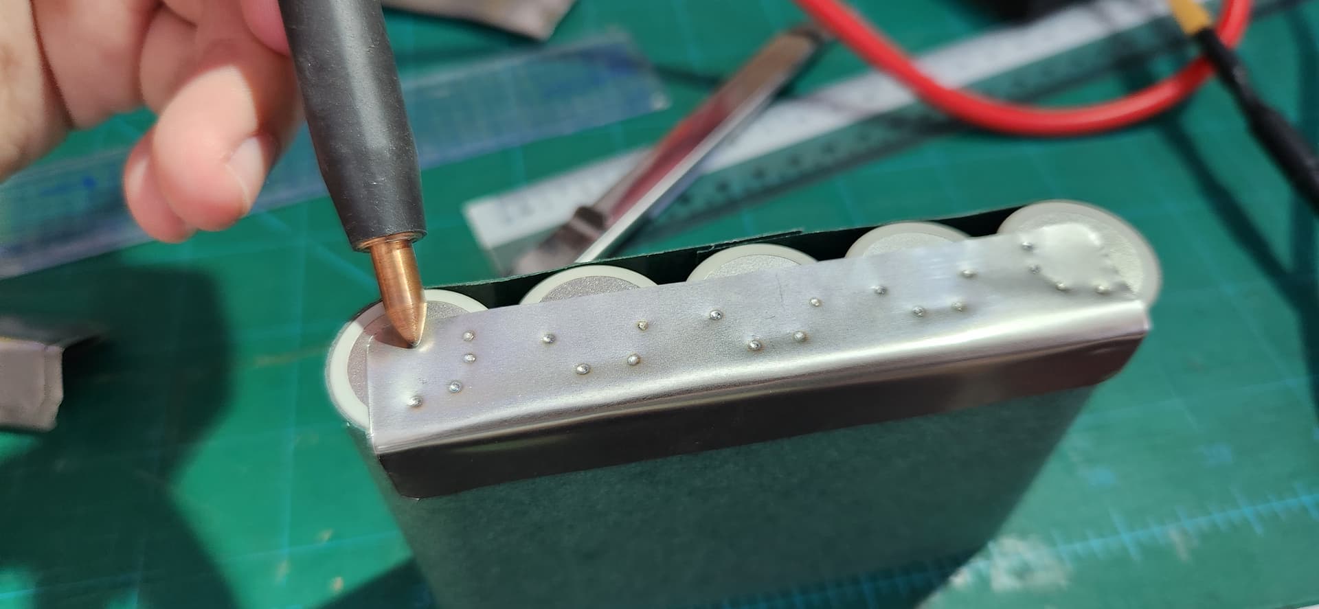

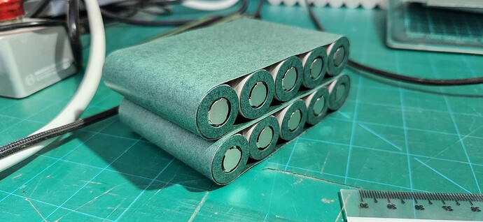

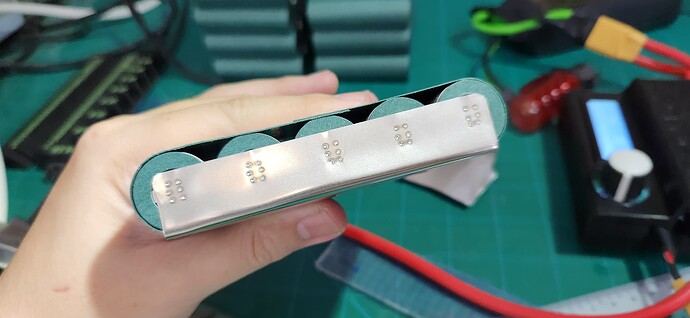

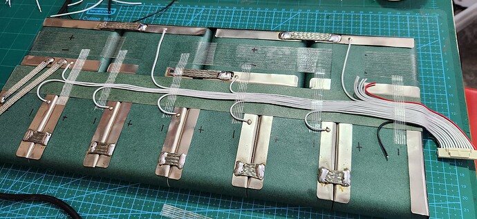

More battery work being done.

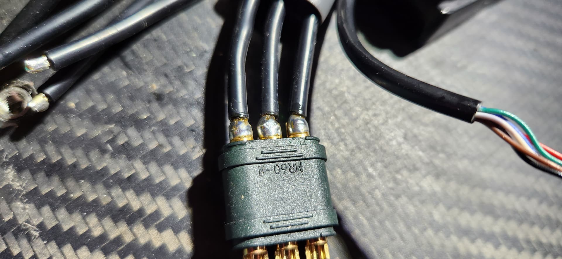

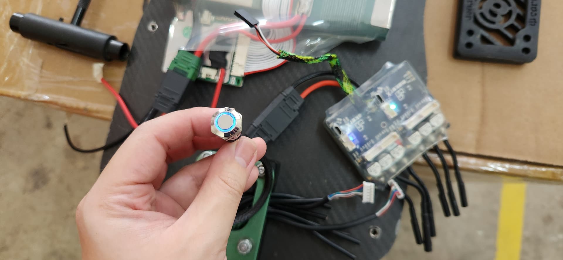

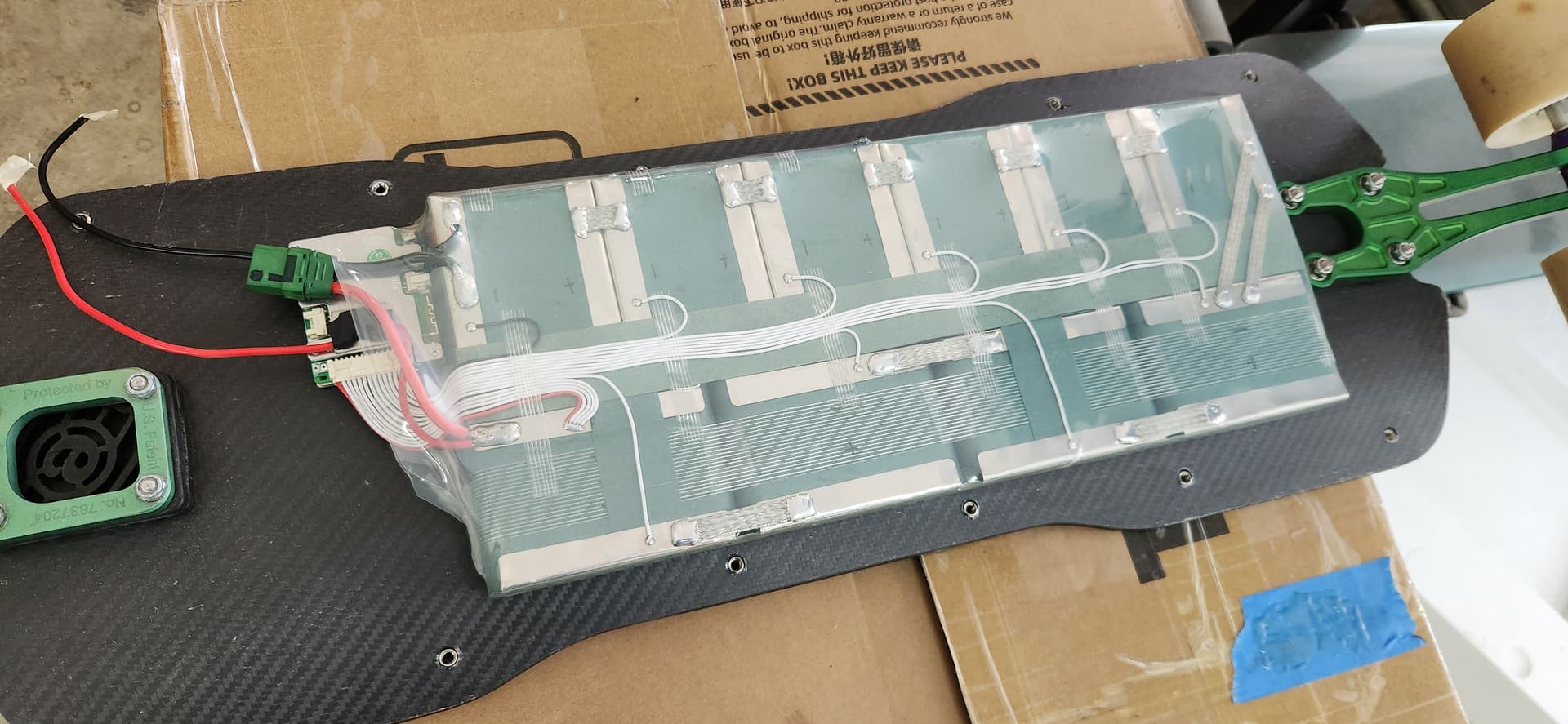

Battery done, doing the XT90 connections now.

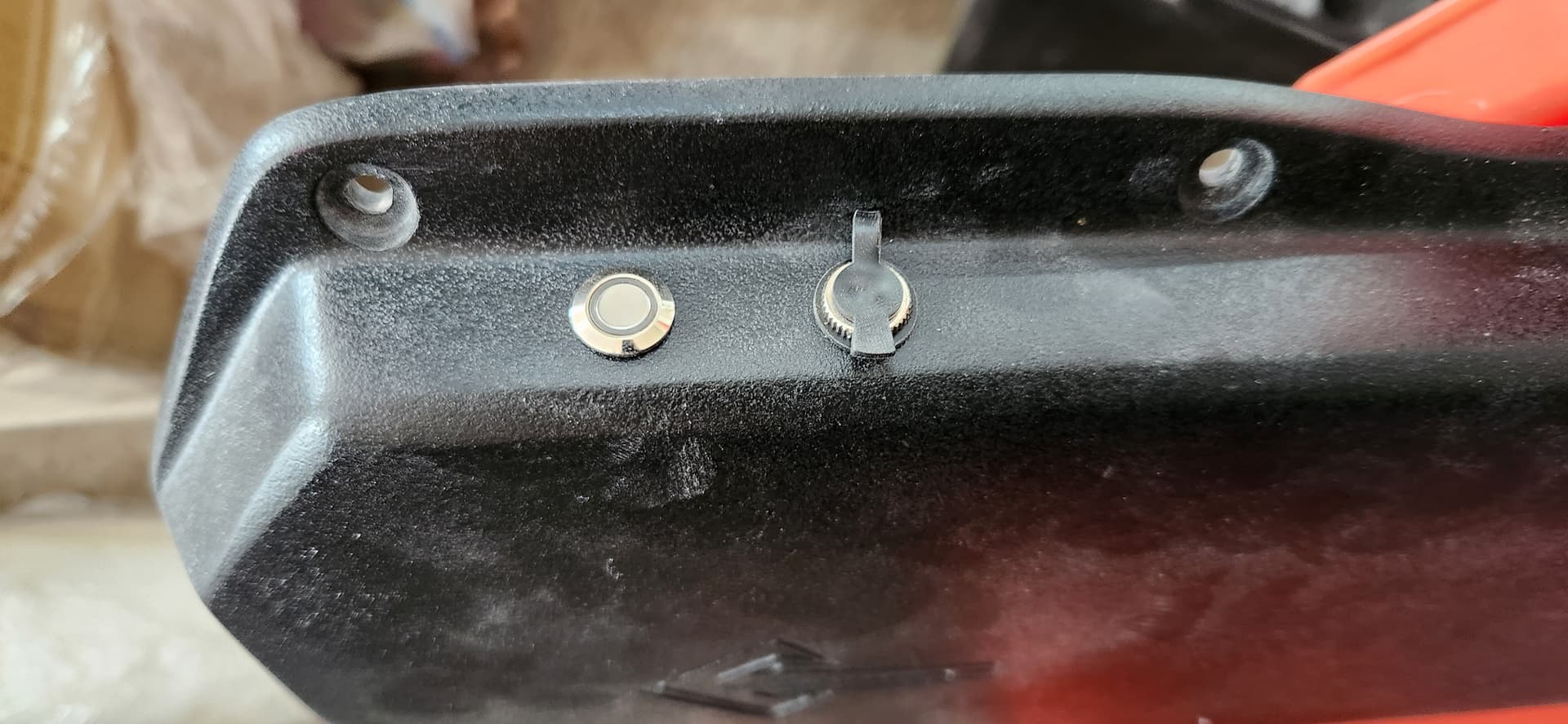

A unity couldnt fit so im using a DV4.

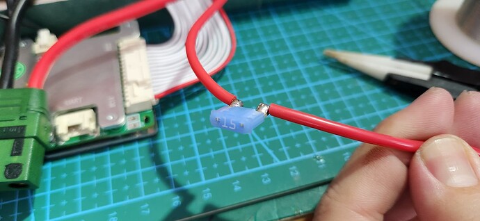

Might be done tomorrow or Wednesday. Exciting.

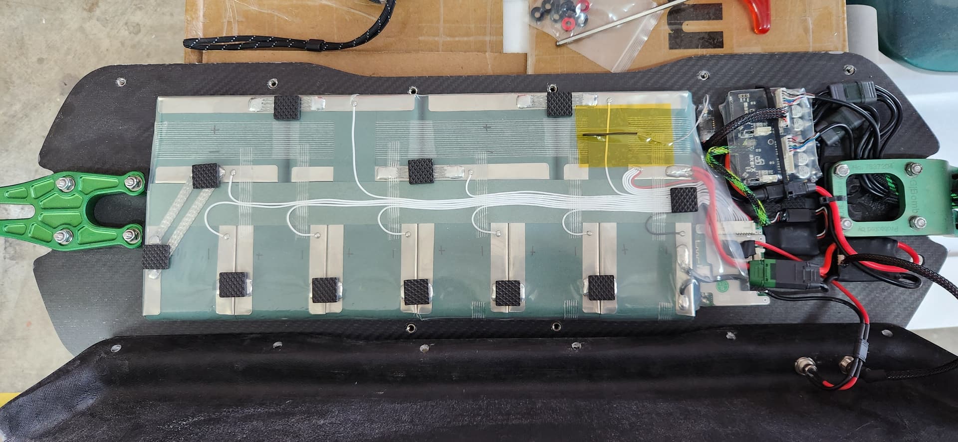

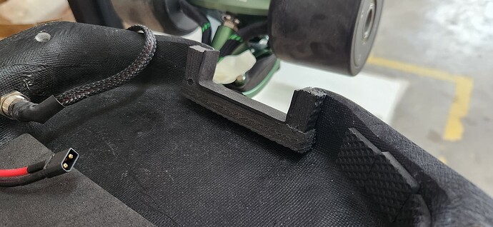

Final touches before closing it up.

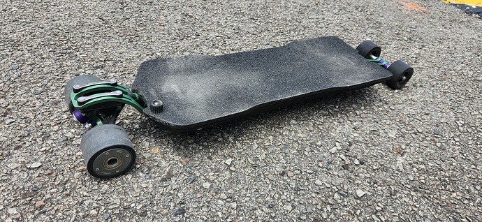

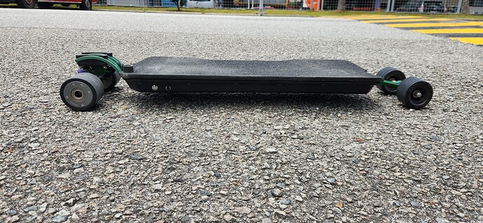

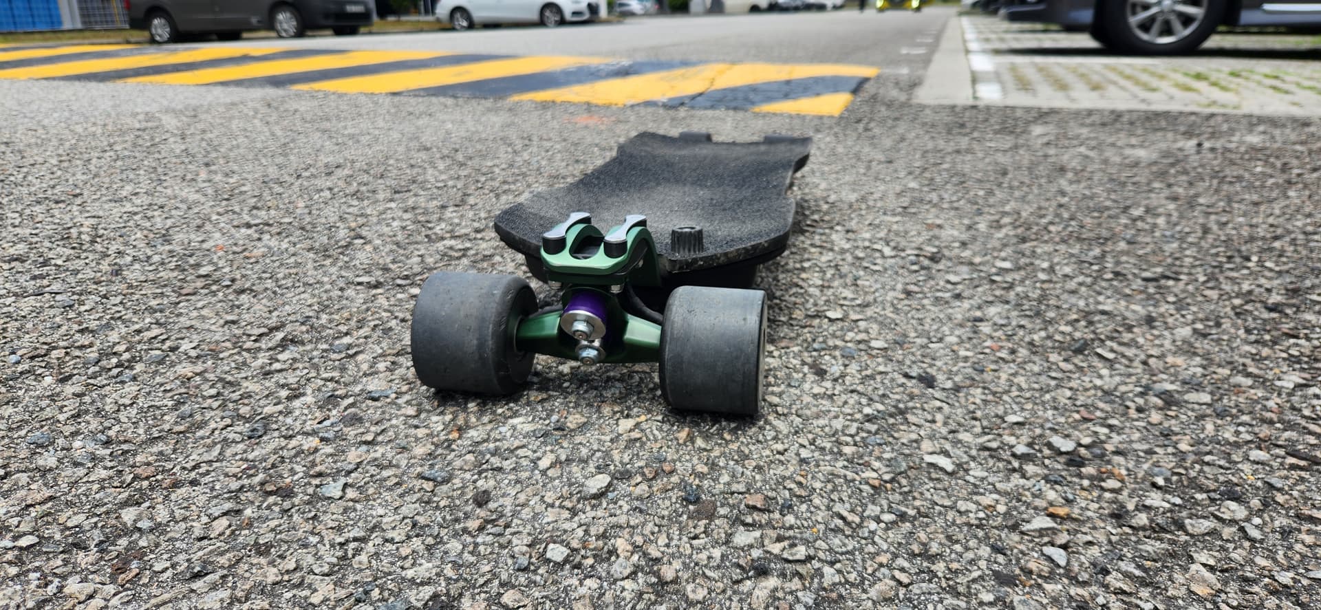

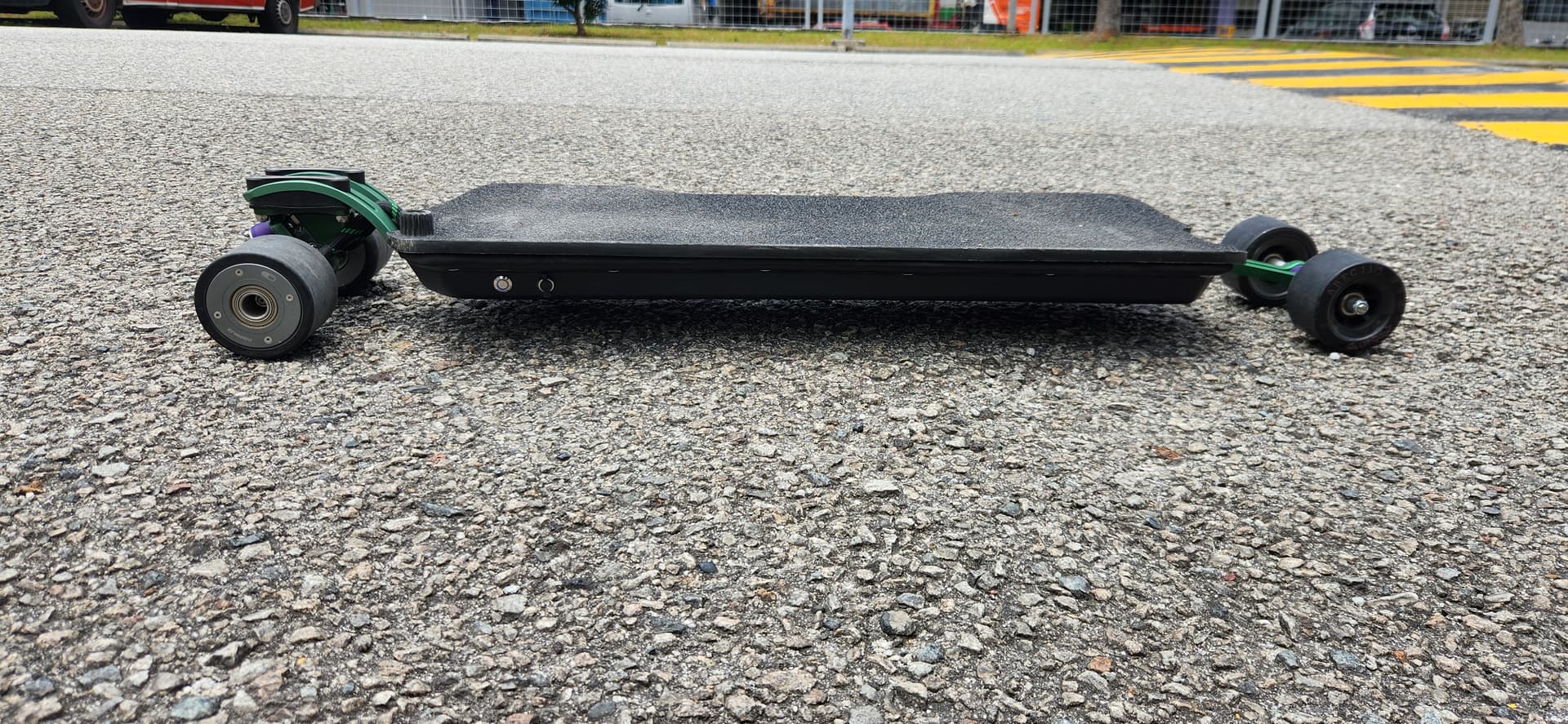

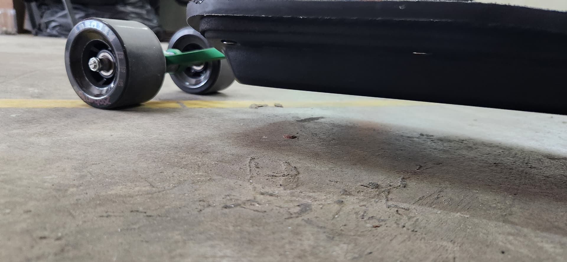

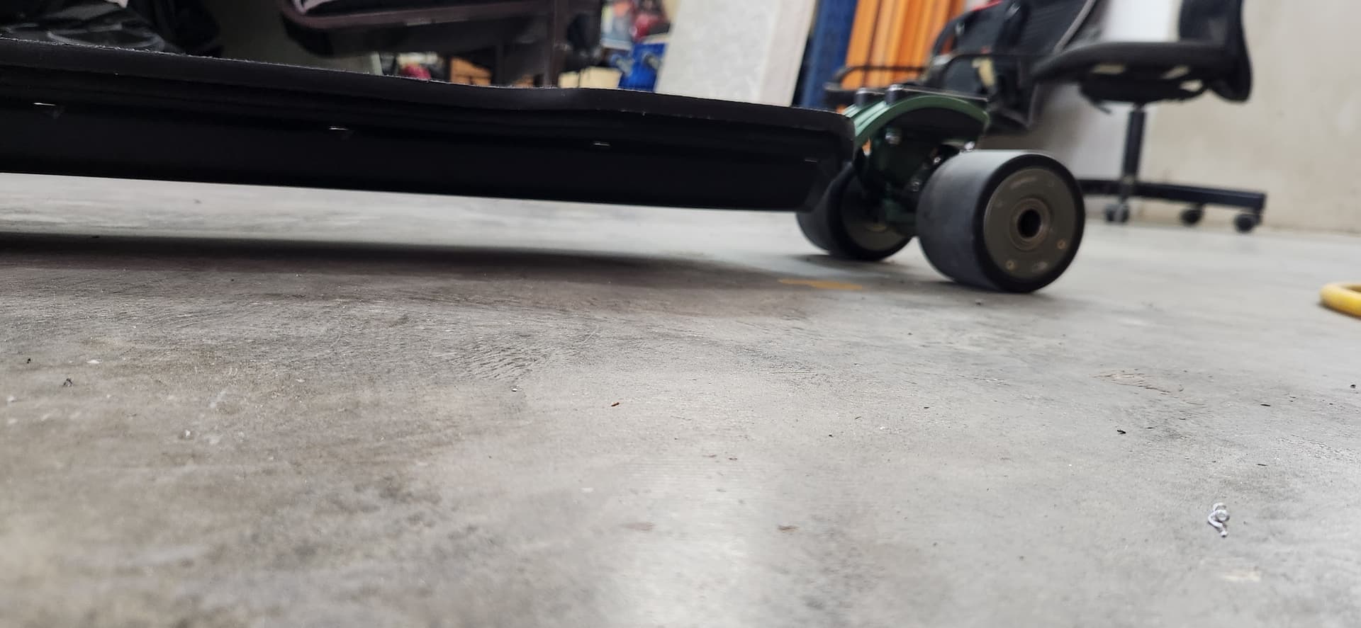

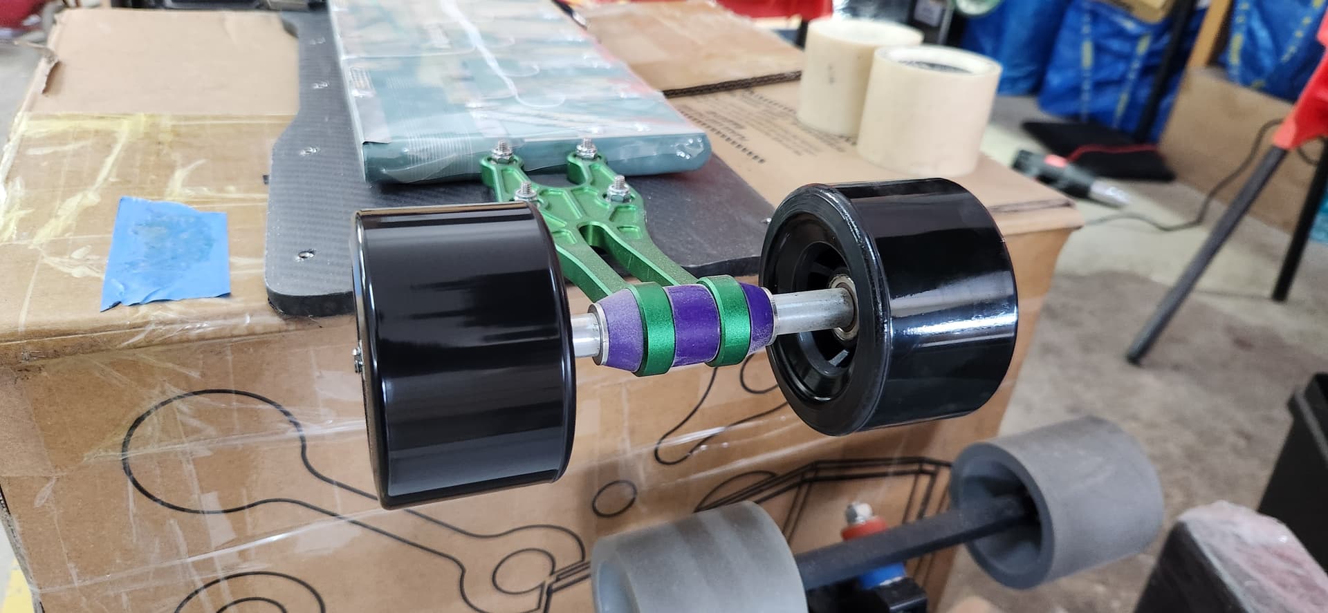

Wow! 43mm ground clearance haha.

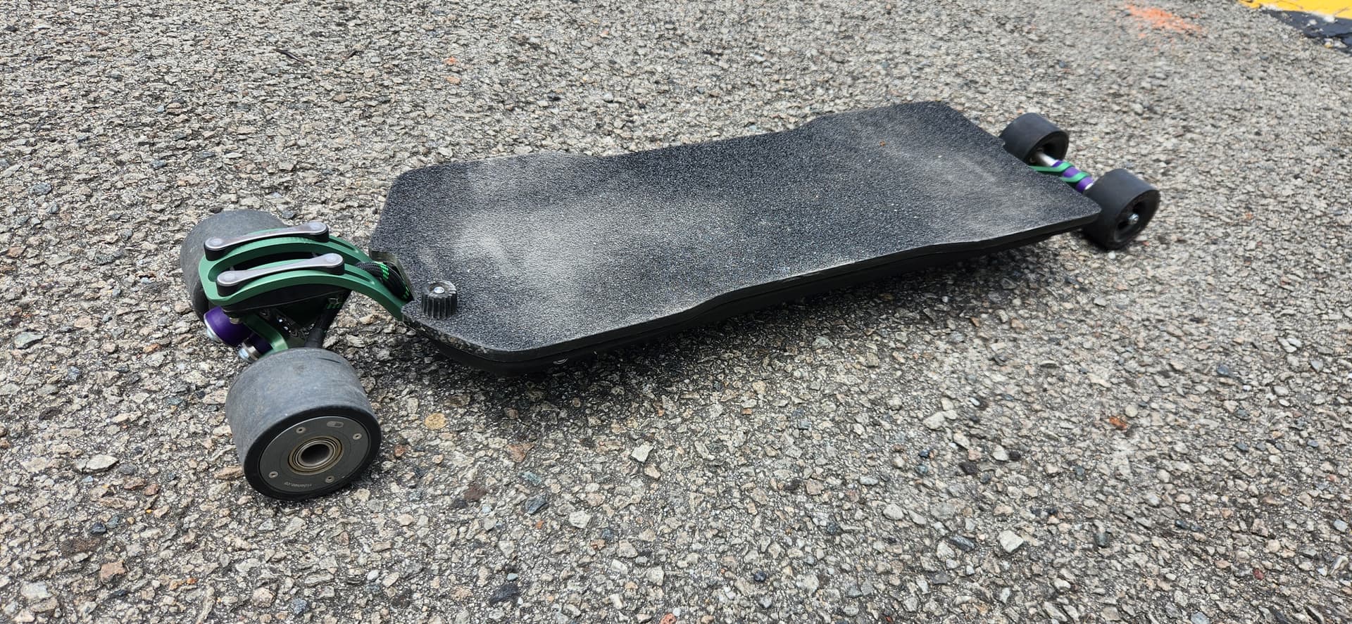

So, first thoughts riding this downstairs. What a unique build. Its not really a board that I would gun the throttle a lot, this is not what I would use it for. Due to the large battery size, pumping to sustain the rolling will have decent range on this board. When riding it, the bushings are for pumping so its at 70A, after handing it over to my friend, he’ll adjust and probably change bushings to his needs.
Heres the settings!
Motor max 80A
Motor brake -100A
Battery max 60A per side
Regen 25A
Looks like so much fun!!!
I think I had pretty much exactly the same amount of clearance on Frankendick, it was just enough :grin:
