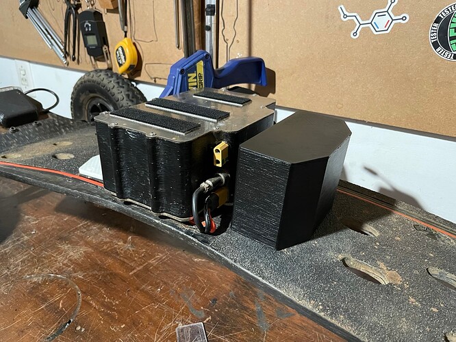

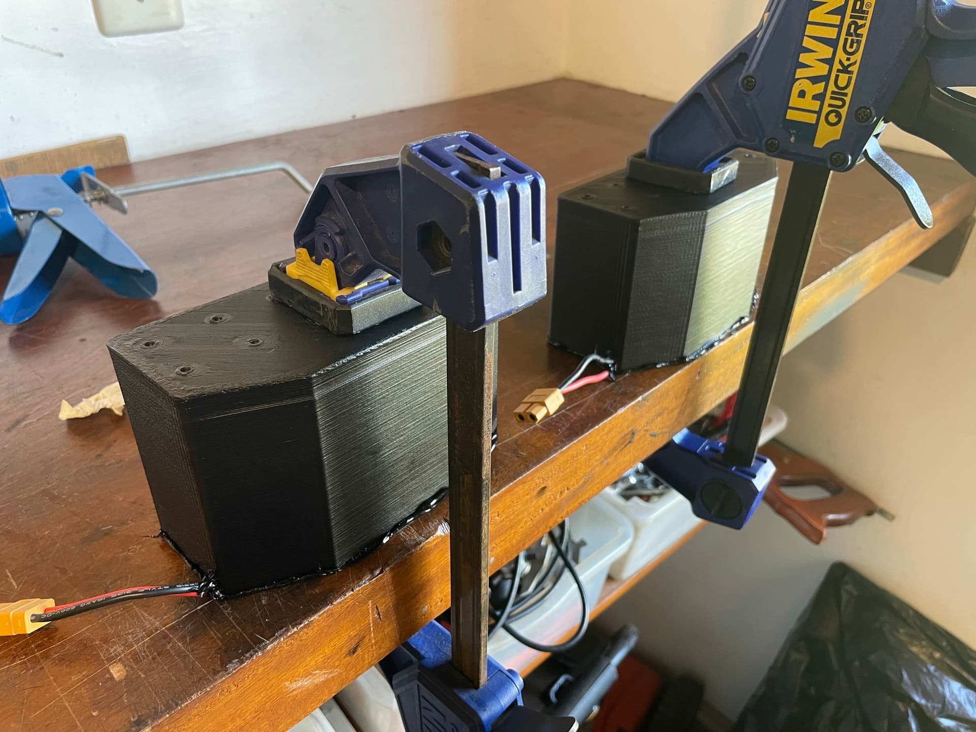

I’m doing it, two hoverboard packs parallel with my main pack, will get back with how it works as soon as I can finish and test it
What are the configurations of each battery in your setup?
10S5P of VTC6 on the main pack and each hoverboard pack is 10S2P of some 2200 mAh cells
I’ve been skating with external range extender packs for 3 entire seasons now. YES, I’ve had problems, damaged things, so YOU DON’T HAVE TO.
  1. Your main pack needs to be able to handle regen current on it’s own. This means that the pack which can handle heavy charge/discharge current needs to be the main / internal / permanently attached pack.
  2. BOTH packs need their own BMS w/ balancing means.
  3. The charge input of the main pack needs to be rated to handle the max output of the REX pack! This means the BMS of the main pack, and the input jack + wiring harness needs to be able to handle 15-30A. I recommend 16AWG minimum… preferably 14AWG.
  4. The REX pack output MUST run through an “Ideal Diode” circuit. This prevents it from ever drawing juice from the main pack.
  5. You can charge between the 2 packs in the field, but must NEVER charge the REX pack while connected to the main pack. You MUST charge the REX pack while disconnected from the main pack. If you fail to do so, you will very likely dump current from your charger AND the REX pack into your main pack, frying its BMS.
  6. Never connect the REX when it’s sitting at a significantly higher voltage than the main pack! Same reason as above… You’ll dump a ton of current into the main pack very quickly, likely damage/fry it’s BMS.
So long as you avoid these pitfalls, use these tips, whenever you’re cruising, coasting or stopped, your main pack will “sip” from the REX at no more than a few amps.
