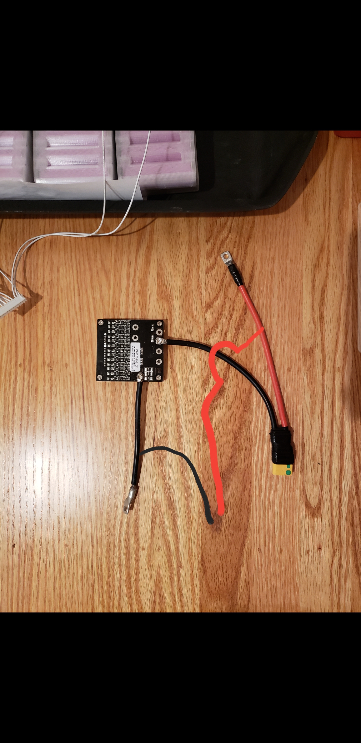

@thisguyhere hey bro does this look right? Assuming my series connections are correct.
Also where do add my charge port?
@thisguyhere can I add it like this?
um…that doesn’t look right, give me a bit, will have to look at it closer.

Ok so I fixed the mess I have above and I used the diagram you sent me to wire up the bms, and when I charge the battery it charges to 45 volts lol…with my 50.4 volt charger…what could be happening anyone know?
one of your P groups is probably low, out of balance, or worse, dead.
measure your P groups:
Dang bro, you were right, dead p group…know anyone with 6 - 30q cells?

Uuuugh! So not sure if I have a bad bms or I wired it wrong somehow, but it’s the second time I find my 12th p group dead
@thisguyhere @PrivacyDoctor anyone know what’s up?
Replace that BMS. Faulty.
If you replaced the entire group, it’s odd. Might be the BMS indeed. Unless it is somehow sensing a lower voltage for the last group… but that’s most likely a fault of the BMS.
Sounds like bleed resistor is on
Is this a bms I sold you? If so, I’m sorry but it’s like that sometimes, you get a bad unit. I have a box full of shit bms
Yeah that’s it. Ok I will get a new bms

Yes the bms had a faulty resistor circuit that drained a pgroup completely
