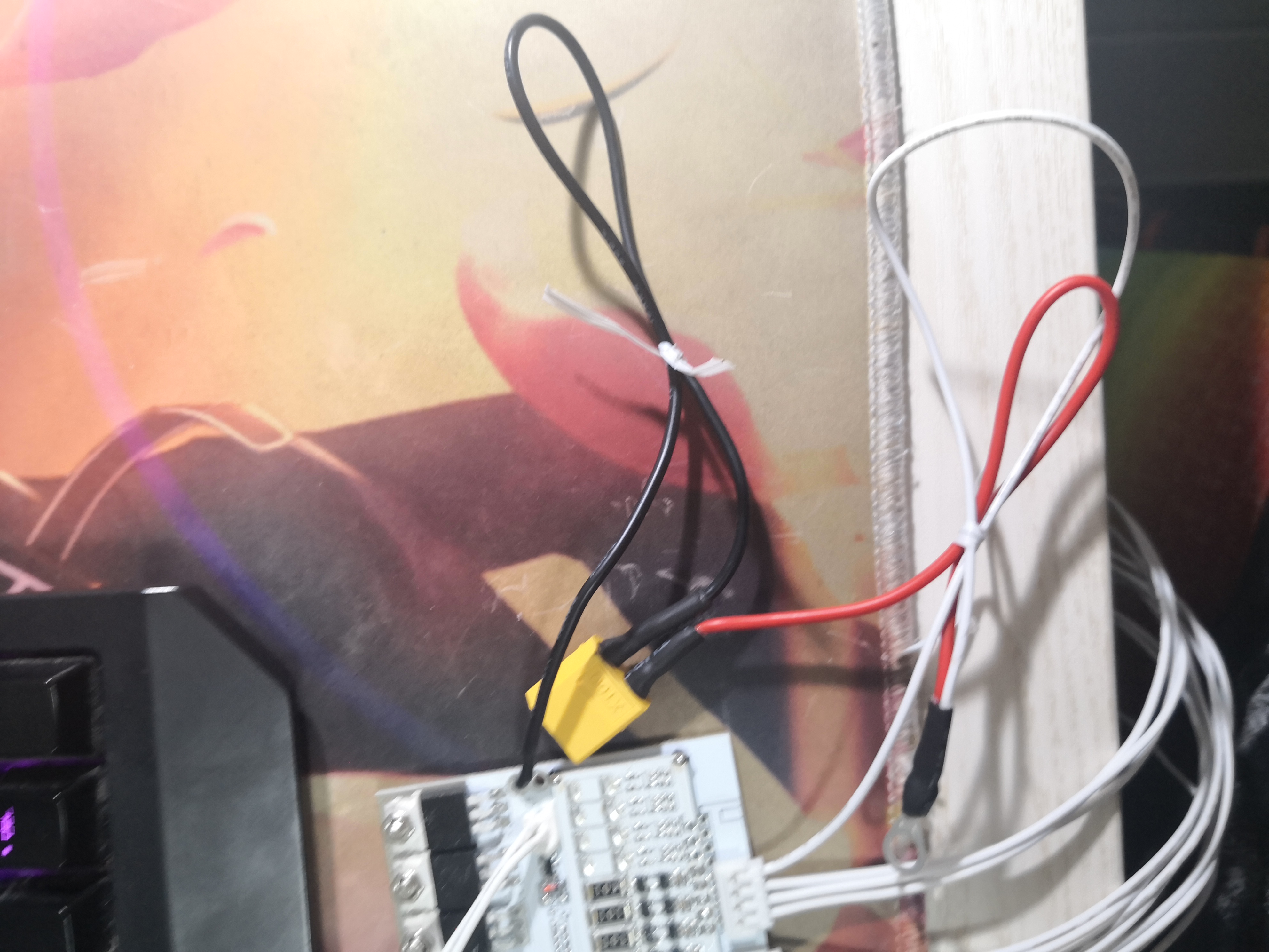

Hi I accidentally wired my first bms the wrong way I got the same one from another supplier but it looks a bit different it’s the D140
From Litech
Just wanting a little advice on the diagram as it looks a tad confusing.
The P connects to charger Negative and the B- connects to battery negative with the B1 if I’m not mistaken. Could someone with experience please confirm this before I solder and plug it all in. And I was informed 1 through to 12 starts at the negative end to the positive end to connect the balance leads. I had these the other way which I believe caused my first bms to blow.

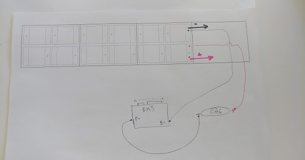

see if this helps

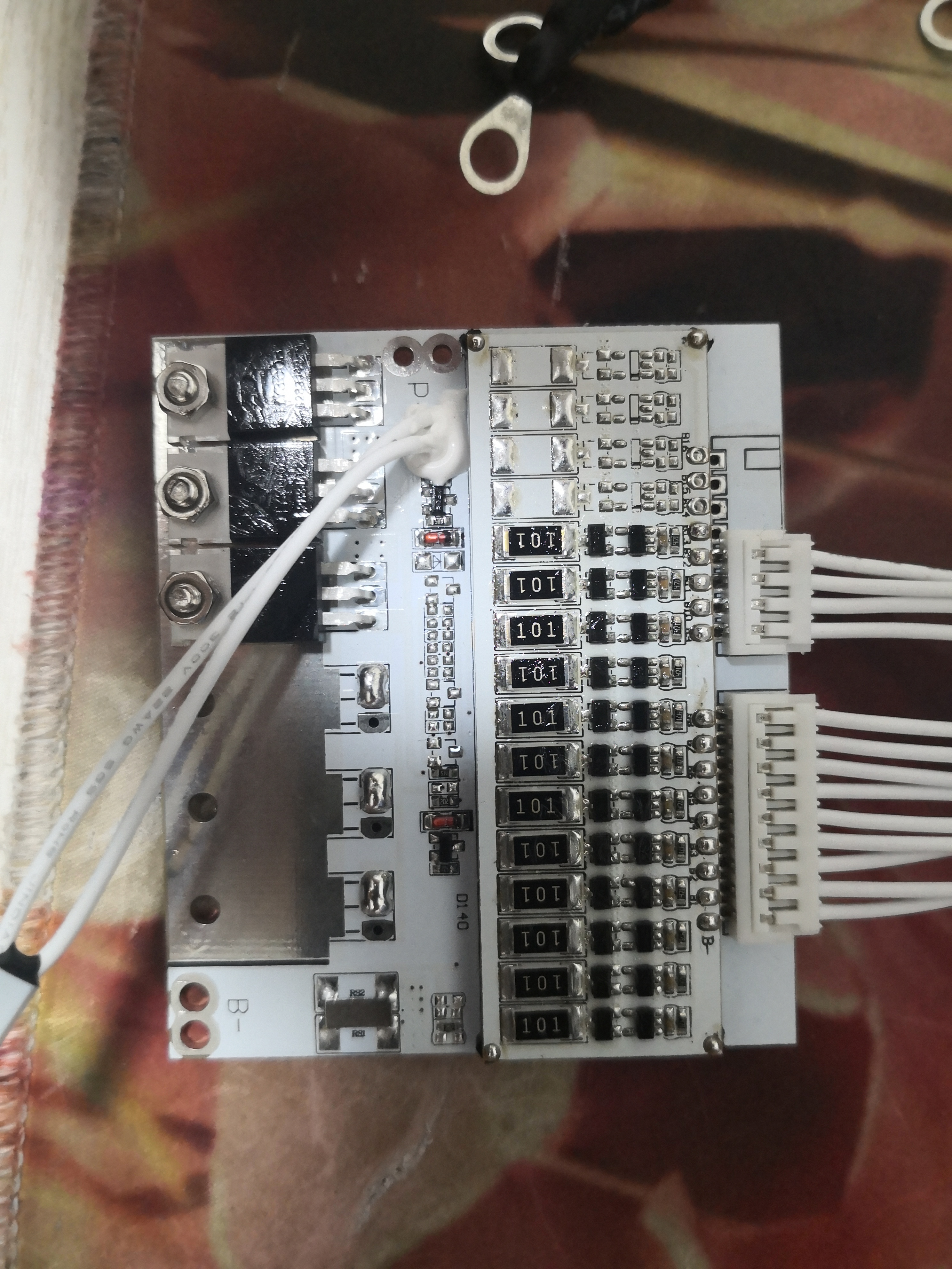

13 pins on bms

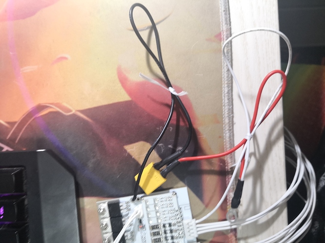

this is what i had on my other bms whic hi damaged, i was informed the balance wires were backwards

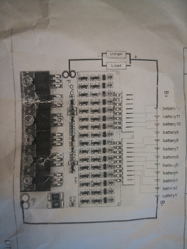

popped up a couple of diagrams could someone please confirm this for me before connecting the bms
Ok for 13pins the first balance wire is B- (=first cell negative) and the second wire the positive of cell1 and so on up to cell 12. I recommend to unplug the wires from BMS and after soldering to measure with a multimeter before connecting again.
i have B- on PCB and as a balance wire, do i connect both B- wires to the battery Negative terminal, this is the part i got a little confused with. then its 1 through to 12 going backwards from the negative terminal correct? (COnnecting to the possitive terminals for the balance wires)
the P wire goes to Charger Negative
the charger positive goes to cell 12 (Possitive terminal on the battery with the charge wire if im not mistaken)

Balance wires you need 13
B- balance wire then 12 more to go on the + side of each sell
A large charge wire to carry the load to the B- solder pad on the BMS from battery -
Balance wire 12 and charger + both go to battery +

12+ connects to Charge Wire +
Charge Wire - connects to P
B- on PCB connects to B- on balalnce wire which goes to - Terminal of battery.

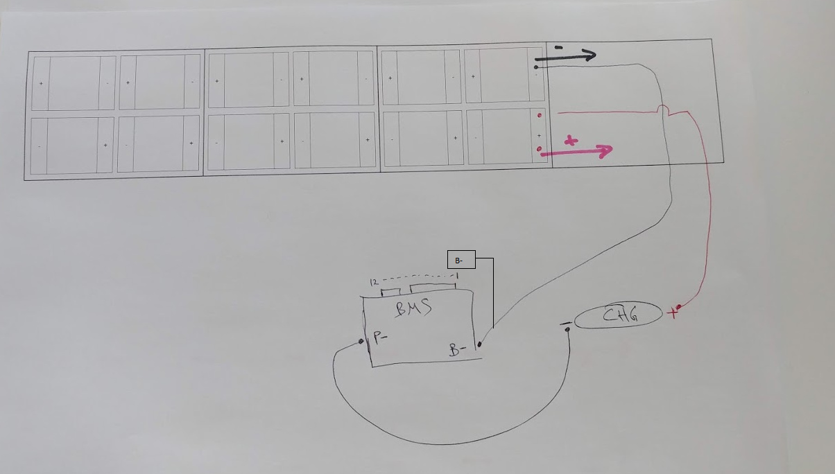

so what i have here is marked with boxes, these are the ones that get connected together based on my other diagram
Also connect them to the Battry +
This looks correct if you do that
yes, the 1-12 connects to battery positive terminals going backwards from the B- conenction
Also this diagram might make more sense to you also this B- both conenct to the same Negative terminal

Both B- conencts to Negative terminal.
P connects to Negative Charger
go backwards from B- and connect each of the + balance wires
This sound right?
Yes

Battery - is B-,1,2,3,4,5,6,7,8,9,10,11,12 is Battery +
