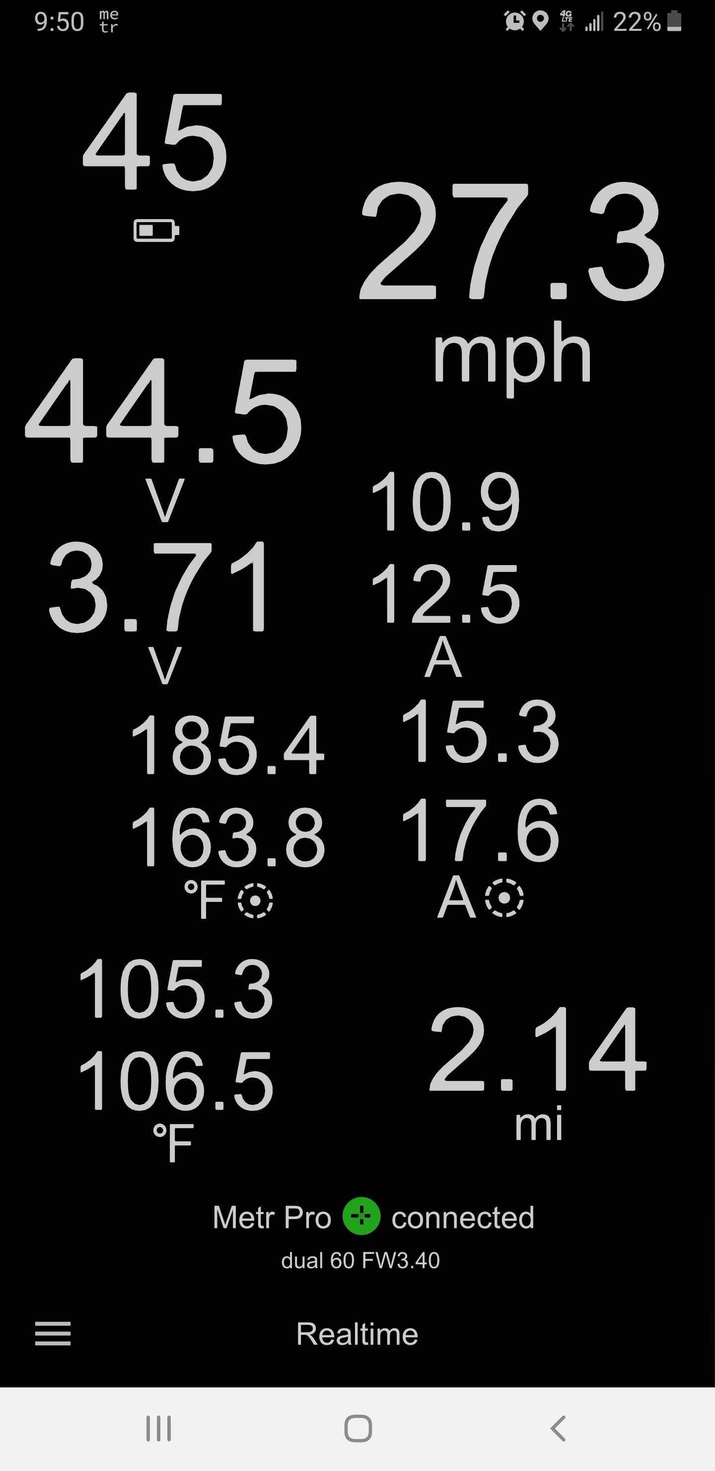

I have a dual 6374 build and I’m getting one motor/esc that is drawing 3x the amps that the other one is. Ive replaced the esc and still get crazy amp draw. Ive attached a screenshot of the metr app. Any help on this would be greatly appreciated… I’m guessing I’ve got a bad motor?

Ok, so round 2 of testing… meter dongle doesn’t matter which esc it’s plugged into. Same result.
I swapped motors and to my surprise the amps stayed pretty normal… but I had a motor heat up pretty quick. Same motor on either esc.
I’ve had a previous problem with the sensor on another BKB 6374 and had to replace the motor. Im beginning to wonder if this sensor is beginning to fail? You can touch the motor can and it’s not crazy hot…

Try checking the amp settings of each vesc using the expert mode of the metr pro app
All settings are the same for each vesc. Confirmed via metr and vesc tool… deucesdown, my other board is set up sensorless because of a bad sensor on a bkb6374. I think im going to try out some of the new TB 6374

Last night the motor that was heating up actually failed. The vesc just blinks a red light when the motor is plugged in… I can unplug it and the vesc works as normal with the other motor… been in contact with BKB about the issue (will not be buying those again) and decided to go with Torqueboards 6380 In hopes of keeping motor temps down with more motor! Damn this is an expensive hobby
