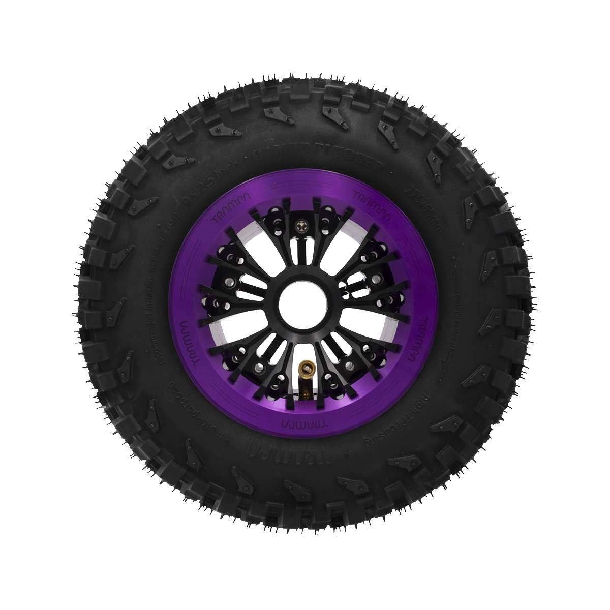

Has anyone tried this rim? You can add weights and balance the tyre. I am surprised that most esk8 rims don’t have this . I know that you can glue small weights on the rim but this is a better solution
