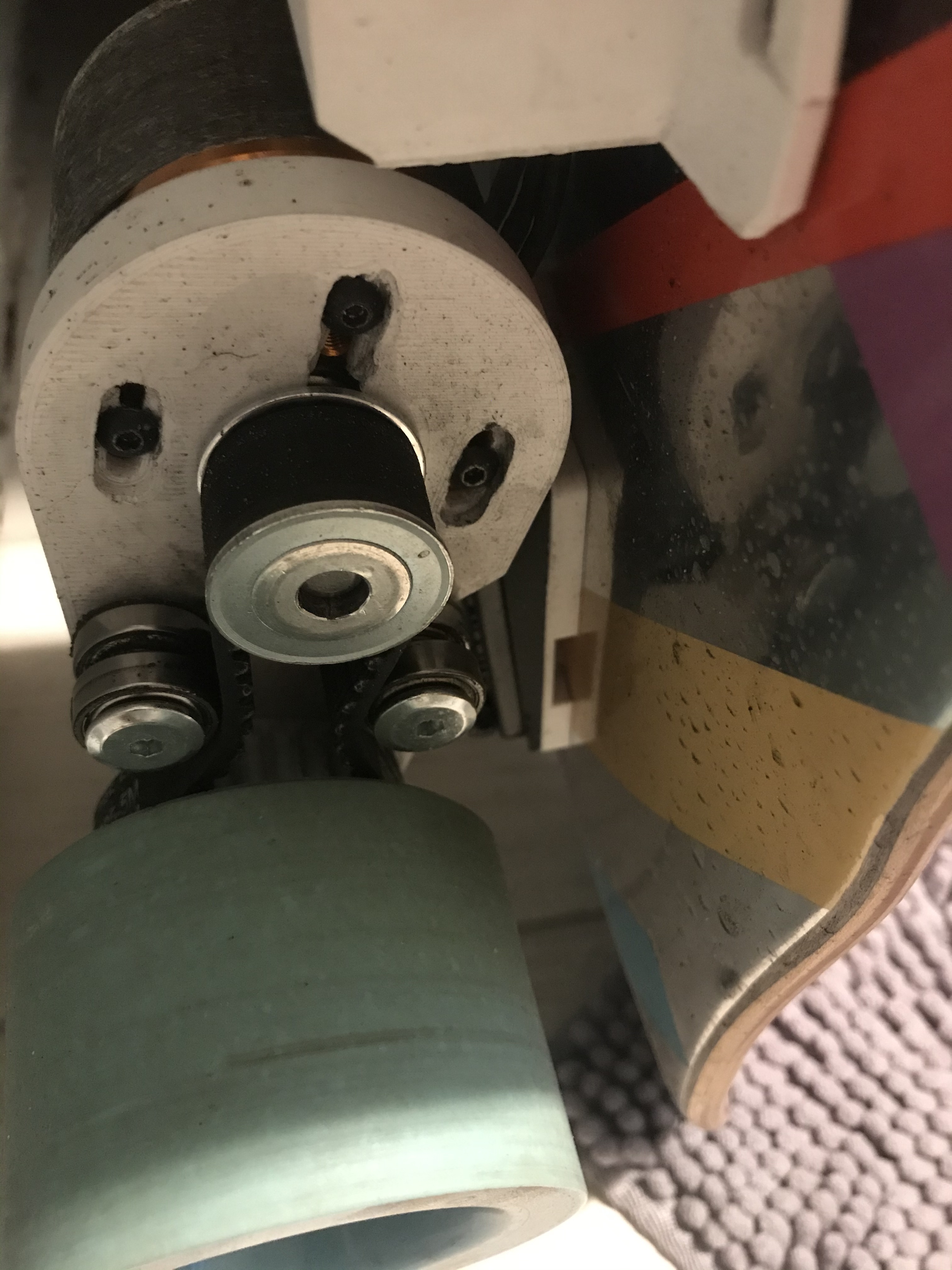

Help me not die, brakes suck.

I will be switching to current hyst reverse w brake, got two idlers set up on the mount today, will finish it up after work.

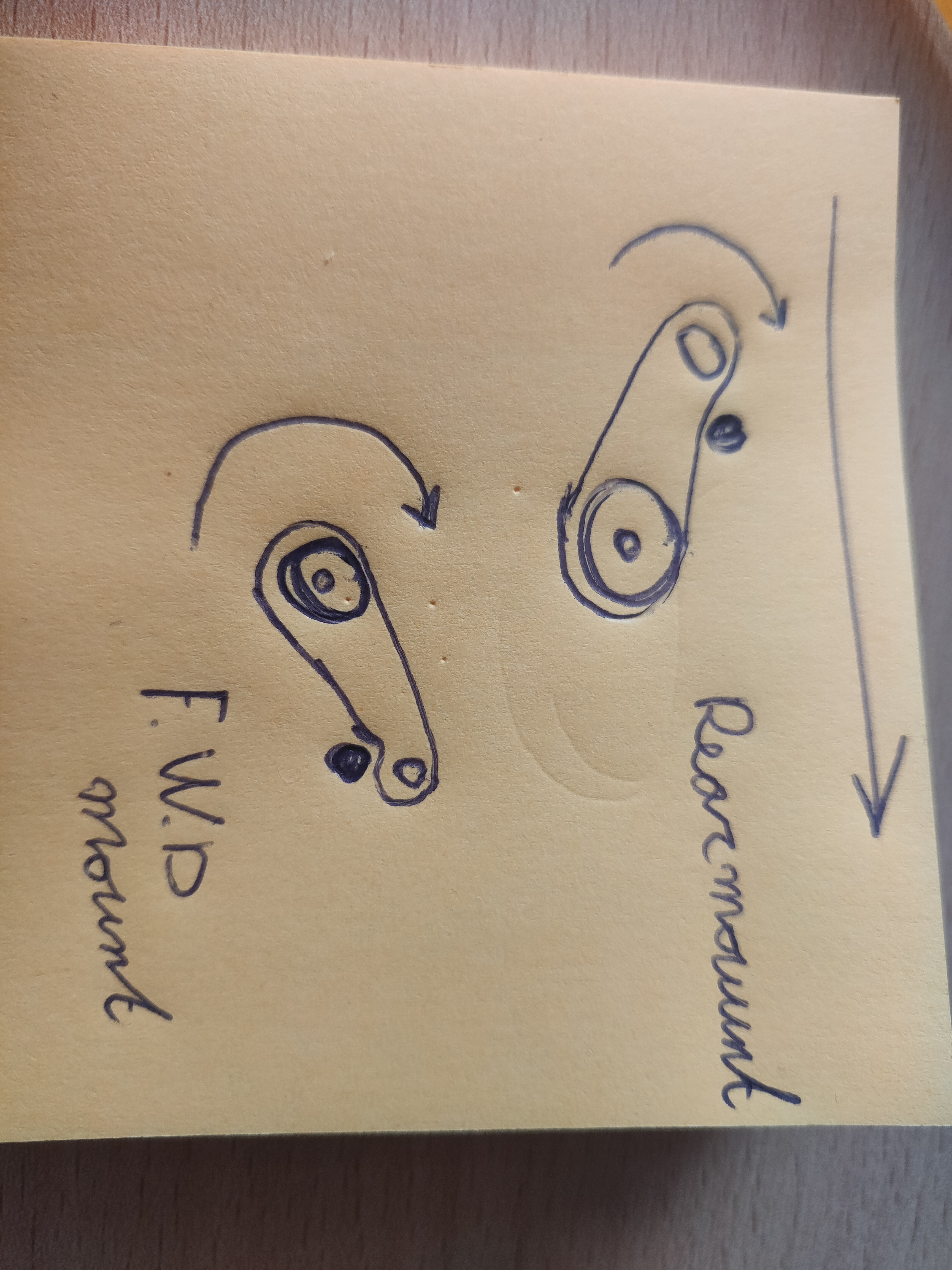

First off its better to move your idler close to the drive pulley, this way more teeth will be engaged with it.
Second i dont know whether your mounts were inward or outward and it was quite hard to make out, prob because im tired af but these positions should be the idler position
Im late probably, but hopefully this helps still.
Yes your photo is correct, I did test ride yesterday, two idlers and 15mm belt, I can brake pretty aggressively now no problem, I still need to test full emergency brakes.
Don’t mind the dirt, it was a little damp on the ride home from work.
